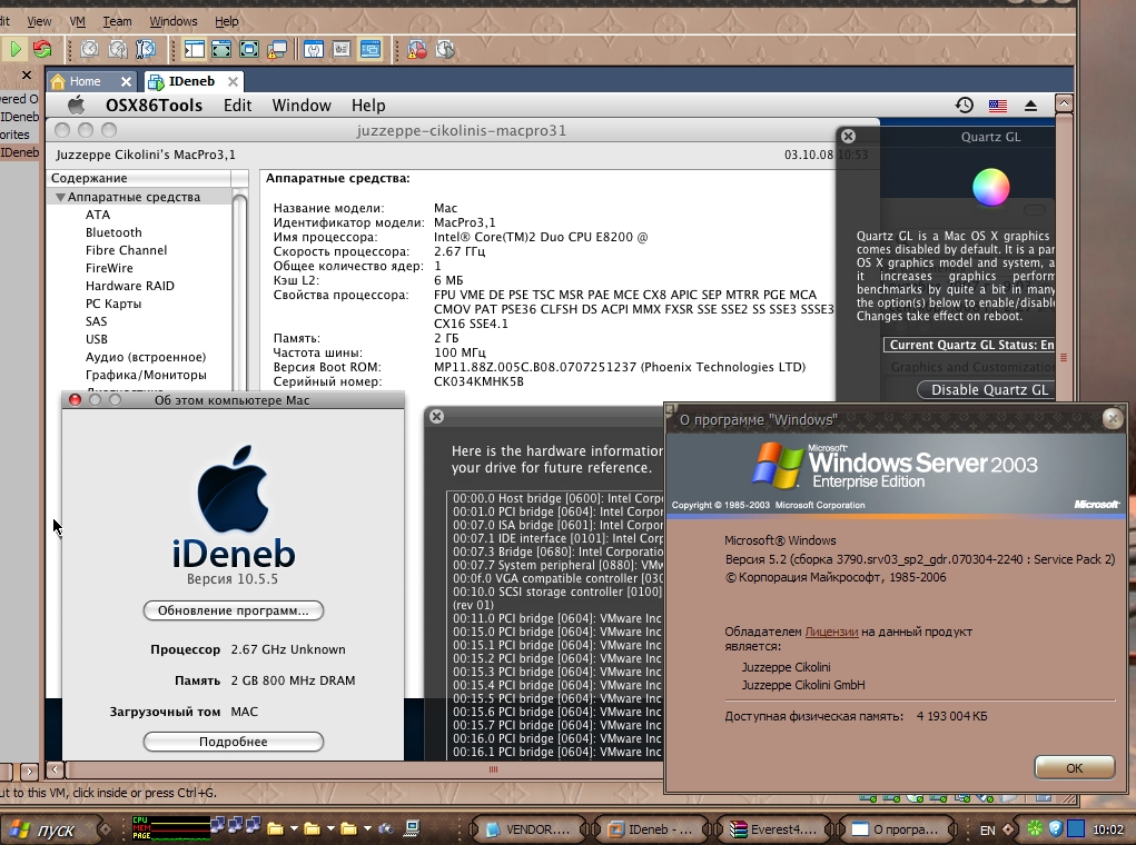

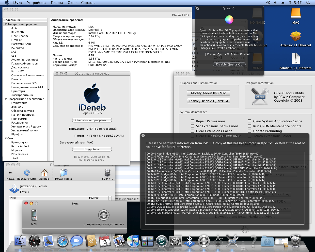

juzzi Posted September 29, 2008 Share Posted September 29, 2008 iDeneb v1.3 10.5.5 for IntelAMD ( SSE2SSE3) (iDeneb)[multi](september 2008) - fork fine, direct boot from native Marvell. After install: [00:00.0 Host bridge [0600]: Intel Corporation Eaglelake DRAM Controller [8086:2e20] (rev 02) 00:01.0 PCI bridge [0604]: Intel Corporation Eaglelake PCI Express Root Port [8086:2e21] (rev 02) 00:1a.0 USB 000:00.0 Host bridge [0600]: Intel Corporation Eaglelake DRAM Controller [8086:2e20] (rev 02) 00:01.0 PCI bridge [0604]: Intel Corporation Eaglelake PCI Express Root Port [8086:2e21] (rev 02) 00:1a.0 USB Controller [0c03]: Intel Corporation 82801JI (ICH10 Family) USB UHCI Controller #4 [8086:3a37] 00:1a.1 USB Controller [0c03]: Intel Corporation 82801JI (ICH10 Family) USB UHCI Controller #5 [8086:3a38] 00:1a.2 USB Controller [0c03]: Intel Corporation 82801JI (ICH10 Family) USB UHCI Controller #6 [8086:3a39] 00:1a.7 USB Controller [0c03]: Intel Corporation 82801JI (ICH10 Family) USB2 EHCI Controller #2 [8086:3a3c] 00:1b.0 Audio device [0403]: Intel Corporation 82801JI (ICH10 Family) HD Audio Controller [8086:3a3e] 00:1c.0 PCI bridge [0604]: Intel Corporation 82801JI (ICH10 Family) PCI Express Port 1 [8086:3a40] 00:1c.4 PCI bridge [0604]: Intel Corporation 82801JI (ICH10 Family) PCI Express Port 5 [8086:3a48] 00:1c.5 PCI bridge [0604]: Intel Corporation 82801JI (ICH10 Family) PCI Express Port 6 [8086:3a4a] 00:1d.0 USB Controller [0c03]: Intel Corporation 82801JI (ICH10 Family) USB UHCI Controller #1 [8086:3a34] 00:1d.1 USB Controller [0c03]: Intel Corporation 82801JI (ICH10 Family) USB UHCI Controller #2 [8086:3a35] 00:1d.2 USB Controller [0c03]: Intel Corporation 82801JI (ICH10 Family) USB UHCI Controller #3 [8086:3a36] 00:1d.7 USB Controller [0c03]: Intel Corporation 82801JI (ICH10 Family) USB2 EHCI Controller #1 [8086:3a3a] 00:1e.0 PCI bridge [0604]: Intel Corporation 82801 PCI Bridge [8086:244e] (rev 90) 00:1f.0 ISA bridge [0601]: Intel Corporation 82801JIR (ICH10R) LPC Interface Controller [8086:3a16] 00:1f.2 SATA controller [0106]: Intel Corporation 82801JI (ICH10 Family) SATA AHCI Controller [8086:3a22] 00:1f.3 SMBus [0c05]: Intel Corporation 82801JI (ICH10 Family) SMBus Controller [8086:3a30] 01:00.0 VGA compatible controller [0300]: nVidia Corporation NV43 [GeForce 6600 GT] [10de:0140] (rev a2) 02:00.0 Ethernet controller [0200]: Attansic Technology Corp. L1 Gigabit Ethernet Adapter [1969:1026] (rev b0) 03:00.0 IDE interface [0101]: Marvell Technology Group Ltd. 88SE6121 SATA II Controller [11ab:6121] (rev b2) Hardware detial: Link to comment Share on other sites More sharing options...

winnimac Posted October 2, 2008 Share Posted October 2, 2008 iDeneb v1.3 10.5.5 for IntelAMD ( SSE2SSE3) (iDeneb)[multi](september 2008) - fork fine, direct boot from native Marvell. After install: [00:00.0 Host bridge [0600]: Intel Corporation Eaglelake DRAM Controller [8086:2e20] (rev 02) 00:01.0 PCI bridge [0604]: Intel Corporation Eaglelake PCI Express Root Port [8086:2e21] (rev 02) 00:1a.0 USB 000:00.0 Host bridge [0600]: Intel Corporation Eaglelake DRAM Controller [8086:2e20] (rev 02) 00:01.0 PCI bridge [0604]: Intel Corporation Eaglelake PCI Express Root Port [8086:2e21] (rev 02) 00:1a.0 USB Controller [0c03]: Intel Corporation 82801JI (ICH10 Family) USB UHCI Controller #4 [8086:3a37] 00:1a.1 USB Controller [0c03]: Intel Corporation 82801JI (ICH10 Family) USB UHCI Controller #5 [8086:3a38] 00:1a.2 USB Controller [0c03]: Intel Corporation 82801JI (ICH10 Family) USB UHCI Controller #6 [8086:3a39] 00:1a.7 USB Controller [0c03]: Intel Corporation 82801JI (ICH10 Family) USB2 EHCI Controller #2 [8086:3a3c] 00:1b.0 Audio device [0403]: Intel Corporation 82801JI (ICH10 Family) HD Audio Controller [8086:3a3e] 00:1c.0 PCI bridge [0604]: Intel Corporation 82801JI (ICH10 Family) PCI Express Port 1 [8086:3a40] 00:1c.4 PCI bridge [0604]: Intel Corporation 82801JI (ICH10 Family) PCI Express Port 5 [8086:3a48] 00:1c.5 PCI bridge [0604]: Intel Corporation 82801JI (ICH10 Family) PCI Express Port 6 [8086:3a4a] 00:1d.0 USB Controller [0c03]: Intel Corporation 82801JI (ICH10 Family) USB UHCI Controller #1 [8086:3a34] 00:1d.1 USB Controller [0c03]: Intel Corporation 82801JI (ICH10 Family) USB UHCI Controller #2 [8086:3a35] 00:1d.2 USB Controller [0c03]: Intel Corporation 82801JI (ICH10 Family) USB UHCI Controller #3 [8086:3a36] 00:1d.7 USB Controller [0c03]: Intel Corporation 82801JI (ICH10 Family) USB2 EHCI Controller #1 [8086:3a3a] 00:1e.0 PCI bridge [0604]: Intel Corporation 82801 PCI Bridge [8086:244e] (rev 90) 00:1f.0 ISA bridge [0601]: Intel Corporation 82801JIR (ICH10R) LPC Interface Controller [8086:3a16] 00:1f.2 SATA controller [0106]: Intel Corporation 82801JI (ICH10 Family) SATA AHCI Controller [8086:3a22] 00:1f.3 SMBus [0c05]: Intel Corporation 82801JI (ICH10 Family) SMBus Controller [8086:3a30] 01:00.0 VGA compatible controller [0300]: nVidia Corporation NV43 [GeForce 6600 GT] [10de:0140] (rev a2) 02:00.0 Ethernet controller [0200]: Attansic Technology Corp. L1 Gigabit Ethernet Adapter [1969:1026] (rev b0) 03:00.0 IDE interface [0101]: Marvell Technology Group Ltd. 88SE6121 SATA II Controller [11ab:6121] (rev b2) Hardware detial: does your marvel 88SE6121 work? and when yes how you do it? Link to comment Share on other sites More sharing options...

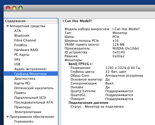

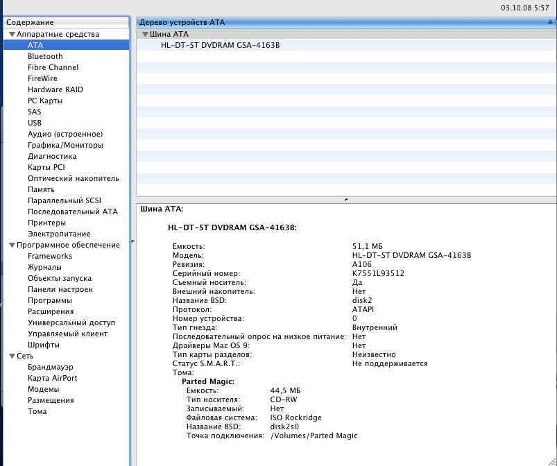

juzzi Posted October 3, 2008 Share Posted October 3, 2008 Not I do it. It does it iDeneb v1.3 10.5.5 for IntelAMD ( SSE2SSE3) (With English and other languages included). The system is established without adapters directly with DVD (with Marvel 88SE6121) - the Marvel chip in BIOS is enabled. All options processor in BIOS are enabled. RAM works on native frequency 1066 Mgz. Installation very simple. If after installation at you: "Do you already own a mac" startup the PC with "F8" ,type "-s" and type /sbin/fsck -fy /sbin/mount -uw / passwd root > tupe your password touch /var/db/.AppleSetupDone reboot My BIOS: AppleBCM5751Ethernet.kext.zip My DVD-RW LG My DVD-RW in Mac after install (full support) My video card ASUS EN6600GT TOP after installation completely works, at the first loading of system shows video "Welcome". I put only one kext at installation iDeneb v1.3 10.5.5 for IntelAMD ( SSE2 SSE3) it last in section "NVidia". My Mac after install: The network does not work for me (see next post) (02:00.0 Ethernet controller [0200]: Attansic Technology Corp. L1 Gigabit Ethernet Adapter [1969:1026] (rev b0)). Speak while there is no driver. Whether the truth it? And I yet did not adjust sound ALC1200 (see next post) (00:1b.0 Audio device [0403]: Intel Corporation 82801JI (ICH10 Family) HD Audio Controller [8086:3a3e]) If someone prompts as it correctly to make, I will be grateful. Also DENEB 10.5.5 perfectly works in VMware Workstation 6.5.118166. (There the network is at once). Also it is possible to mount in a mode read-write any section of a hard disk (including NTFS by means of the program paragon-ntfsmac65: paragon_ntfsmac65.part1.rarparagon_ntfsmac65.part2.rarparagon_ntfsmac65.part3.rar) I have more recently put to myself MAC, but I wish to instal on P5Q PRO Mac OS X Leopard 10.5.4 9E25 Retail.dmg (7.01 Gb) if who that has councils on this theme, I will be very grateful. Here you also can look or help council. Excuse for my bad English, but I from Ukraine. Link to comment Share on other sites More sharing options...
juzzi Posted October 3, 2008 Share Posted October 3, 2008 1) Audio works Thx - Post #27. 2) Network works Thx - Realtek RTL8139D (10 year old) & 3$. details Link to comment Share on other sites More sharing options...
