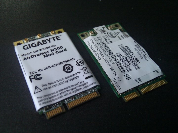

theorie Posted October 1, 2010 Share Posted October 1, 2010 Success story: I used the cooked .29 bios using the OP's instructions. Works great for me. Notebook model: dv6139us Wireless card: Gigabyte AirCruiser N300 Mini (model GN-WS30N-RH) Thanks! Link to comment https://www.insanelymac.com/forum/topic/124283-hp-dv6000-f29-bios-whitelist-patched/page/2/#findComment-1557771 Share on other sites More sharing options...
