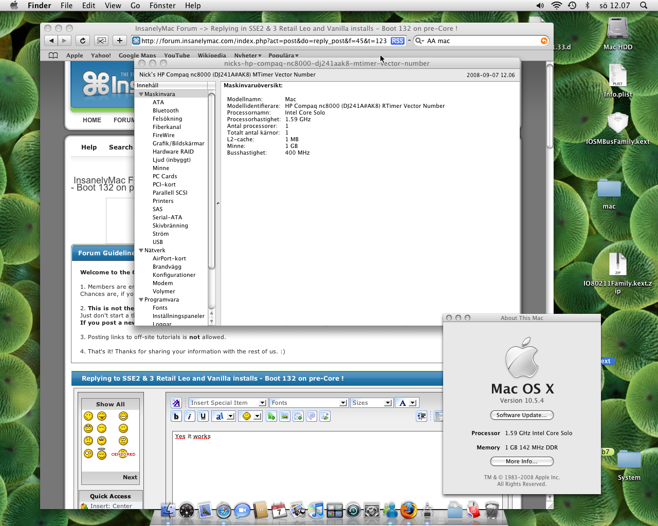

nickhe Posted September 7, 2008 Share Posted September 7, 2008 Yes it works Yes it works Link to comment https://www.insanelymac.com/forum/topic/123841-sse2-3-retail-leo-and-vanilla-installs-boot-132-on-pre-core/page/4/#findComment-882327 Share on other sites More sharing options...
munky Posted September 7, 2008 Author Share Posted September 7, 2008 nickhe : great! and it thinks your celeron is a core solo lol :-) Link to comment https://www.insanelymac.com/forum/topic/123841-sse2-3-retail-leo-and-vanilla-installs-boot-132-on-pre-core/page/4/#findComment-882422 Share on other sites More sharing options...

nickhe Posted September 7, 2008 Share Posted September 7, 2008 nickhe : great! and it thinks your celeron is a core solo lol :-) acually it my Pentium M 1.6ghz thats thinks it's a core solo the celeron was also recongized as core solo but it could use vanillia kext but i gave it away to my aunt she wanted a mac Link to comment https://www.insanelymac.com/forum/topic/123841-sse2-3-retail-leo-and-vanilla-installs-boot-132-on-pre-core/page/4/#findComment-882453 Share on other sites More sharing options...
