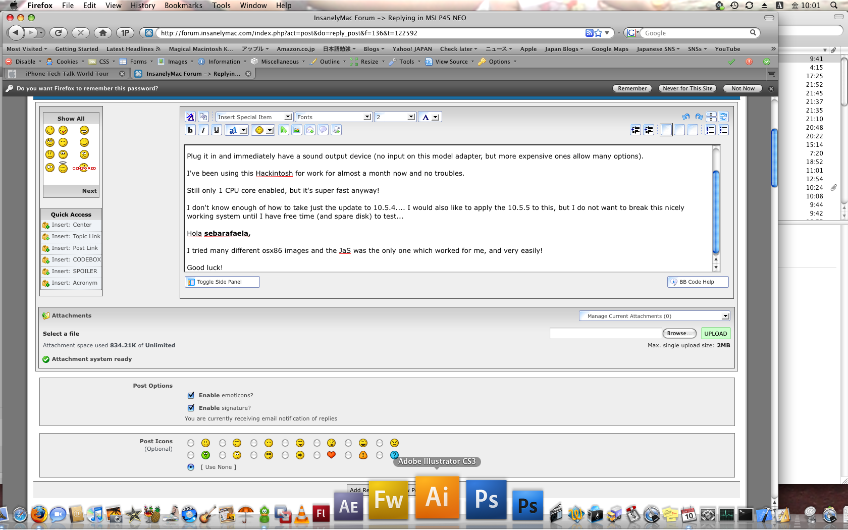

I didn't have time to play with the sound anymore, so I bought a USB sound adapter. Here, in Japan, it is about 1,900 yen (less than US$20).
Plug it in and immediately have a sound output device (no input on this model adapter, but more expensive ones allow many options).
I've been using this Hackintosh for work for almost a month now and no troubles.
Still only 1 CPU core enabled, but it's super fast anyway!
