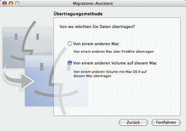

dripple Posted April 9, 2006 Share Posted April 9, 2006 A "USB to Firewire" solution won't work because the system stills "sees" no Firewire-Port. Sorry, but maybe I miss something here. Just plug your current (internal) hard drive to a external USB-enclosure, connect it to your MacBook Pro and and then start the Migration Assistant. It offers you TWO ways of migration: via Firewire OR an different Volume. Just select your external drive. Sorry for the german screenshot, but you'll see the different methods of migration. dripple Link to comment Share on other sites More sharing options...
