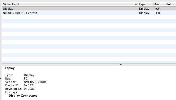

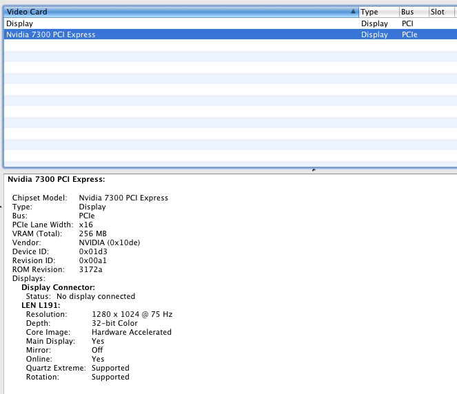

bickyb Posted January 24, 2009 Share Posted January 24, 2009 So it seems I have gotten further. I am able to see my two cards in the system profiler. Unfortunately, my PCI card is listed as 'Display' even though I named it 'NVIDIA GeForce 6200 PCI' in my in.plist file. I am attaching my Plist file and screen shots of what I see in my system profiler. Any help would be much appreciated! plist.txt Link to comment https://www.insanelymac.com/forum/topic/104266-guide-triple-or-quad-monitors-with-two-graphic-cards/page/6/#findComment-1053737 Share on other sites More sharing options...
peach-os Posted January 24, 2009 Author Share Posted January 24, 2009 don´t you have already three monitors connected? it boots - so what happens with the monitors connected to the pci card? tell us more please Link to comment https://www.insanelymac.com/forum/topic/104266-guide-triple-or-quad-monitors-with-two-graphic-cards/page/6/#findComment-1053750 Share on other sites More sharing options...
bickyb Posted January 24, 2009 Share Posted January 24, 2009 Peach, Nope. Unfortunately I have not been able to get an output from both video cards at the same time as of yet... that is my ultimate goal I am trying to troubleshoot this by getting one monitor running on my PCI express card and another running on my PCI card. One thing I noticed is that without the NVinject drivers installed, my card 6200 PCI card can only run 1024x768 running alone. So does that mean that since I cannot use NVinject with GFX, I cannot use this card? Does GFX does not support a GeForce 6200 ? For this 6200 card, under NVInject, Quartz is supported and I can get the resolution I am looking for (running alone). Without NVInject, Quartz is not supported and I can only run 1024x768. Link to comment https://www.insanelymac.com/forum/topic/104266-guide-triple-or-quad-monitors-with-two-graphic-cards/page/6/#findComment-1053771 Share on other sites More sharing options...
peach-os Posted January 24, 2009 Author Share Posted January 24, 2009 if you run this card single with strings and there is no QE/CI support in system profiler shown - no. I would suggest you to upgrade your hardware instead of wasting time Link to comment https://www.insanelymac.com/forum/topic/104266-guide-triple-or-quad-monitors-with-two-graphic-cards/page/6/#findComment-1054033 Share on other sites More sharing options...
bickyb Posted January 24, 2009 Share Posted January 24, 2009 Score!!! I got it working. So I ended up not using the approach outlined in this thread. Rather I ended up using the NVinject dual card kext available at http://nvinject.free.fr/downloads.php I used NVinject.0.2.0_dual_cards.zip With that, I can run my 6200 PCI and my 7200 PCI Express together to run a total of 4 screens. I am able to run quartz as well. In bios I had to choose PCI as my preferred startup device. I am pretty happy about this. Now I just need to get surround sound working and I have the system exactly the way I want it. Link to comment https://www.insanelymac.com/forum/topic/104266-guide-triple-or-quad-monitors-with-two-graphic-cards/page/6/#findComment-1054274 Share on other sites More sharing options...

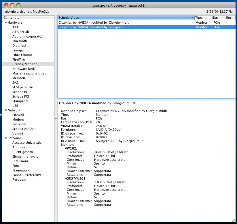

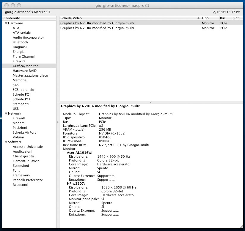

Guest Posted February 28, 2009 Share Posted February 28, 2009 Installing Leopard 10.5.6 on Asus P5N-E SLI: I write this guide as a result of the work I've done in the past 10 days, which kept me very busy, having come into possession of an Asus P5N-E SLI, I have groped to install 2 graphics cards (Nvidia) with 4 monitors with QE / CI enabled on Leopard 10.5.6. The guide is divided into 2 steps: 1) The first concerns the installation of Leopard 10.5.6 on Asus P5N-E SLI, operating at 100%, including audio in/out, LAN and Firewire. (obviously you can adapt to motherboards with the same chipset nForce 650i SLI). 2) The second relates more specifically to the recognition of video cards and activate QE/CI. The second step can also be used by holders of other SLI motherboards, with different chipsets, which have installed a version of Leopard 10.5.6. Also those who have a motherboard with 2 PCI-E slot for graphics cards in crossfire technology, with a version of Leopard 10.5.6 and have the chance to try 2 Nvidia graphics cards, can try Step 2): Any feedback is welcome both positive and negative, because I have not had a chance to do this test. To this end I have modified NVinject 0.2.1 to work as injector for 2 Nvidia Video Cards supported by kexts (drivers) of 10.5.6. The two Video Cards are supported at 256, 512 and 1024 MB of RAM. The 2 video cards should be of the same RAM size (2x256 MB or 2x512 MB etc), because the modified NVinject.kext is not yet able to recognize 2 different sizes of RAM. However, is possible using 2 cards with different size of RAM, it will work with the care to use the NVinject for the greater size of RAM (in System Profiler 2 cards will be viewed with eg 512 MB of RAM, while a one is really 512 and the other eg 256, but will operate normally, the endorsement of the System Profiler is purely aesthetic, I tried with the tests and the 2 cards with different RAM works perfectly). The video card may be the series 7 and 8, I also tried 6600 of the 6 series. The 2 video cards may not be the same (eg 8600GT + 8500GT etc), obviously will not be connected with the SLI bridge. The SLI bridge does not affect the functioning in Leopard (and those who serve on the same Windows or Linux PC and wants to use the SLI). Two words about SLI: the motherboard with SLI have 2 PCI-E slot. These slots, in the configuration with a single video card on board, they are normal PCI slot with 16-Bit Lane. In the configuration with 2 on board video cards, SLI bridge and entered SLI driver loaded (obviously only in Windows and Linux) second card is not seen, while the first is seen as Lane PCI card with a 16-bit and potential theoretical calculation chart twice the single and double RAM. In fact, the graphics computing power is only 50-60% higher than that of the single card for a number of reasons. In the configuration with 2 video cards connected in SLI without drivers (eg always Leopard, Linux and Windows without SLI driver loaded) or not connected in SLI (any OS), the 2 cards are seen as 2 separate cards with PCI Lane 8-bit , each with its own allocation of RAM. What you need: 1) The iso to one of the 3 versions of Leopard 10.5.6 (see Step 1); 2) The compressed folder with everything needed for patch the 3 versions of Leopard for the P5N-E SLI, and patched versions of NVinject kext. Link: http://rapidshare.com/files/199507953/P5N-E_SLI.zip.html 3) Kexthelper7 (present in all three versions of the applications). You can install multiple versions of Leopard. the three I chose are: iPC OSx86 PPF5 final; XxX 10.5.6 and iDeneb 1.4. My BIOS version is: 1101 (work also with 1301) Step 1) Installation of Leopard 10.5.6 on Asus P5N-E SLI IPC OSx86 10.5.6: You can install from DVD IDE or SATA on HD IDE or SATA. Council to start the installation with -v in case of error. Choices to be made during customization: □ iPC OSx86 10.5.6 Base System: all; □ Language: Your language; □ Video Drivers: nothing iPC OSx86 10.5.6 intel AMD SSE2 SSE3: □ Kernels: 9.5.0 Voodoo kernel; □ □ Chipset Drivers: AppleNForce ATA nForce Drivers + JMicronATA for JMicron IDE □ Ethernet Drivers: nForce Ethernet Driver □ Fixes and Patches: Seatbelt.kext 10.5.5 □ Alternate Bootloaders: Chamaleon with SMBIOS/DSDT □ Applications: all. At the end of installation rebot with –v, and enter in Leopard; Open Kexthelper7, and install: AppleSMBIOS.kext, AppleNForceATA.kext. Close Kexthelper7. Install your language package (nothing if your language is English), install ALC883Audio.mpkg and reboot with –v End of Step 1. XxX 10.5.6: You can install from DVD IDE on HD IDE or SATA. Council to start the installation with -v in case of error. Choices to be made during customization: □ Optional Bootloaders: PCEFI_v9.0 □ DSDST Patcher: Yes □ System kexts: □ Essential System Kexts: all □ Optional System Kexts: nothing □ 10.5.5 Kexts: nothing □ Optional Kernel: □ 9.5.0 Voodoo XNU □ Chipset Support: AppleNForceATA Test + JMicron – JMB360 □ Graphics Drivers: nothing □ Audio Drivers: nothing □ Network Drivers: nothing □ PowerManagement: nothing: □ Others: nothing □ Legacy Kexts: nothing □ Tools: all except Soundflower At the end of installation rebot with –v, and enter in Leopard; Open Kexthelper7, and install; seatbelt.kext AppleSMBIOS.kext Close Kexthelper7 Install your language package (nothing if your language is English), ALC883Audio.mpkg (don't reboot) and nForceEthernetDriver.pkg Reboot with –v End of Step 1 iDeneb 1.4: You can install from DVD IDE on HD IDE or SATA. Council to start the installation with -v in case of error. Choices to be made during customization: □ Language: Your language (nothing if your language is English) □ Additional fonts : yes □ X11: yes □ iDeneb Essential System: all □ Patches 10.5.6 Ready: □ Alternate Essentials Patch: nothing □ Audio: nothing □ Chipset: AppleNForceATA Test + JMicronATA □ Kernel: Kernel 9.5.0 Voodoo □ Network: nothing □ Fix: AppleSMBIOS (667 or 800 depends by your RAM) □ System Utilities: nothing □ Video: nothing □ Applications: all □ Netbook: nothing At the end of installation reboot with – s and at the prompt type: mount –uw / <enter> cd /System/Library/Extensions <enter> rm –rf GeForce.kext <enter> rm –rf NVDAResman.kext <enter> rm –rf NVDANV50Hal.kext <enter> reboot <enter> and reboot with –v enter in Leopard and: Open Kexthelper7, and install: GeForce.kext NVDAResman.kext NVDANV50Hal.kext seatbelt.kext AppleDecrypt.kext Close Kexthelper7 (don't reboot) Install ALC883Audio.mpkg (don't reboot) and nForceEthernetDriver Reboot with –v End of Step 1. Step 2) At this point, from one of the 3 versions installed on P5N-E SLI or from any other 10.5.6 version on any motherboard SLI: For those who have not used the Step 1) and comes to Step 2) from another installation: delete any Efistring in com.apple.Boot.plist and make sure that you have not Nvinject.kext, NVKush.kext, NVDarwin.kext injector or any other (in this case move it to trash) For everyone: Open Kexthelper7 and install NVinject.kext with the RAM you want from one of the folders in the downloaded compressed file, reboot with- v – f and you have 2 cards running with 4 monitors and QE / CI enabled. Any feedback or your experience is welcome If don't works, send me your bios settings, sometimes the problem is in the bios settings. Giorgio Link to comment https://www.insanelymac.com/forum/topic/104266-guide-triple-or-quad-monitors-with-two-graphic-cards/page/6/#findComment-1093877 Share on other sites More sharing options...
