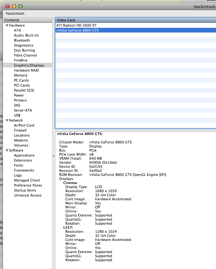

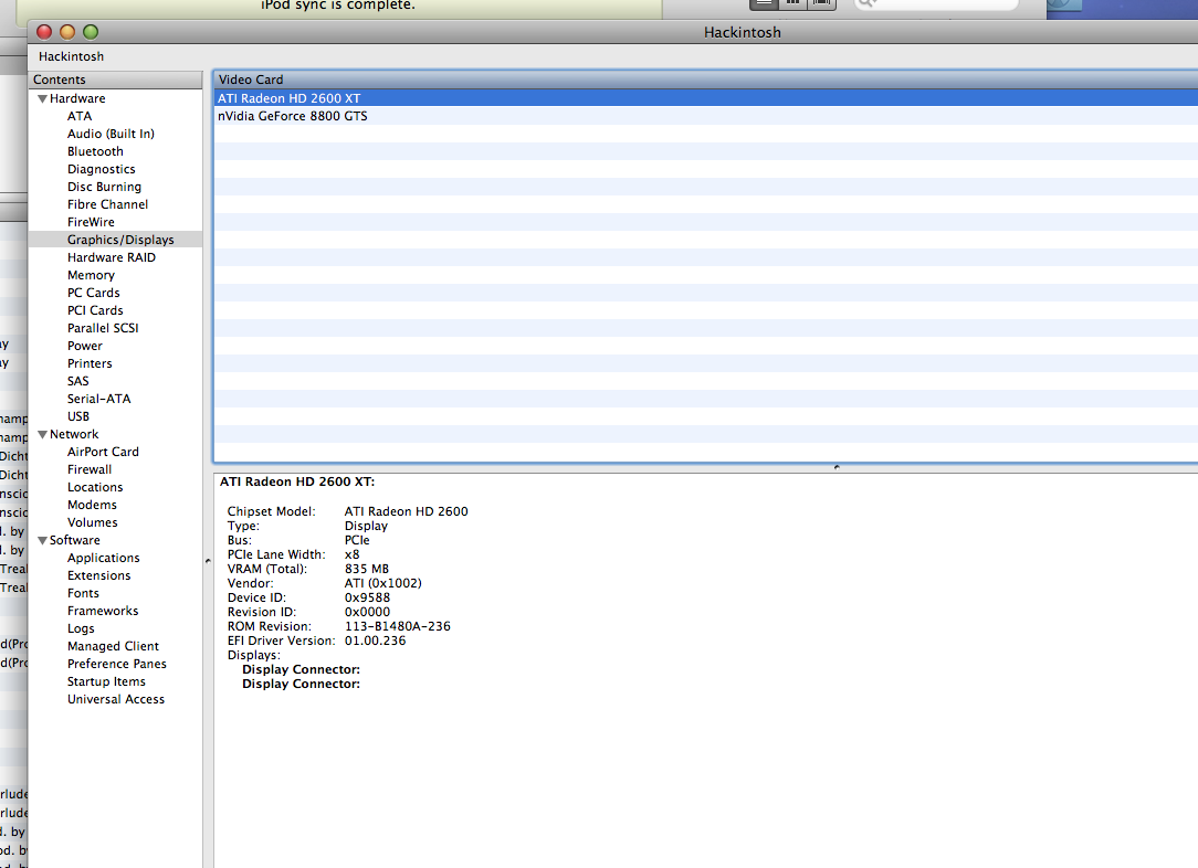

986 Posted December 15, 2008 Share Posted December 15, 2008 pics, and by the way just updated to 10 5 6 Link to comment https://www.insanelymac.com/forum/topic/104266-guide-triple-or-quad-monitors-with-two-graphic-cards/page/3/#findComment-999895 Share on other sites More sharing options...

peach-os Posted December 16, 2008 Author Share Posted December 16, 2008 pics, and by the way just updated to 10 5 6 does that mean you´ve got it working except QE/CI with the ATI card? Hi there,I've just downloaded and installed the Leopard Graphics Update, but no success. The system doesn't boot anymore... I got stuck on a kind of a "loop" between the blue screen and the darwin's black screen with some errors (very fast, I can't read them). Well, I'm now formating and installing Leo4allv3 10.5.2 again... maybe I should install this Leopard Graphics Update using only one video card (instead of my two 8600GTS) and just AFTER the update try your GFX strings method??? Any ideas?? Thanks for the help, again And I'm waiting you here in Brazil for a couple of caipirinhas!! this won´t matter. there won´t be any difference. do a retail install and you will be lucky Link to comment https://www.insanelymac.com/forum/topic/104266-guide-triple-or-quad-monitors-with-two-graphic-cards/page/3/#findComment-1000441 Share on other sites More sharing options...

986 Posted December 16, 2008 Share Posted December 16, 2008 well in single mode i get the ati to work perfect with ATI Radeon HD - 10.5.x - 10.5.5 kexts. no luck with both cards. and peach what are your bios settings for voltage in the jumpfreesection, you are using fsb 800 right? Link to comment https://www.insanelymac.com/forum/topic/104266-guide-triple-or-quad-monitors-with-two-graphic-cards/page/3/#findComment-1000638 Share on other sites More sharing options...
peach-os Posted December 16, 2008 Author Share Posted December 16, 2008 have a look in my daw guide - there are some settings http://forum.insanelymac.com/index.php?act...&pid=940826 yes -I guess the ATI is the one causing problems. does it work with strings when installed single? on my thumbdrive install I could get two 7300GT´s working without strings. used only nvinject....spooky Link to comment https://www.insanelymac.com/forum/topic/104266-guide-triple-or-quad-monitors-with-two-graphic-cards/page/3/#findComment-1000643 Share on other sites More sharing options...
