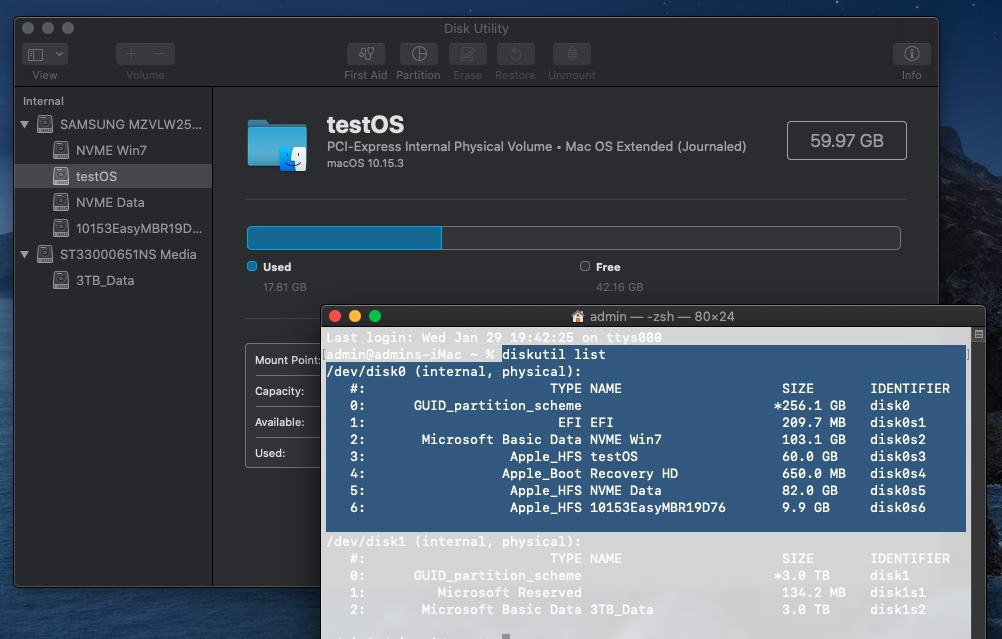

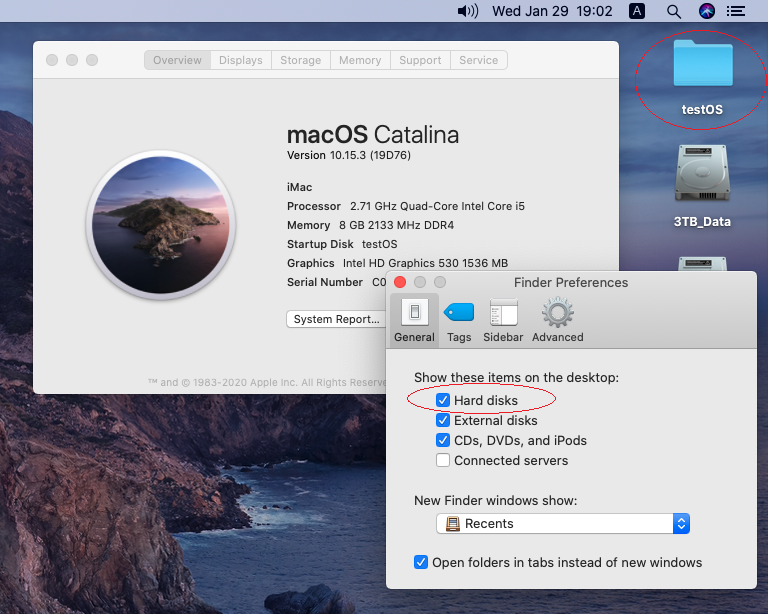

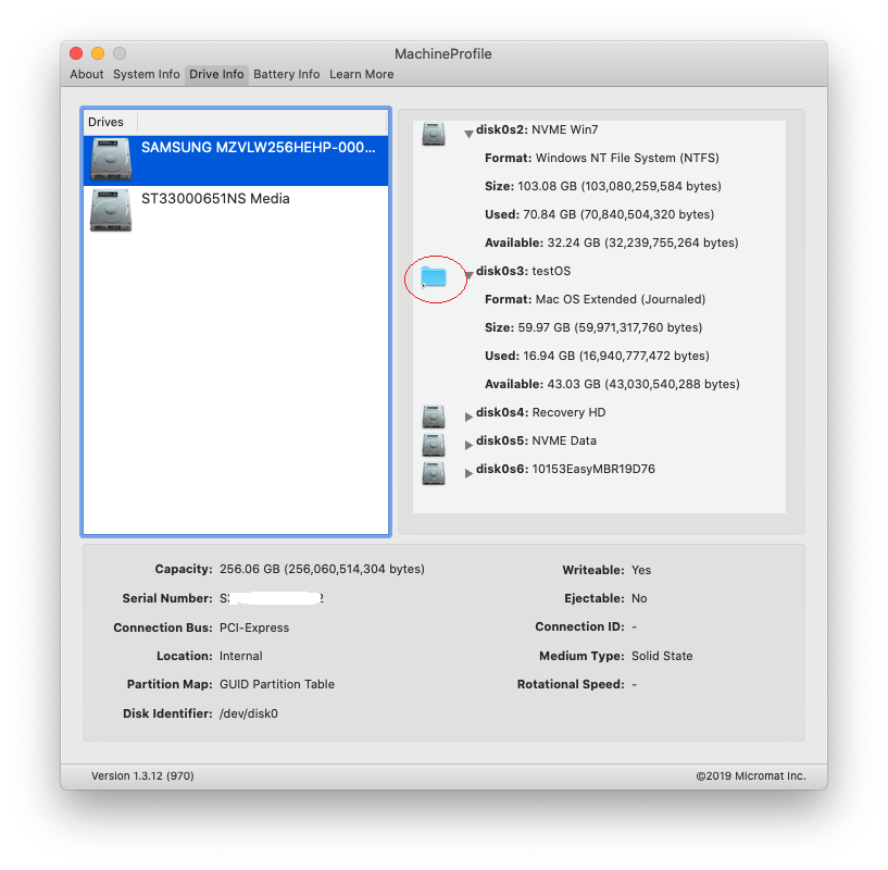

Patched OSInstaller.framework to allow macOS 10.15 installation on MBR HFS+ partition.
Please read Readme-10.15.pdf first.
How to finish the Catalina installation.
1. Use EasyMBR-Installer1015 to make USB Catalina Installer.
2. Boot to USB Catalina Installer, open Utilities -> Disk Utility, format as MBR HFS+.
    Install Catalina to blank MBR HFS+ "Target" partition.
3. Boot to USB Catalina Installer, open Utilities -> Terminal, run the script command:
    copytempdata
4. Boot to "Target" MBR HFS+ partition on single user mode (-s), run the script command:
    hfsupdatecache
5. Reboot to "Target" MBR HFS+ partition, setup user name and login, finish the installation.

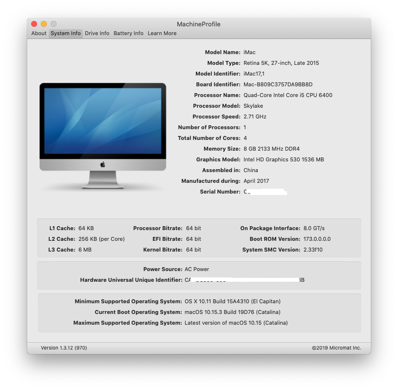

Hi, crazybirdy:
    Thanks a lot for your great job!
    macOS Catalina 10.15.3 19D76 test passed on my hackintosh build: i5-6400 + MSI B250M G1 Gamer + Samsumg PM951 256G m.2 SSD !  Intel HD530 Graphic , ALC892 audio, Realtek8111 ethernet works fine, except sleep wake.   But there is a bug, the icon of my system volume (testOS) is a folder icon. It takes long time before get into desktop for the first time.
Edited by SUN_sw1
