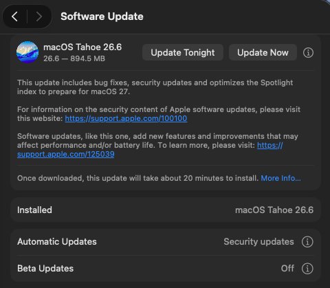

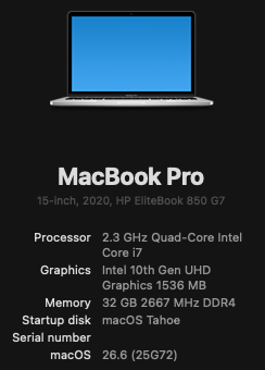

Easy incremental update to macOS Tahoe 26.6 (25G72). Note that Beta updates must be Off to receive this update. My system details are as follows: HP EliteBook 850 G7 Laptop (i7-10610u, 10th Gen UHD Graphics) Open Core 1.0.7 SIP csr-active-config = <01000000> (allow untrusted kexts) Wi-Fi: Intel itlwm / heliport Audio: VoodooHDA.kext 3.6.4 No root patches
