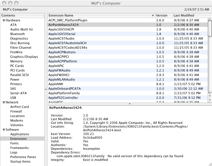

valamyr_sc Posted February 23, 2007 Share Posted February 23, 2007 Hi! I followed your tutorial but got an error after loading AirportAtheros5424.kext. Airportatheros5424: Dependencies: Incomplete Dependency Errors: com.apple.iokit.IO80211Family: No valid version of this dependency can be found Any clue? Link to comment Share on other sites More sharing options...
.marius Posted February 23, 2007 Share Posted February 23, 2007 Hi! I followed your tutorial but got an error after loading AirportAtheros5424.kext. Airportatheros5424: Dependencies: Incomplete Dependency Errors: com.apple.iokit.IO80211Family: No valid version of this dependency can be found Any clue? Hello, If your installation was the same as mine (more or less) have the files you need at hand, and just try it again, step by step, be careful not to miss anything. Good luck, .marius http://www.wirelessisfun.com Link to comment Share on other sites More sharing options...

valamyr_sc Posted February 24, 2007 Share Posted February 24, 2007 (edited) Here are some details on what is occuring: I used IO80211Family.kext from the 10.4.5 update downloaded from apple web site and replaced the one in Extensions folder as described in this post. As my buit in Ethernet card is recognized as en0 there should be no need to modify the NetworkInterfaces.plist file. The kextload command was successful but when I check the extension status in system profiler here is what I get: here is also IO80211family extension status: The image is on ThePirateBay named OSX 1048 AMD Final posted by Tubgirl. Let me know if you need any other info and thanks a lot for your help and time Edited February 24, 2007 by valamyr_sc Link to comment Share on other sites More sharing options...

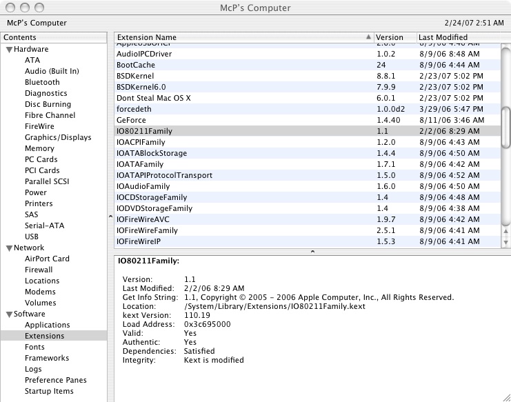

ergosteur Posted February 24, 2007 Share Posted February 24, 2007 (edited) Oddly enough, my AirPortAtheros5424 kext has more failed dependencies than yours: the IO80211Family on my pc is identical version and date to yours. it seems that my iopcifamily is also modified, so i've included a shot and zip of mine. IOPCIFamily.kext.zip hope it helps. Edited February 24, 2007 by matt-hieu ergosteur Link to comment Share on other sites More sharing options...
valamyr_sc Posted February 24, 2007 Share Posted February 24, 2007 (edited) Thanks for your quick answer. I used your IOPCIfamily.kext without any good result and I have now the same dependencies errors as you for AirportAtheros5424.kext. Still working on it Btw what is your Apple80211 Framework version? mine is 4.3.2 Edited February 24, 2007 by valamyr_sc Link to comment Share on other sites More sharing options...
