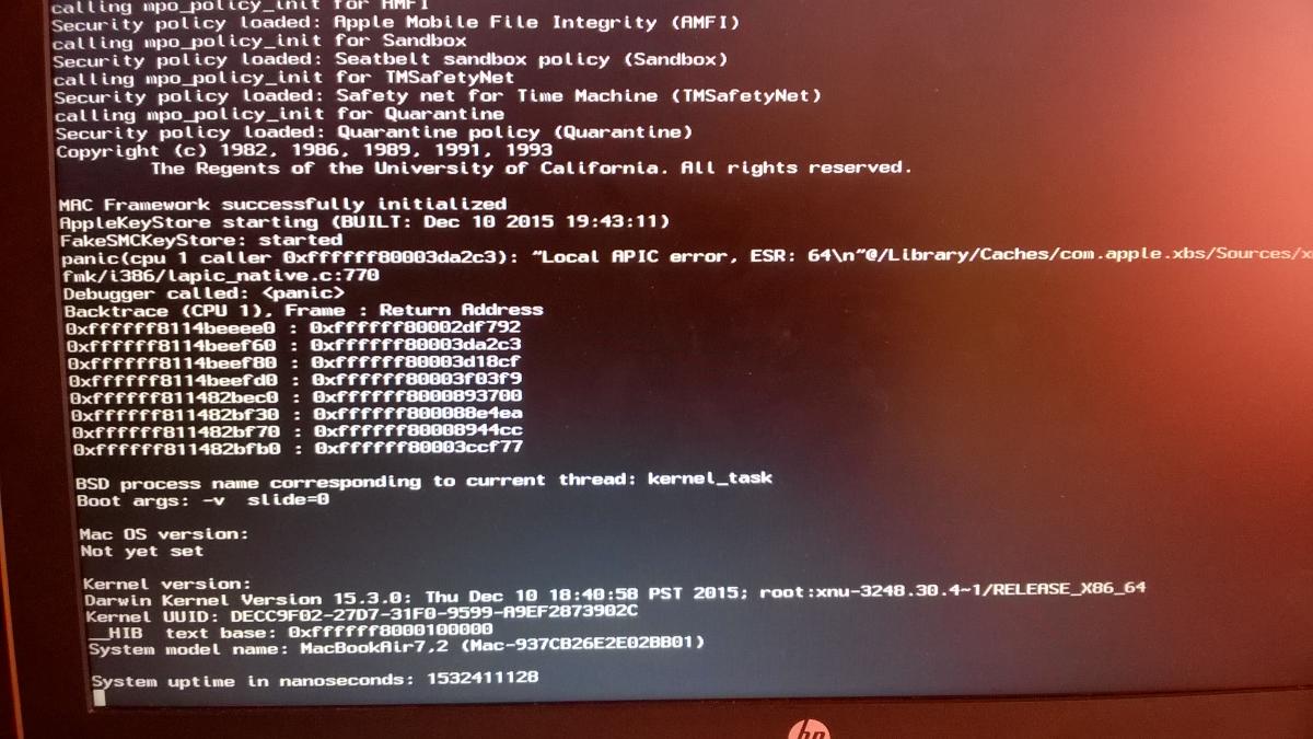

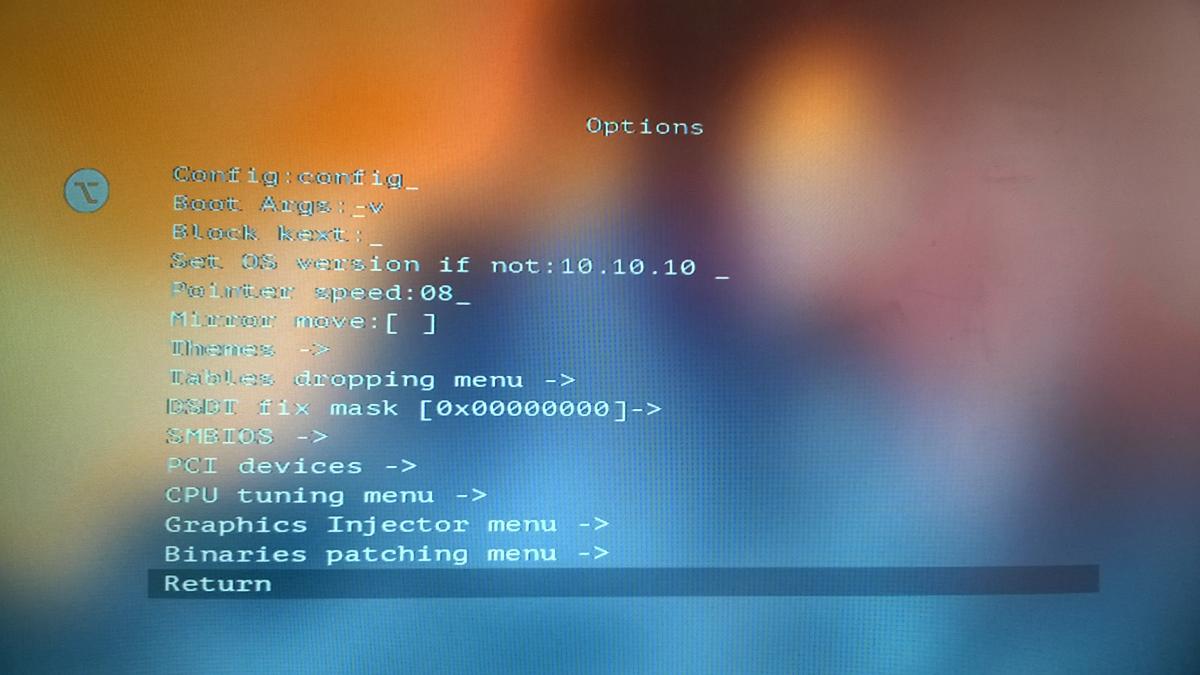

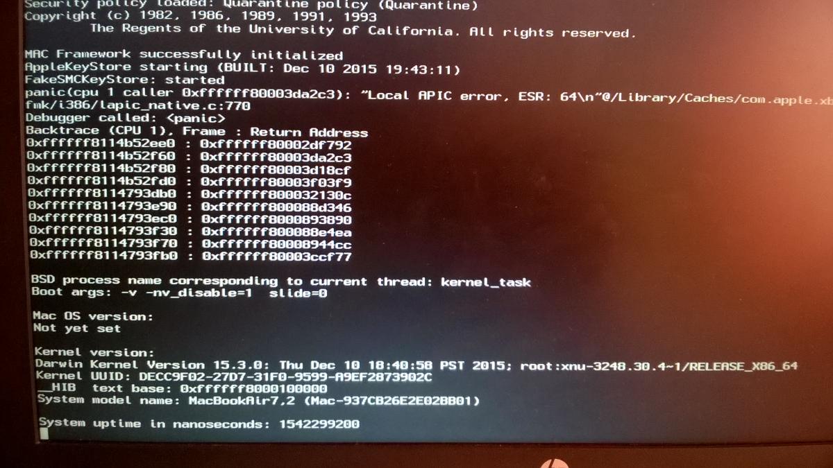

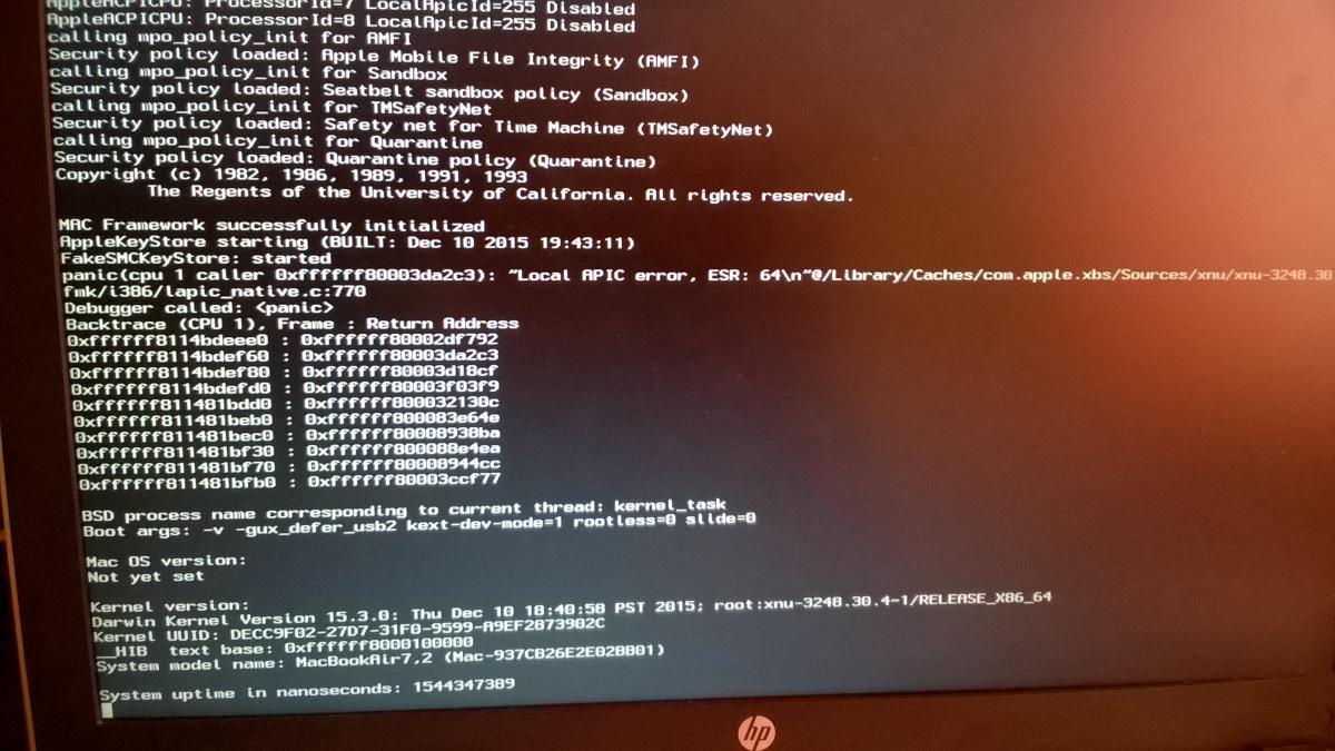

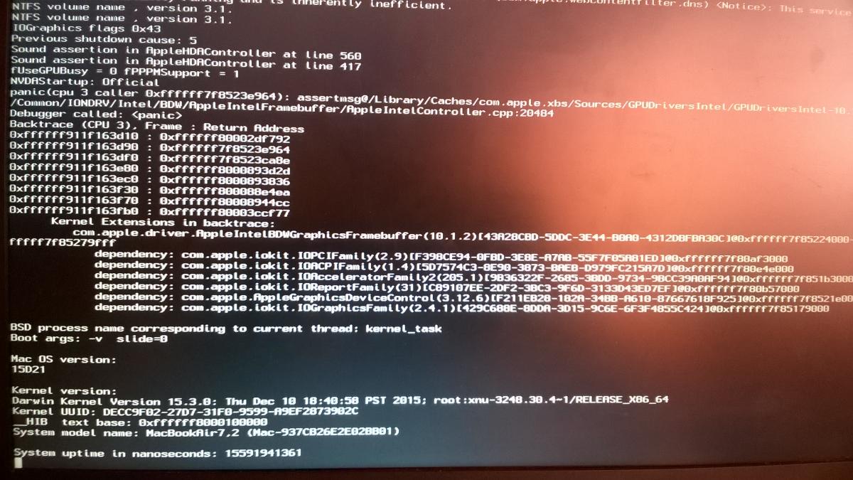

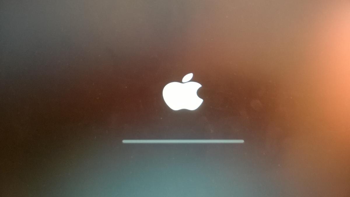

BinGBG Posted March 19, 2016 Share Posted March 19, 2016 Hello all So I've been trying to install El Capitan on my HP Pavilion 15-ab011nu for some time but the most far I've gone is the Apple logo and it seems that I can't pass by it, so I thought to ask for some help. I've created my bootable USB using this method - http://www.insanelymac.com/forum/topic/307003-clover-os-x-el-capitan-usb/ in VirtualBox running El Capitan. I've tried -v but only I got to the Apple logo with nv_disable=1. Here are my specifications: Intel Core i5-5200U with Intel HD Graphics 5500 /Broadwell-U/ NVIDIA GeForce 940M Laptop - http://support.hp.com/hr-en/document/c04741682 And here are my screens with the boots I tried: and with nv_disable=1 Link to comment Share on other sites More sharing options...
artur_pt Posted March 19, 2016 Share Posted March 19, 2016 hello enable lapic fix in clover KernelAndKextPatches good hack Link to comment Share on other sites More sharing options...

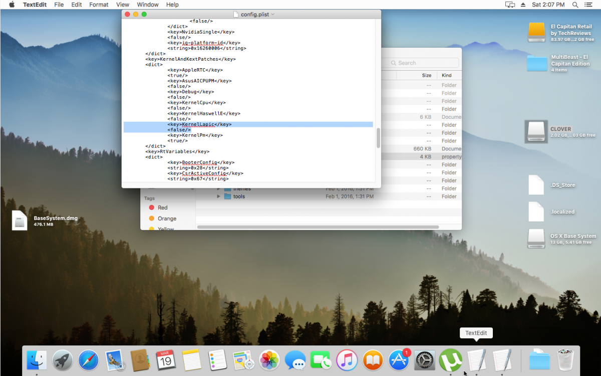

BinGBG Posted March 19, 2016 Author Share Posted March 19, 2016 hi I had it already in my config Link to comment Share on other sites More sharing options...
RehabMan Posted March 19, 2016 Share Posted March 19, 2016 hi I had it already in my config Screenshot (283).png Never use a text editor to edit config.plist. Also, note that your image shows it set 'false'! 1 Link to comment Share on other sites More sharing options...
BinGBG Posted March 19, 2016 Author Share Posted March 19, 2016 I put it on true but it sill doesn't work here is the config config.rar Link to comment Share on other sites More sharing options...

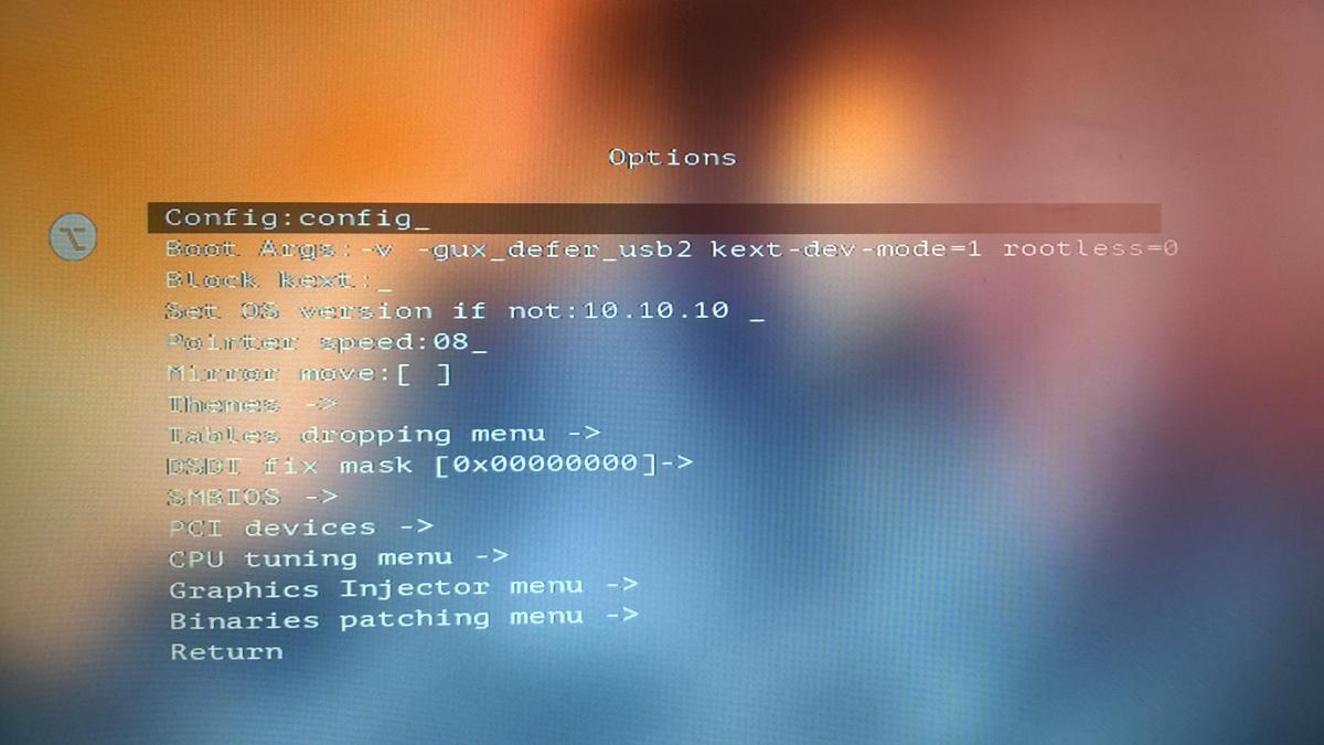

RehabMan Posted March 19, 2016 Share Posted March 19, 2016 I put it on true but it sill doesn't work here is the config config.rar The photos in post #1 do not correlate with this config.plist. If you were using that config.plist, the kernel flags in Boot/Arguments would show in the panic (-v -gux_defer_usb2 kext-dev-mode=1 rootless=0). Make sure you're booting from the EFI/Clover you think you are... Link to comment Share on other sites More sharing options...
BinGBG Posted March 19, 2016 Author Share Posted March 19, 2016 I do boot from the same config file, I just tried changing the boot arguments to try to run it but had no luck Link to comment Share on other sites More sharing options...
RehabMan Posted March 19, 2016 Share Posted March 19, 2016 I do boot from the same config file, I just tried changing the boot arguments to try to run it but had no luck You need to provided updated photo and files. Link to comment Share on other sites More sharing options...

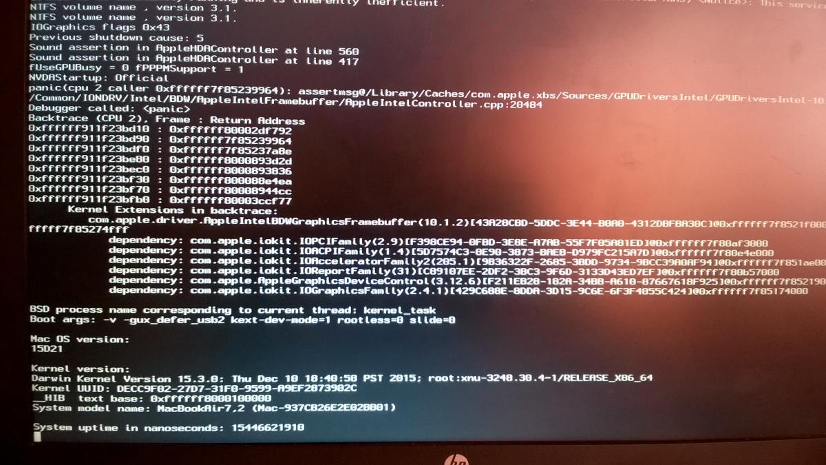

BinGBG Posted March 20, 2016 Author Share Posted March 20, 2016 config.rar Link to comment Share on other sites More sharing options...
RehabMan Posted March 20, 2016 Share Posted March 20, 2016 It is a different panic entirely (no longer a "lapic panic"). Your problem is Broadwell graphics. You need to set DVMT-prealloc to 64mb (BIOS option, google for procedures). Link to comment Share on other sites More sharing options...
