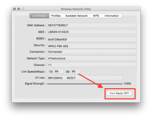

I've been testing El Capitan with two different wifi USB adapters (RTL8192CU and RT2870 chipset). Both of them do work, but both of them break sleep.
If I don't use those adapters (or if I turn the radio off - picture related), sleep works normally. Anybody have any idea on how to fix this?

I found working solution.
Show package content of Wireless Network Utility.app and look for file c4e984143a23rfoff.rtl
Content of this file is 1 (radio off) or 0 (radio on).
You need relaunch Wireless Network Utility.app after change the content of c4e984143a23rfoff.rtl
For automatization these changes use SleepWatcher, I followed install instruction on http://tyhoffman.com/blog/2013/09/sleepwatcher-power-event-driven-automation/
After install SleepWatcher, edit rc.sleep and rc.wakeup files at "etc" folder.
Content of rc.sleep:
#!/bin/sh
osascript -e 'quit app "Wireless Network Utility"'
echo "1" > /Applications/Wireless\ Network\ Utility.app/c4e984143a23rfoff.rtl
open -a "Wireless Network Utility"
Content of rc.wakeup:
#!/bin/sh
echo "0" > /Applications/Wireless\ Network\ Utility.app/c4e984143a23rfoff.rtl

Simply run script from http://tyhoffman.com/blog/2013/09/sleepwatcher-power-event-driven-automation/(or paste commands to terminal). SleepWatch will be installed. After installation you must edit  /etc/rc.wakeup and /etc/rc.sleep
And Wireless Network Utility.app -> Wireless Network Utility.app.zip

This worked great.... with a few modifications....
The file /Applications/Wireless\ Network\ Utility.app/c4e984143a23rfoff.rtl is unique to you......
c4e984143a23 is the MAC address of your wifi card.
To find the file you need to specify type:
cd /Applications/Wireless\ Network\ Utility.app/
ls *rfoff.rtl
You then need to replace the following lines in the rc.sleep and rc.wakeup scripts with your specific file based on your MAC address
echo "1" > /Applications/Wireless\ Network\ Utility.app/YOUR_MAC_ADDRESSrfoff.rtl
You will also need to change the file permissions with (I think this is required??)
sudo chmod 777 /Applications/Wireless\ Network\ Utility.app/YOUR_MAC_ADDRESSrfoff.rtl
Hope this helps someone....... would be nice to have fully working drivers though!!

I would do the following to trouble-shoot
1) Remove the contents of /etc/rc.sleep
2) Switch off the radio manually (using Wireless Network utility)
3) Quit Wireless Network Utility (make sure you quit using the menu rather than just press the red 'x')
4) Try putting your computer to sleep
Does your computer crash when sleeping?
When your computer resumes from sleep does Wireless Network Utility restart automatically? Does the radio switch on automatically? (this implies that your rc.wakeup script is executed correctly)
You can try executing the individual lines of the rc.sleep and rc.wakeup using Terminal (remember to put 'sudu' without quotes before each line).... this may tell you if/what any problems are
