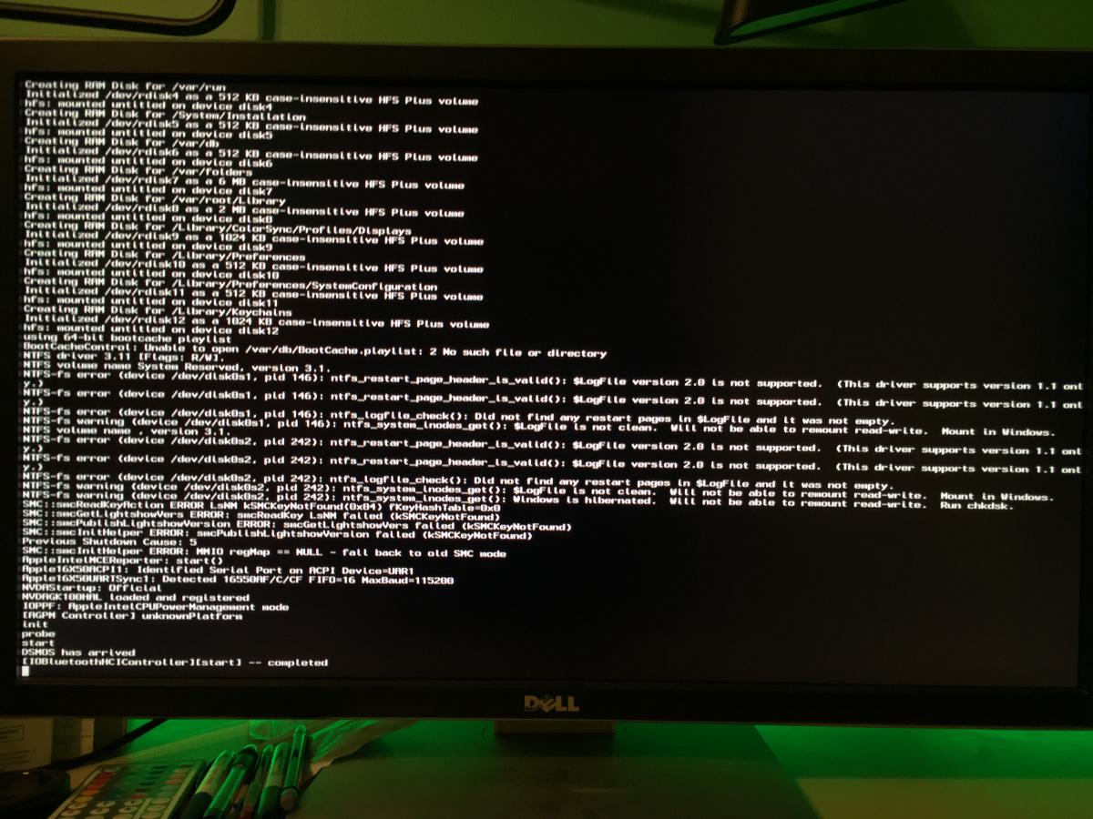

When I boot using verbose and it starts to load it pauses at a line that says:
bootcache control unable to open
and continues, and then later goes to a black screen quickly after showing this line:
IObluetoothHCIcontroller -completed
I have used "-v cpus=1 npci=0x2000 IGPEnabler=No" to boot and a combination of other flags but am still stuck.
Note: whenever I try to boot into safemode using -x it just restarts my machine.
Here is a screenshot of exactly what is being showed before it turns off.

Well it got farther this time!
Now it is stuck at "Missing Bluetooth Controller Transport", but at least it's not going to a black screen!

Alright so it's installed and working 99.999% perfectly.
I ended up just using RampageDev's guide on installing using myHack and then used
-v -f cpus=1 npci=0x2000 nv_disable=1
