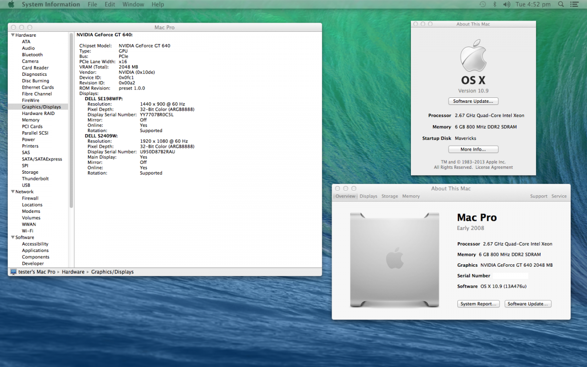

After a bit of mucking around I've managed to get Mavericks booting on my Gigabyte GA-P35-DS3P.
Steps:
  1. Create USB like this: http://www.insanelym...-install-guide/
  2. Copy /Extra onto USB
  3. Copy FakeSMC.kext and any other kexts into /System/Library/Extensions on USB
  4. Make sure you have the latest Chameleon as your boot loader (either on USB or on your current system)
  5. Boot from USB (either from BIOS or from Chameleon on one of your current systems)
  6. Install
  7. At Restart prompt start Terminal from the Utilities menu
  8. Copy FakeSMC.kext and any other from /System/Library/Extensions to /Volumes/<Name of your install volume>/System/Library/Extensions
  9. Quit terminal
  10. Reboot
Kexts Required:
  1. FakeSMC.kext
  2. RealtekRTL81xx.kext (lnx2mac's Realtek NIC kext)
Everything is working at the moment except for the built in ALC889a HDA.  The DSDT is patched but I usually need to patch the AppleHDA.kext to get it working.  That's next on the list.
Attached is the DSDT I am using.
System spec:
  • Gigabyte GA-P35-DS3P V1.1
  • Intel Q6700 Quad Core @ 2.67Ghz w/ 6GB RAM
  • NVidia GT640 2GB VRAM
