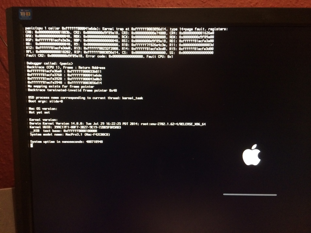

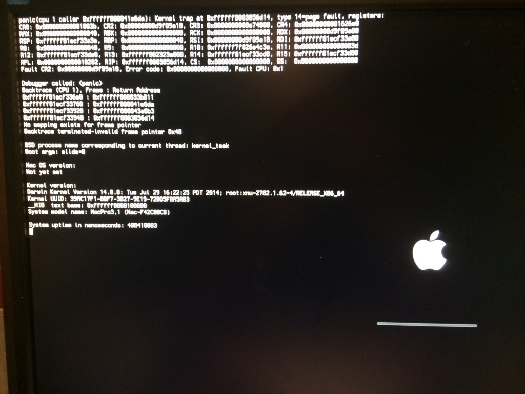

I have try your BIOS but i have KernelPanic.
I insert all Ozmosis files and FakeSMC. The AmiBoardInfo is untouched from me.
The Kernel Panic Pic
