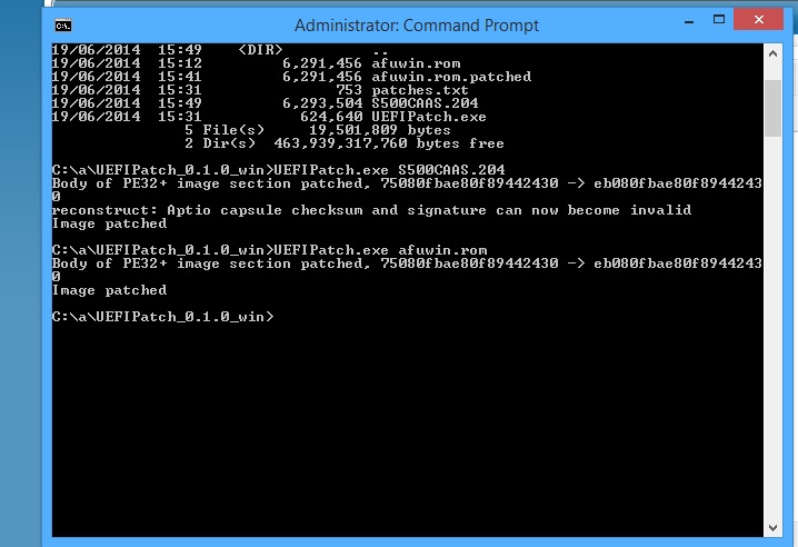

S500CASS.204 is the BIOS download from ASUS SUPPORT.
reconstruct: Aptio capsule checksum and signature can now become invalid
afuwin.rom is the BIOS i extract with Afuwin.
Image patched.
Asus S500CA bios: http://dlcdnet.asus.com/pub/ASUS/nb/S500CA/S500CAAS204.zip

You need to flash S500CASS.204.patched file with AFU /GAN (it still has capsule header from original file).
