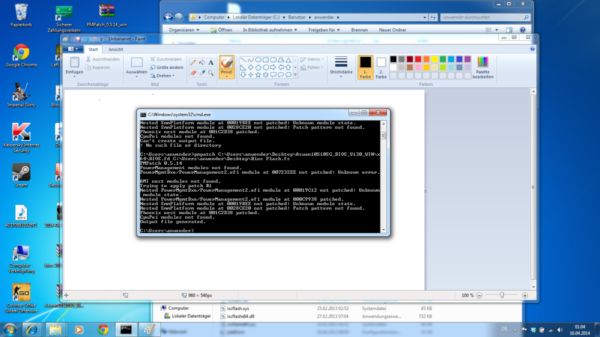

Thank you for your reply, very kind of you. I tried PMPatch already but this is the message I get :
PowerManagement module at 006cb690 not patched : Patch pattern not found.
PowerMgmtDxe/PowerManagement2.efi modules not found.
AMI nest modules not found.
Phoenix nets modules not found.
CpuPei module at 007c72b0 not patched: Patch pattern not found.
My firmware is AptioV I believe from AMI, I know the board isn't the standard one since the Z9PE-D8 WS is a dual Xeon CPU board. I know it's MSR 0xE2 locked since the Asus guy confirmed that.

I also noticed that I was also getting the same error the above poster was when trying to use PMPatch within Windows to patch my own bios. The method I was doing, was probably incorrect.
@terrybogard21:
I don't see any error. If you mean hih64's screenshot, the output is fine as stated in the first post.
