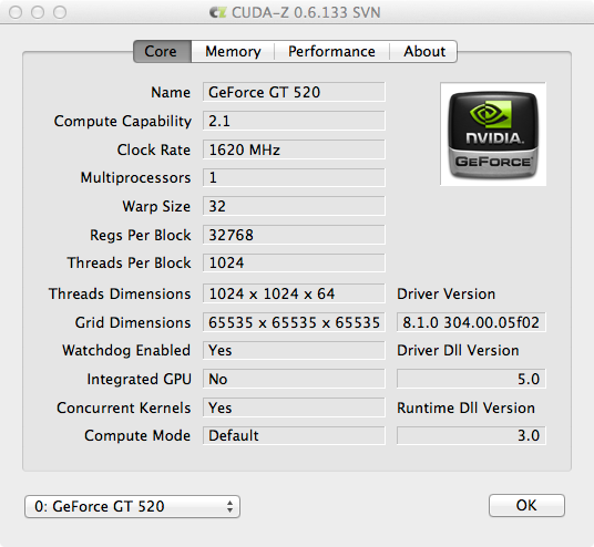

just confirming....drivers updated and opencl fix applied...all good except need to update cuda..."The CUDA Driver currently installed on your system needs to be updated. Please update to the latest CUDA Driver to ensure your CUDA-enabled applications continue to function properly." download cuda... http://www.nvidia.co...mac-driver.html
...from CUDA-Z...

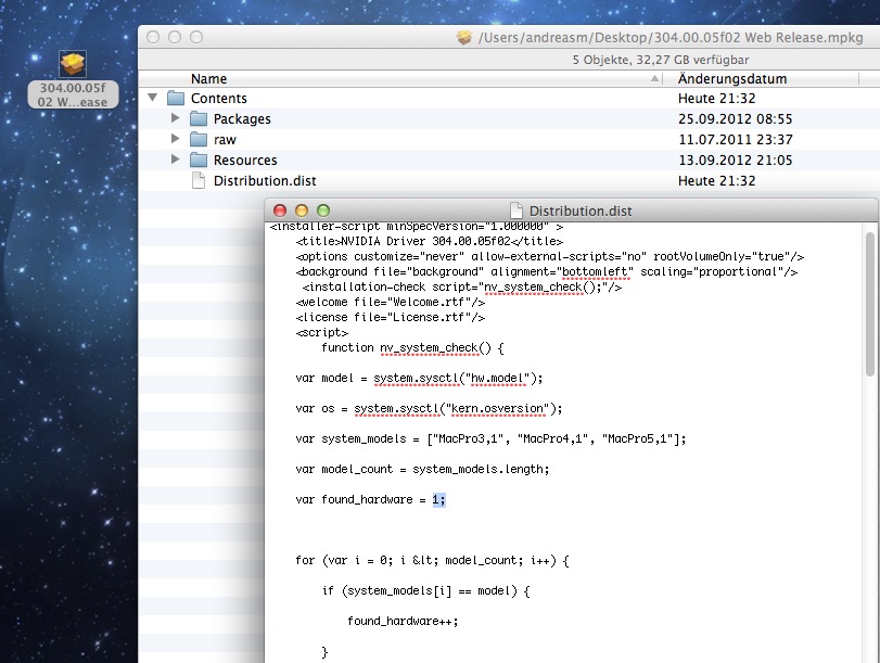

HOW TO INSTALL ON NON MACPRO Modells:
1. Copy the nvidia install .pkg somewhere (desktop)
2. Show packadge contents in finder on .pkg
3. look after the .dist file
4. Open (drag & Drop) .dist with texteditor
5. change var found_hardware = 0 into =1
6 save .dist
7 Happy installing ( i use iMac11,1 - no problem after changing that var above :) )
PS: Sometimes in the past i had problems if i used pacifist with that nvidia .pkg.
