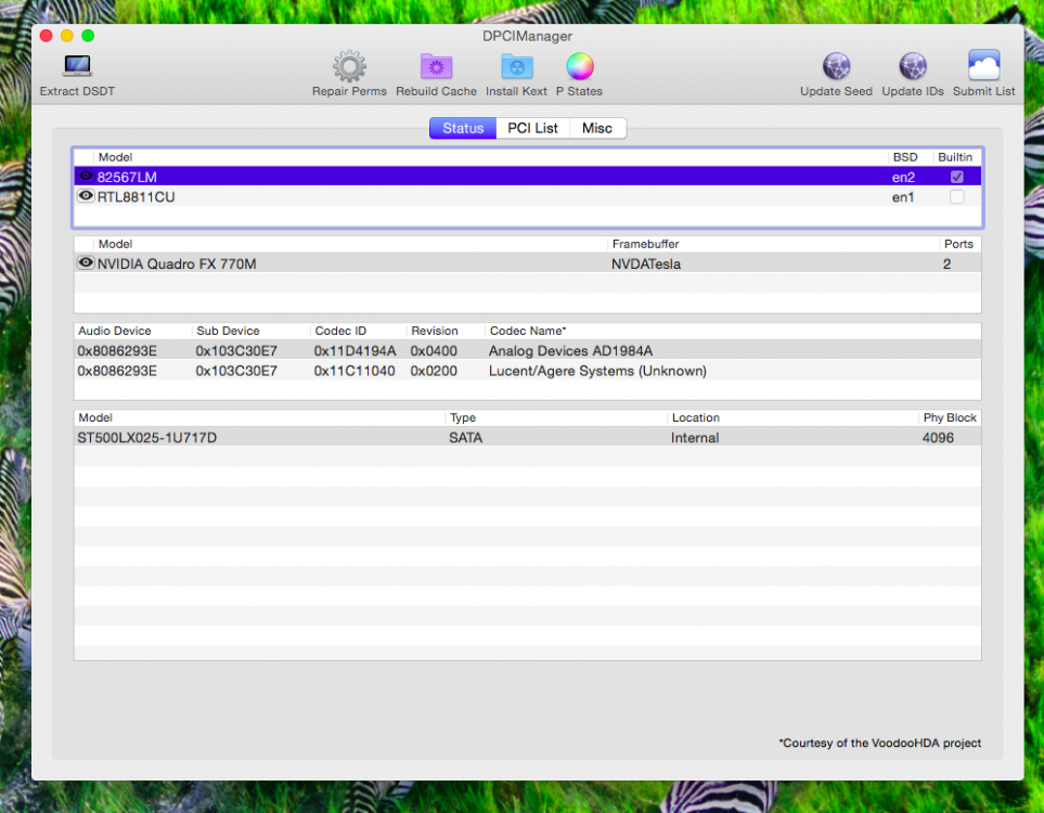

today I updated my HP 8530w to Yosemite 10.10.1. The last version of RehabMan-Battery-2014-1016 kext doesn't work perfect.
The battery shown as working and not working. Flipping between percentage and the X. But better than nothing.
​Seems to be dependent what is in use in the menue, so the battery kext works.
Gummans AppleHDA works.
VoodooPs2 was taken from TonymacX86's "Multiboost"so it works after sleep mode.
Speedstep is fixed by editing org.Chameleon.boot.plist with P- and C-states. Reboot is faster selecting also c2, c3, c4 states, but I don't know why.
I trying to find a way for undervolting to make the more battery time.

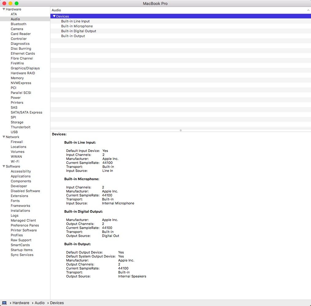

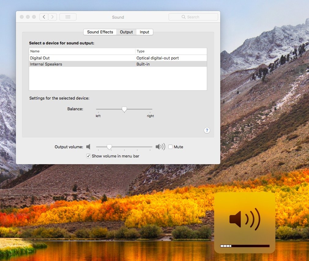

    Patched appleHDA could been easily by using appleALC.kext and lilu.kext.
    https://github.com/acidanthera/AppleALC/releases
    https://github.com/acidanthera/Lilu/releases
    For my 8730w, just inject id 28.

Sorry for my English,
     Using applealc.kext you should remove the patches for appleHDA in ‘ kernel and kext patches’ with
orginal AppleHDA kext untouched.
    Open your DSDT.aml with MaciASL app , and lookup for 'layout ' ,change the id to ‘2C’ ( ‘44’ Hexadecimal ).

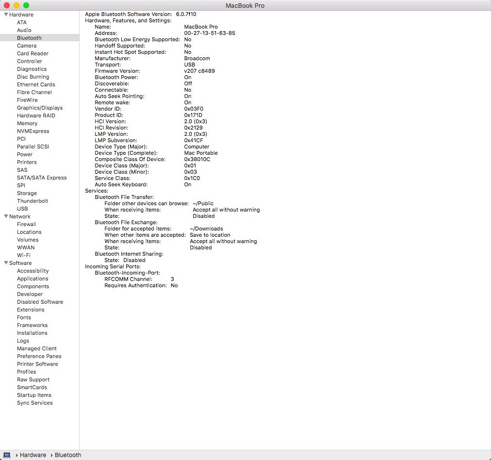

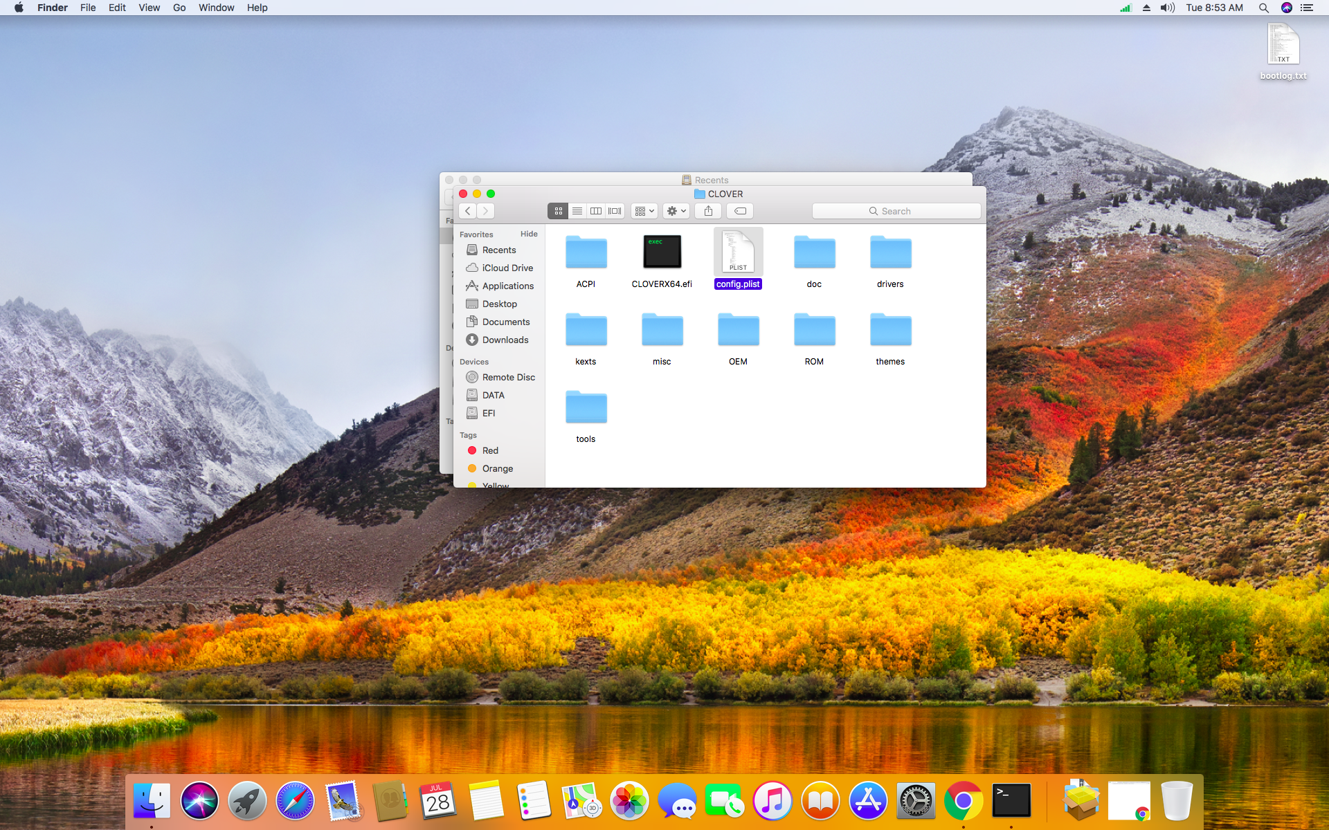

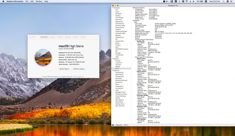

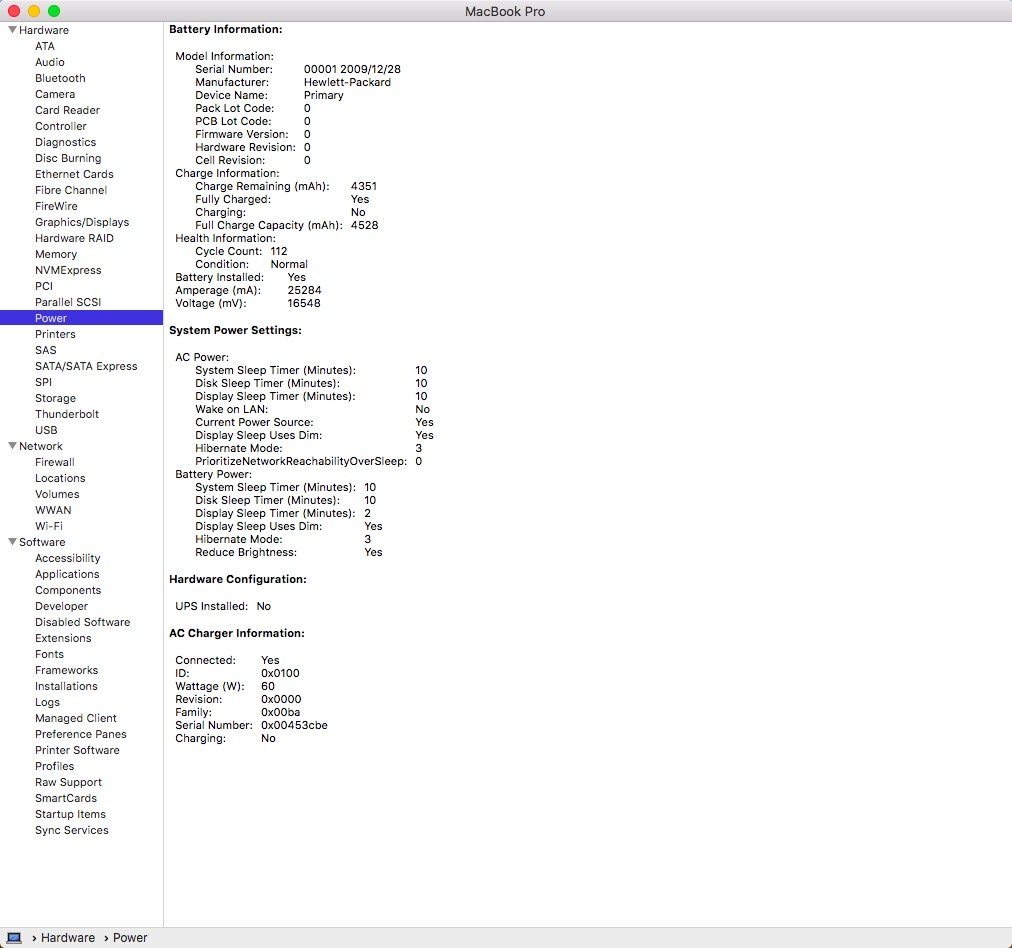

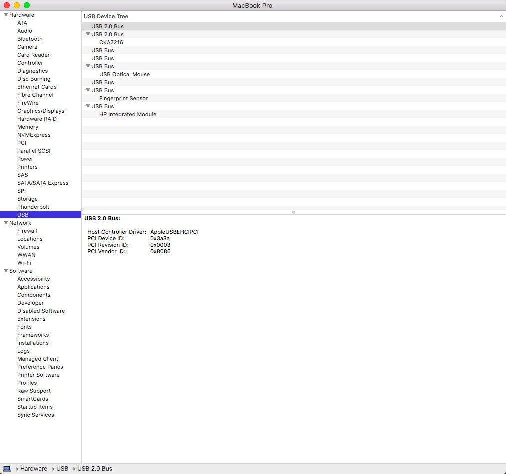

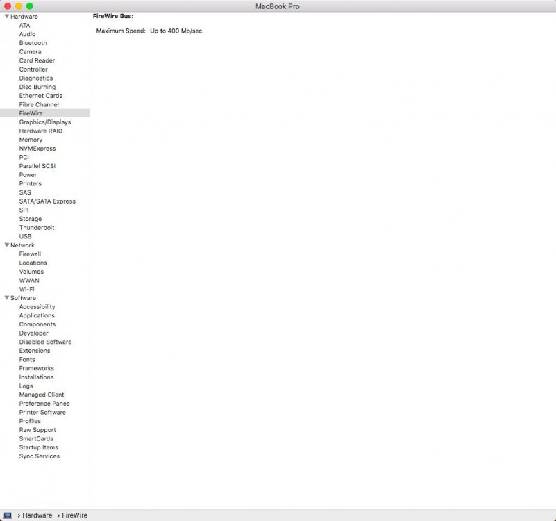

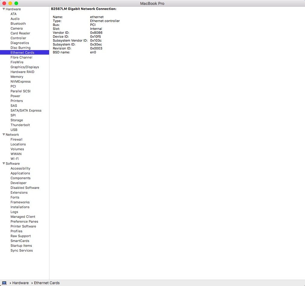

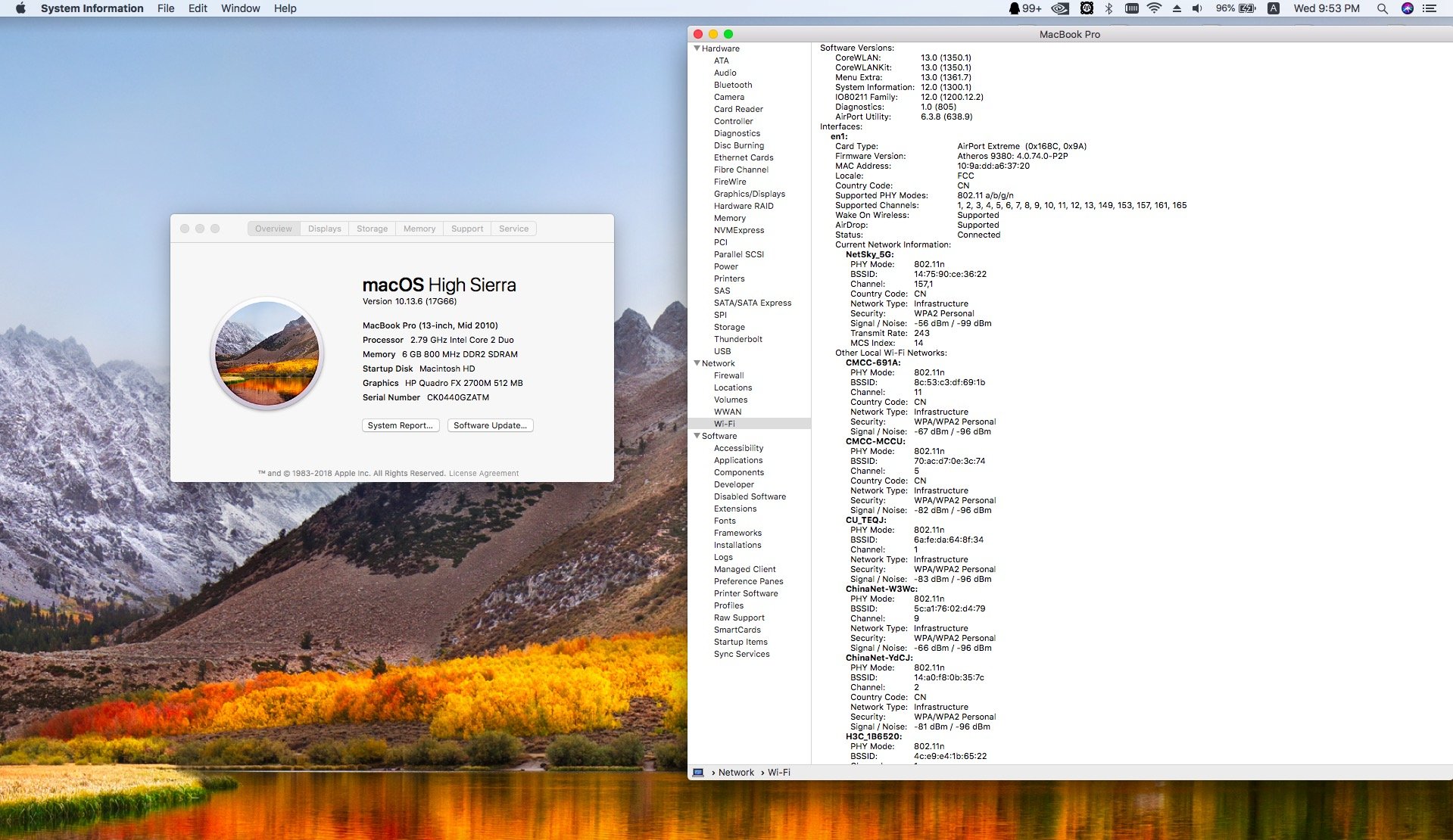

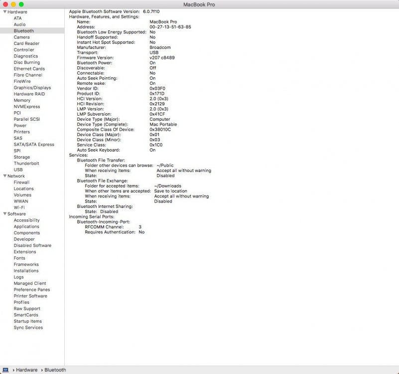

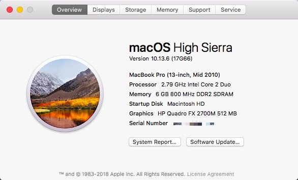

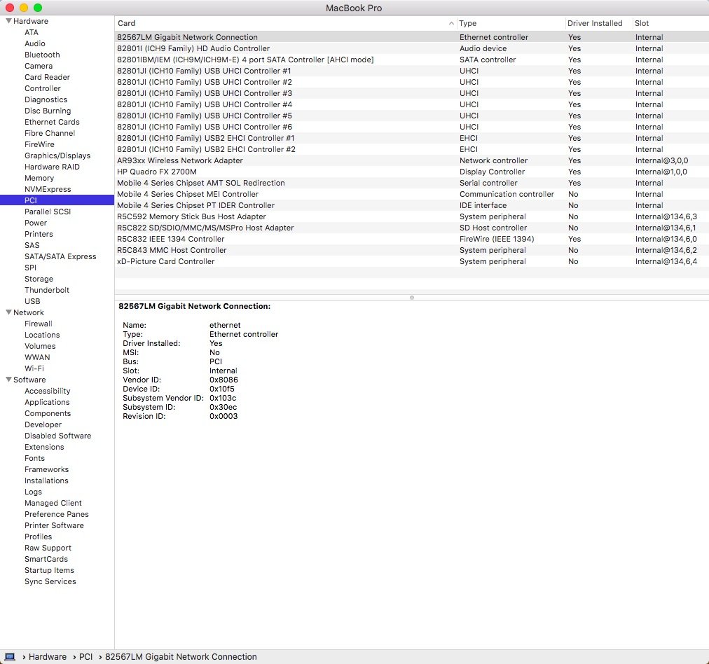

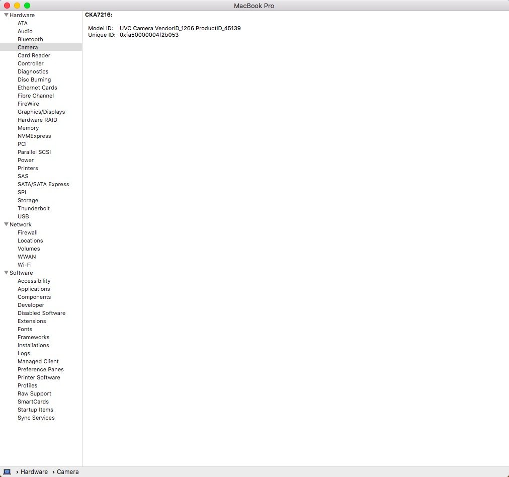

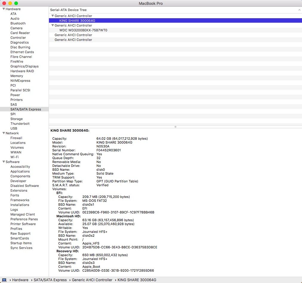

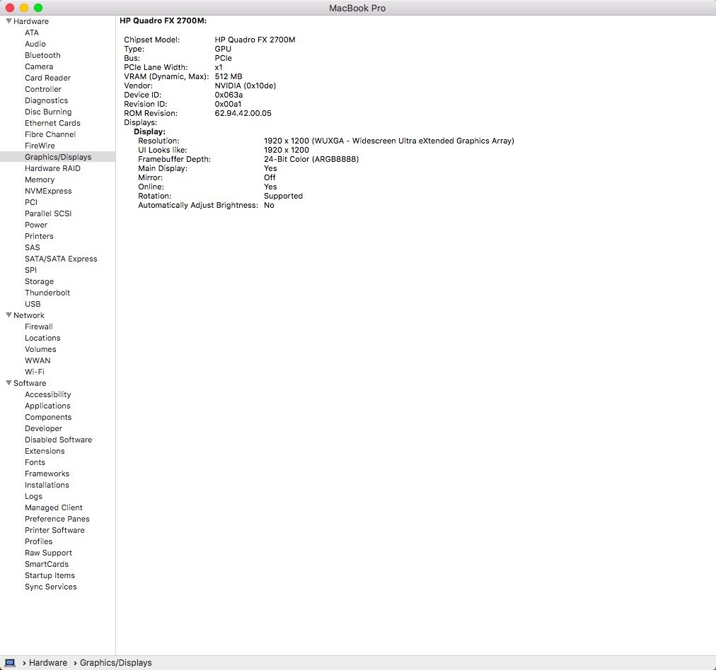

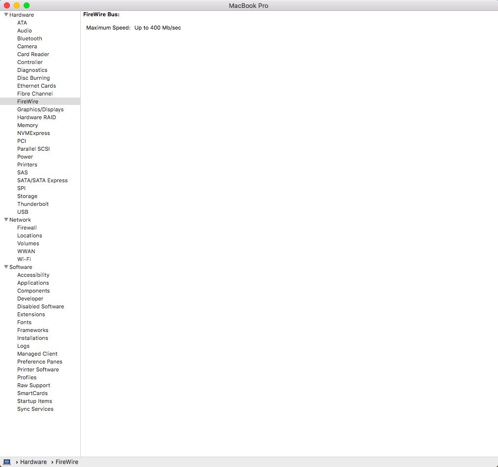

HP Elitebook 8730w install macOS  10.13.6
Elitebook 8730W, bios has been whitelist removed
Boot: Clover 4988 bios-MBR
The configuration driver is as follows:
 Core 2 dual-core T9600 2.8Ghz                                check c-state, p-state, frequency conversion is about 5 steps
NVIDIA FX2700m 512mb  ,                                       check inject nvida; OBB
AR9380 wireless Apple network card;                         OBB
Intel Gigabit wired network card;                               AppleIntelE1000e.kext
Broadcom Bluetooth ;                                               add id to BrcmBluetoothInjector.kext
Touchpad;                                                               ApplePS2SmartTouchPad.kext
Brightness;                                                        fixed AppleBacklightInjector.kext and patched applebacklight.kext
AD1984A sound card;                                            appleALC+lilu, id injection 44
USB ;                                                                  MacBookPro7,1, USBInjectAll.kext
Battery;                                                              patched DSDT+ SMCBatteryManager.kext
Camera;                                                             OBB
FireWire;                                                            OBB
Sleep;                                                                      hotpatched SSDT-Sleep_PRW-0B, SSDT-Sleep_PRW-0D/6D
DSDT patch
Extract the original DSDT, decompile to DSL file and aply patche
"Fix _WAK Arg0 v2"
"HPET Fix"
"SMBUS Fix"
"IRQ Fix"
"RTC Fix"
"OS Check Fix"
"Fix Mutex with non-zero SyncLevel"
“Brightness Fix”
"HP 8730w-bat" modified by myself HP 8730w-bat.rtf
can use:
CPU frequency conversion
Hard Disk Trim
Graphics QE CI
Wireless network card
Wired network card
Touchpad
Dimming
Volume touchpad adjustment
USB2.0
camera
Bluetooth
FireWire interface
Native brightness adjustment
PatchAppleBacklight_v2.zip
EFI.zip
Edited by sunnyboy958

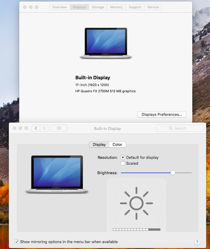

On 7/28/2020 at 9:56 AM, lamht said:
Hi InsanelyMac Protégé
After update macOS 10.13.6. The audio works.
But got screen light can not adjust. It setting lowest mode and can not brighter.
Thanks for you help.
1114570579_ScreenShot2020-07-28at8_53_14AM.thumb.png.6cc480afd5fb548d400949674df901a8.png
    You should patch your own AppleBacklightInjector.kext with PatchAppleBacklight_v2.zip , because your screen is not the same as mine.
