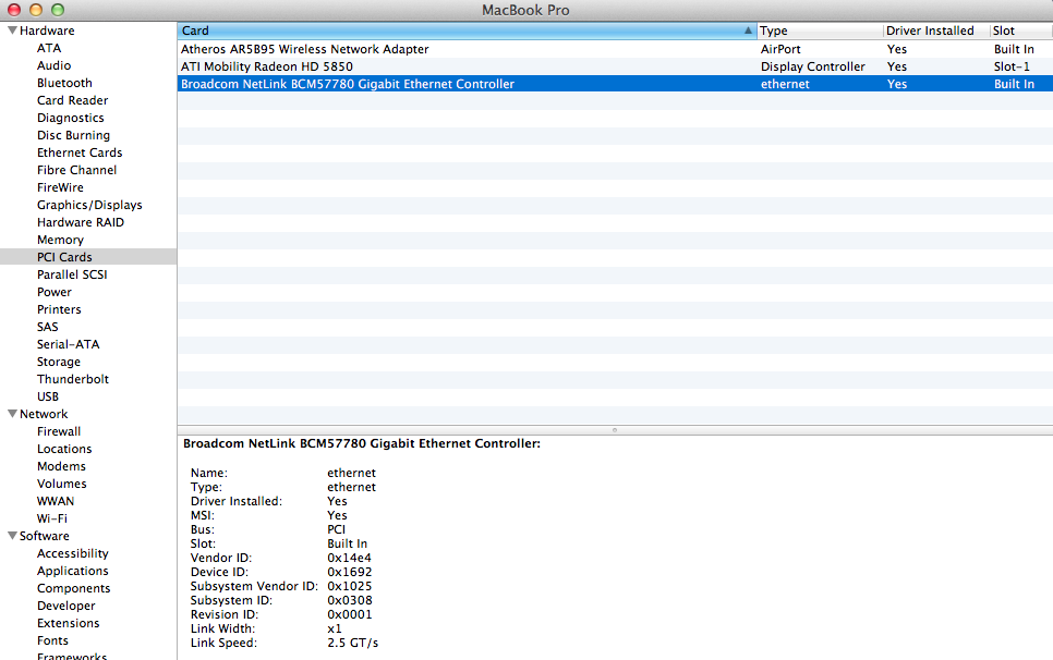

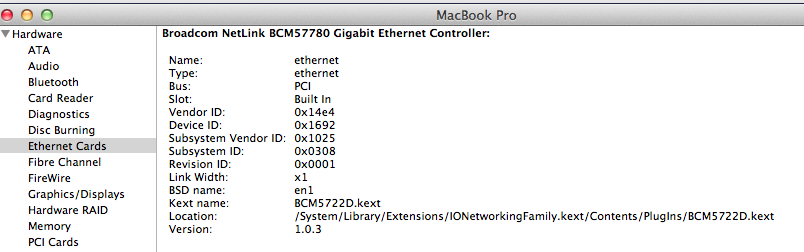

I did a new BCM5722d.kext. I just a little change the source code. It's only do for x64-systems.
I also fixed the stop after an intence traffic, but I can mistaking. So that/
Let me know if my fix doesn't work(I'll try to correct it)
#define DEVICEID_BCM5722 0x165A
#define DEVICEID_BCM5754 0x167A
#define DEVICEID_BCM5754M 0x1672
#define DEVICEID_BCM5755 0x167B
#define DEVICEID_BCM5755M 0x1673
#define DEVICEID_BCM5787 0x169B
#define DEVICEID_BCM5787M 0x1693
#define DEVICEID_BCM5906 0x1712
#define DEVICEID_BCM5906M 0x1713
#define DEVICEID_BCM57780 0x1692
Put this driver into the IONetworkingFamily->Plugins->.
http://www.osx86.net...do=file&id=3605

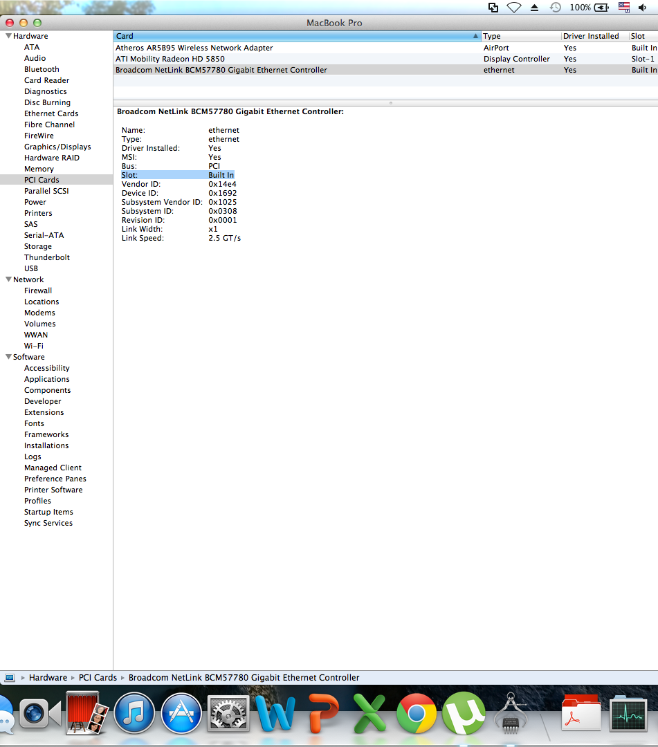

Hey Alex i have yet to try your version of the drive but i am running into the device not built in issue on my 5752 do you think it would fix it or do you have any pointers to fix it
i am on 10.8.2 Dell Precision 690 2 x4 xeon 16GB ram ASUS HD6670
have tried kernelflag builtin=yes with deleting files as well as interfaces rebooting and re-adding them
have added efi code into bootloader
neither have seemed to fix the issue will try you version 2.3 on new install partition when i finish making a new installer

Hello. I added your card to the code{ DEVICEID_BCM5752, "BCM5752 NetLink ™ Gigabit Ethernet" },. Are your device id 1600? If so, please try this one that I've attached.
