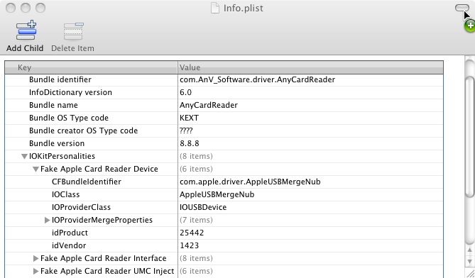

djolens81 Posted January 8, 2011 Share Posted January 8, 2011 My HP Pavilion system has an internal card reader and the hex product/vendor ID values are the same as yours. However, when I use the SL 10.6.5 calculator I get very different decimal values that yours. For me, 0x6362 = dec. 25442 and 0x58f = dec. 1423. When I place those values in the Info.plist file I get a working AnyCardReader kext. It shows as an internal card reader in System Profiler. Hope this helps - Good Luck Thanks for reply, Yes, i changed kext to those values, but still nothing. Can you send me your kext? Thanks for reply, Yes, i changed kext to those values, but still nothing. Can you send me your kext? One more thing, do you have listed Card Reader in card reader section of system information, or only in USB section? Link to comment Share on other sites More sharing options...

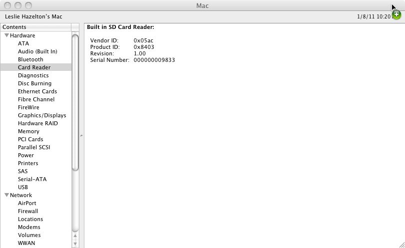

BladeRunner Posted January 8, 2011 Share Posted January 8, 2011 Thanks for reply, Yes, i changed kext to those values, but still nothing. Can you send me your kext? One more thing, do you have listed Card Reader in card reader section of system information, or only in USB section? The card reader shows as a card reader - see image. Plist is attached. Hope it helps. Info.plist.zip Link to comment Share on other sites More sharing options...

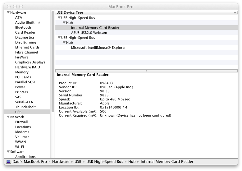

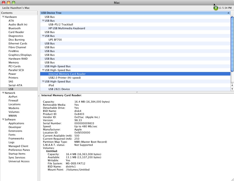

BladeRunner Posted January 8, 2011 Share Posted January 8, 2011 Hmmm, but i don't see the card when i insert it (in the card reader section).Is there something else to do? What I see in the System Profile --> Card Reader section does not change when I insert a memory card. What does change is the entry under SP --> USB --> Internal Memory Card Reader. That shows the volume name and size etc... for the memory card you inserted. Since my reader supports several types of cards I inserted two different ones at the smae time. They both show up as memory card icons on the desktop and in the finder window. They are both accessible at the same time. However, the System Profile --> USB --> Internal Memory card Reader display only shows one of the volume names. The last one inserted I think. As far as I know, that is the way it is intended to work. Someone else correct that assumption if I am mistaken. Link to comment Share on other sites More sharing options...

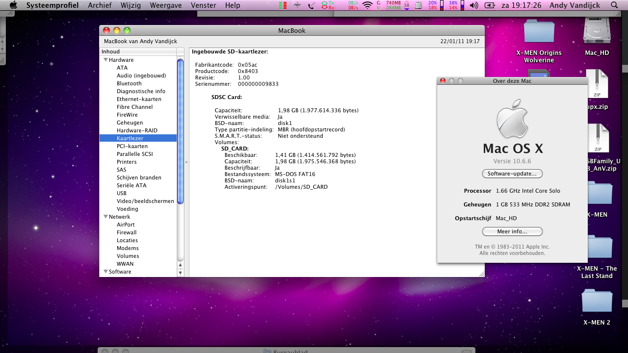

Andy Vandijck Posted January 22, 2011 Author Share Posted January 22, 2011 Hi. Is there some change with 10.6.6. It is working well with 10.6.5 but no more with 10.6.6. In fact, it works as I've got the SD icon, but nothing in Information System... Just saying that I haven't got any Apple Memory Reader... That's really odd. I would check your kext. I tested it under 10.6.6 (attached below, in link) and it worked just fine... Proof: Link to comment Share on other sites More sharing options...

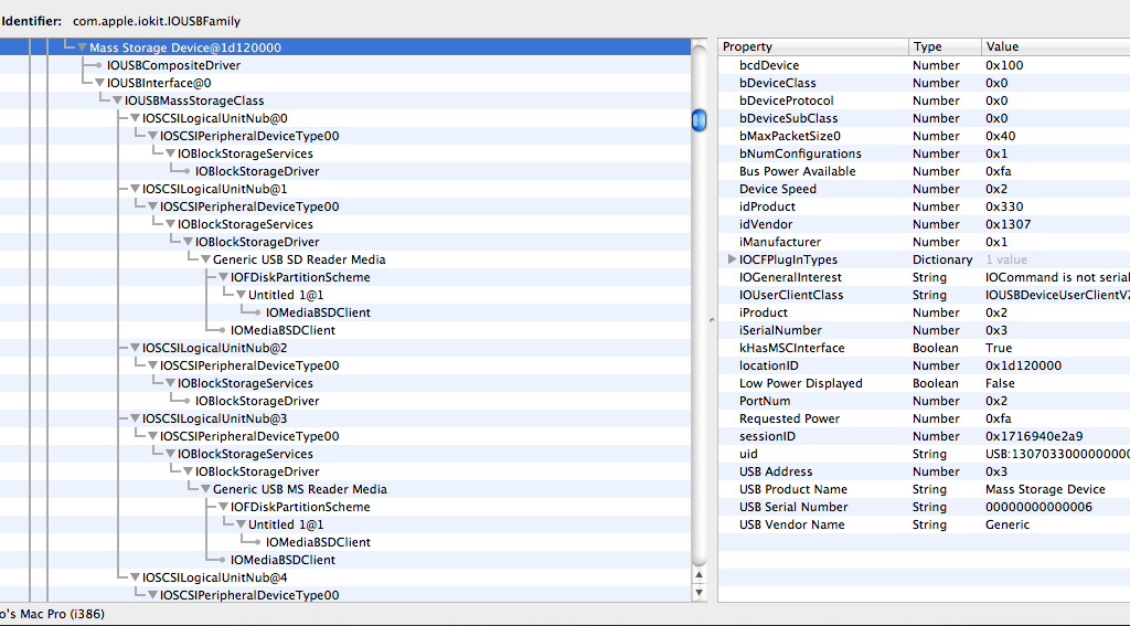

eric028 Posted June 15, 2011 Share Posted June 15, 2011 How about a multi-card-slot card reader? I have USB SD Reader under IOSCSILogicalUnitNub@1 Mini SD Reader under IOSCSILogicalUnitNub@2 USB MS Reader under IOSCSILogicalUnitNub@3 USB SM Reader under IOSCSILogicalUnitNub@4 What should I input under AnySDCardReaderAnySBC and Fake Apple Card Reader SCSI Inject?? Link to comment Share on other sites More sharing options...

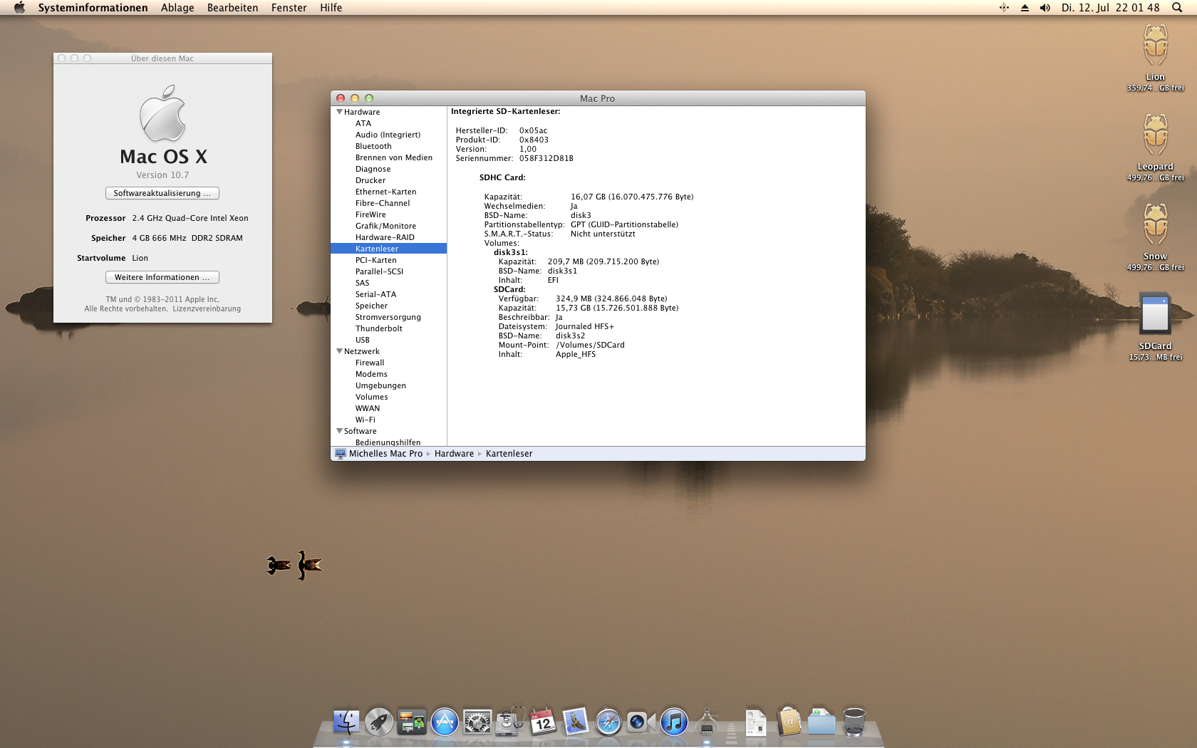

Acid_Burn Posted July 12, 2011 Share Posted July 12, 2011 Works great on OSX 10.7 Lion! Link to comment Share on other sites More sharing options...
