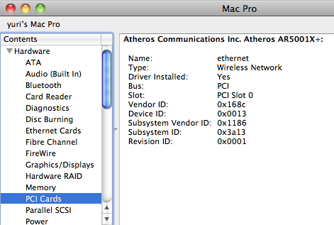

HI, I'm trying to add info about my atheros wireless card in system profiler using dsdt.
I have added this[codebox]Device (RP06)
Name (_ADR, 0x001E0000)
Device (ARPT)
Name (_ADR, Zero)
Name (_PRW, Package (0x02)
0x09,
0x03
Store (Package (0x10)
"AAPL,slot-name",
Buffer (0x08)
"AirPort"
"device-id",
Buffer (0x04)
0x13, 0x00, 0x00, 0x00
"device_type",
Buffer (0x11)
"Wireless Network"
"model",
Buffer (0x2D)
"Atheros Communications Inc. Atheros AR5001X+"
"built-in",
Buffer (One)
0x00
"subsystem-id",
Buffer (0x04)
0x13, 0x3A, 0x00, 0x00
"subsystem-vendor-id",
Buffer (0x04)
0x86, 0x11, 0x00, 0x00
"vendor-id",
Buffer (0x04)
0x8C, 0x16, 0x00, 0x00
}, Local0)
Return (Local0)
Return (GPRW (0x0B, 0x04))
Method (_PRT, 0, NotSerialized)
If (PICM)
Return (AR01)
Return (PR01)
}[/codebox]
but not works. Any suggestion? the card works fine (just no info)

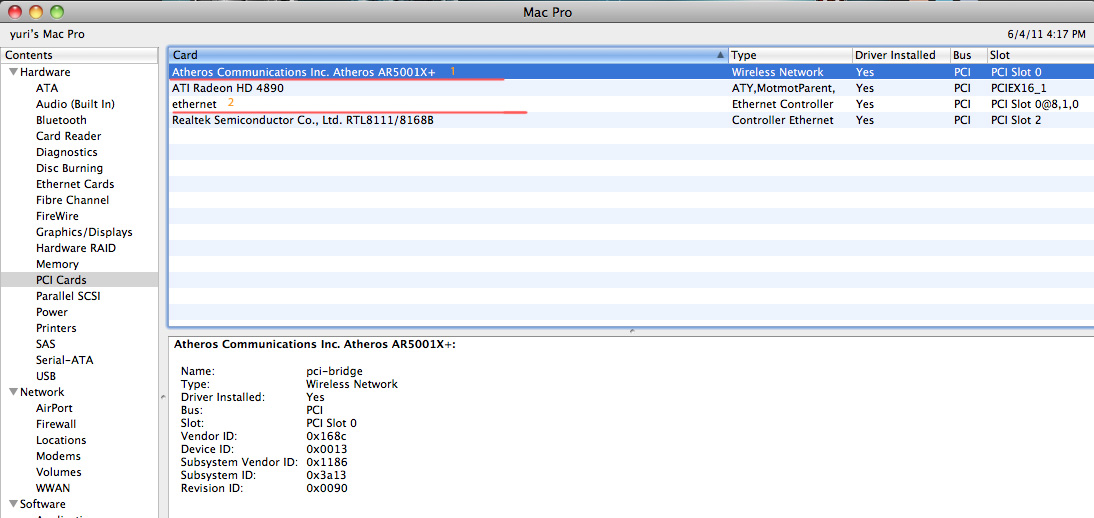

seems thas ioreg doesn't recognize dsdt injection of arpt subdevice.
Attached File  Mac_Pro.zip   666.78KB   56 downloads
Attached File  dsdt.aml.zip   17.86KB   28 downloads
