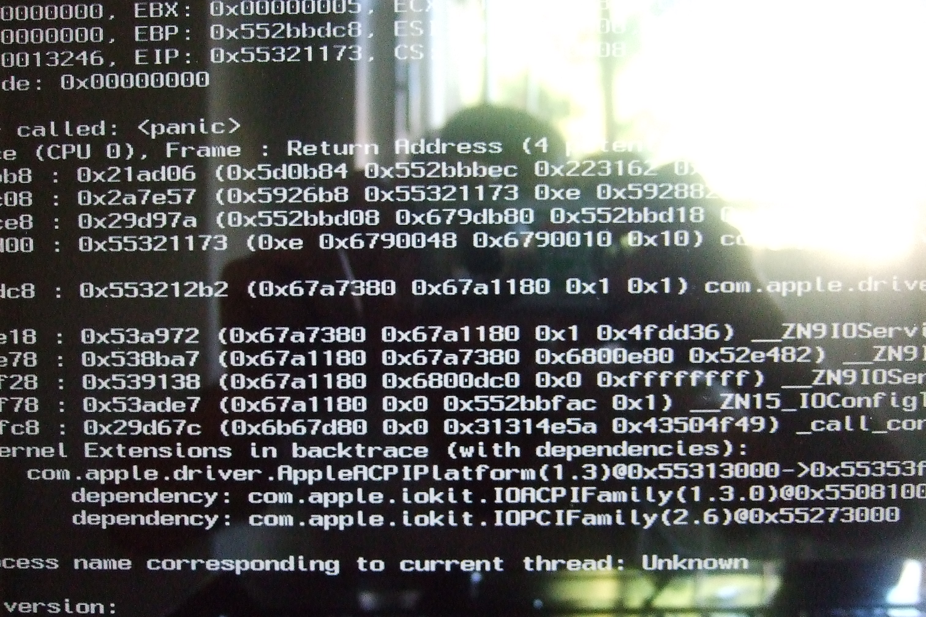

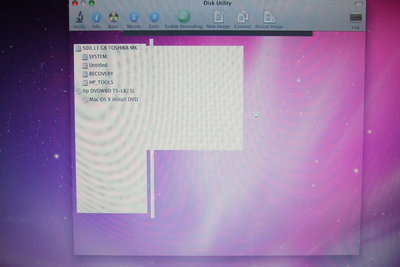

Mac Man 50 Posted June 11, 2010 Share Posted June 11, 2010 Hi, I have dv8t (Full HD, 500GB HDD and 8GB RAM). I tried Legacy Empire EFI v108 method. No go. I got the Empire EFI menu and also got the Snow Leopard Install DVD icon. Pressed ENTER and it wrote some text (...extensions.kext) on the white background (couldn't figure out what it is writing) and then stopped with blank screen. I had to switch it off and on to get to Windows 7. Btw, dv8t came with F.15 BIOS rev. I upgraded to F.21 with no issues. Windows 7 was able to boot w/ no issues at all. Also, my system comes with 8GB RAM. Then, I tried the regular Empire EFI v108, v1.085 and still no go. Finally, I tried [url="http://www.insanelymac.com/forum/topic/279450-why-insanelymac-does-not-support-tonymacx86/"]#####[/url] Supported 2.0 and it gave me this: "You need to restart your computer...". I think this thread gives me some hope. Do I need to try the tutorial listed here? Please help. Thanks. Link to comment https://www.insanelymac.com/forum/topic/215033-guide-snow-leopard-on-hp-dvx-quad-core-i7-qm/page/3/#findComment-1486509 Share on other sites More sharing options...
Mac Man 50 Posted June 11, 2010 Share Posted June 11, 2010 I tried the steps described in the first posting in this thread by using tonymacx86-P55BootCD and got to the Chameleon boot menu, inserted Snow Leopard DVD, pressed F5 and when launching the DVD, it wrote several entries on the screen and finally gave a kernel panic. I have attached the panic screen. Please help. Link to comment https://www.insanelymac.com/forum/topic/215033-guide-snow-leopard-on-hp-dvx-quad-core-i7-qm/page/3/#findComment-1486796 Share on other sites More sharing options...
yehia2amer Posted June 11, 2010 Author Share Posted June 11, 2010 I tried the steps described in the first posting in this thread by using tonymacx86-P55BootCD and got to the Chameleon boot menu, inserted Snow Leopard DVD, pressed F5 and when launching the DVD, it wrote several entries on the screen and finally gave a kernel panic. I have attached the panic screen. Please help. try booting with those boot flags: "cpus=1" and "maxmem=1024" without quotes Link to comment https://www.insanelymac.com/forum/topic/215033-guide-snow-leopard-on-hp-dvx-quad-core-i7-qm/page/3/#findComment-1486860 Share on other sites More sharing options...
Mac Man 50 Posted June 11, 2010 Share Posted June 11, 2010 Thanks. I'm using [url="http://www.insanelymac.com/forum/topic/279450-why-insanelymac-does-not-support-tonymacx86/"]#####[/url] Supported 2.0 and tried the following flags suggested elsewhere: cpus=1 busratio=12 fsb=133. I was able to go past the apple logo and the spinning wheel. Beyond that, I got the purple space logo and a grey rectangle in the middle. I blindly pressed ENTER and the screen is very slow and not responding to clicks or keyboard clicks immediately. Also, the screen is cut in pieces. I also tried appending maxmem=1024. No go. Same slowness. Please help. Link to comment https://www.insanelymac.com/forum/topic/215033-guide-snow-leopard-on-hp-dvx-quad-core-i7-qm/page/3/#findComment-1486958 Share on other sites More sharing options...
