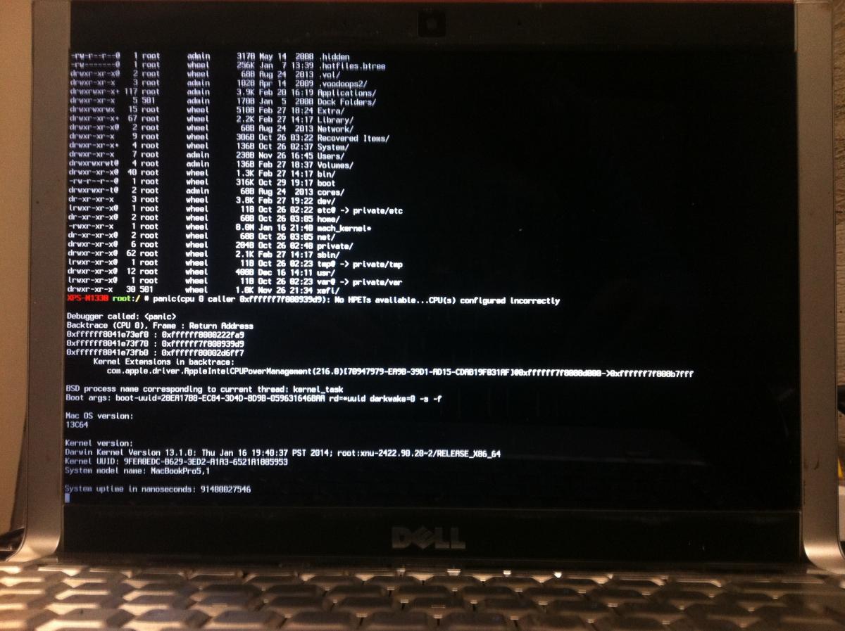

I having Kernel Panics on AppleIntelCPUPowerManagement.kext after 10.9.2 Update
Any idea what could be causing it?

You have no posted a pic of your panic, so I can't be sure, but if it is because of locked MSR 0xE2 (if in the panic RCX=000000E2), then you should install patched AppleIntelCPUPowerManagement.kext. Otherwise, it is probably something to do with an incorrect SSDT setup...
How come "incorrect SSDT setup" after no KP with 10.7.x, 10.8.x, 10.9 and 10.9.1 with almost the same DSDT.aml, no modifications on SSDT entries on the DSDT.aml from this topic nor using any SSDT.aml file?
Here the Screen Capture:

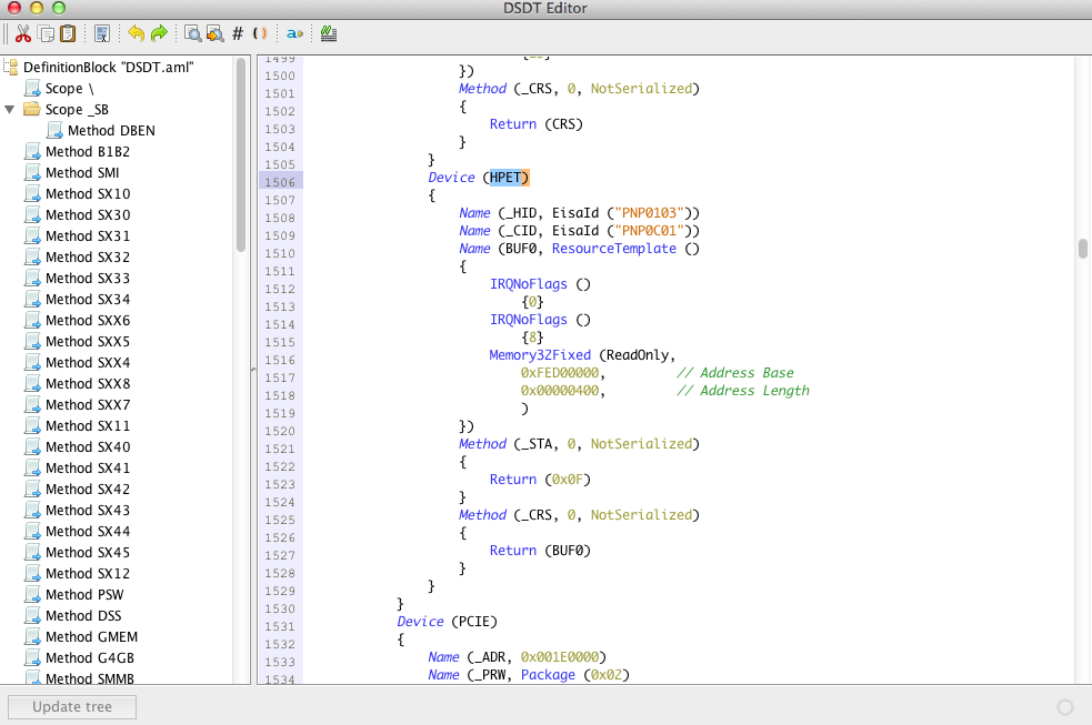

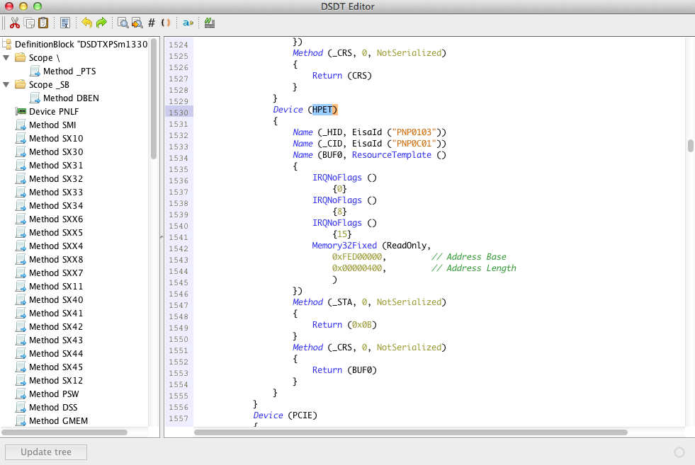

Looks like HPET problem. Have you patched DSDT for HPET?
@macgirl,
The HPET section in your DSDT has an extra
IRQNoFlags ()
                            {15}
and Return (0x0B) instead of (0x0F)
compared to the HPET section in my DSDT for the XPSm1530
Maybe try with the DSDT attached below where I have removed the offending IRQNoFlags ( ) {15} and changed 0B to 0F
Tried but same result :(
Thanks.
MacGirl I think that this is your problem. This DSDT never worked for me. It also gave me kernel panics. Try using the DSDT on the first post from September 29, 2012. If that doesn't work on it's own try also changing your machine type to MacBook5,2 if it is not already. Make sure you do NOT have the DropSSDT or GeneratePStates boot flags enabled.

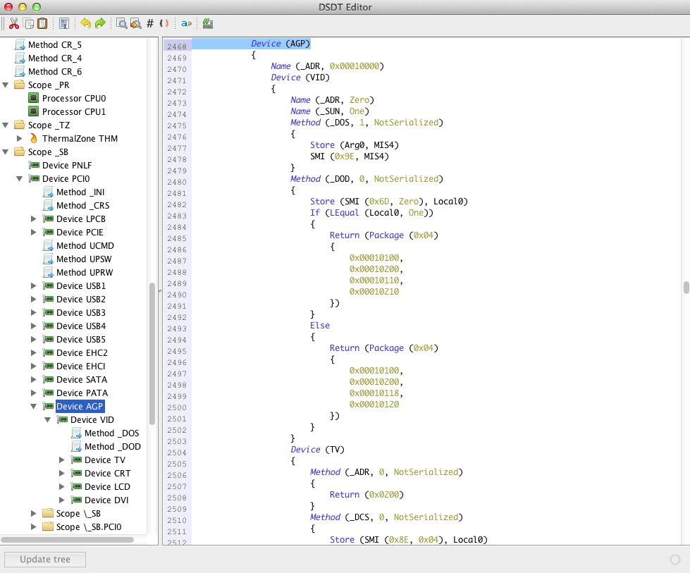

@LatinMcG, thanks for your suggestion - Do you mean to remove the Device (AGP) section or are you referring to nVidia injection?  My DSDT already has the nVidia section stripped out so relies on bootloader GraphicsInjection=Yes.
I couldn't find the string "VGA" in my DSDT....It would be nice if a dsdt fix could be found for the reboot on second sleep problem with the XPSm1530, using the native Mavericks AppleACPIPlatform.kext.....

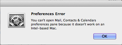

All, new problem, seems to have started at the same time as my sleep stopped working.  I can no longer get into my mail settings panel in the preferences.app.  I keep getting this window, which I've never gotten before.
Any ideas?  It's driving me crazy because I can't change certain settings that I need to.
<sigh>
@lulighttec,
You might have a corrupted Mavericks install - see njah's post in this discussion thread.  In Mavericks, the preference pane isn't called 'Mail, Contacts & Calendars' anymore, it's now called 'Internet accounts'
I've attached my functioning InternetAccounts.prefPane to this post but seeing your other issues, maybe a clean reinstall of Mavericks is in order ....

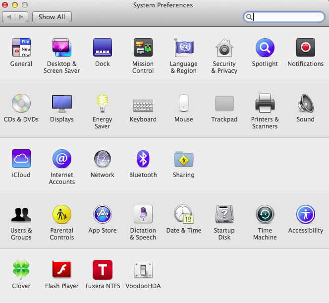

Your preference pane fixed that problem... thank you!
