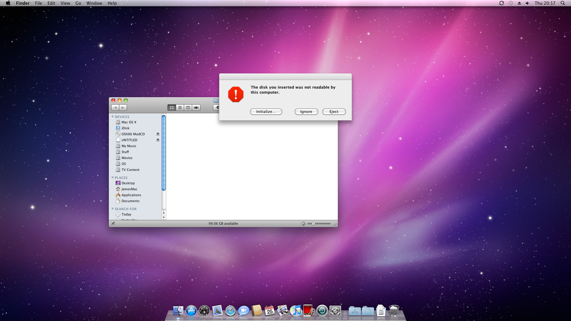

I was using VLC.
Booted with debug=0x100, and got to desktop.
Came up with apple (big red stop sign) error 'this disk is not readable etc', then locked up again. Time was still changing though!
Any ideas?

OK, switched the wires over - now HDD is slave and DVD is master, 80 pin wire.
Booting normally gets this error 'the disk you inserted was not readable by this computer' and PC locks up, however...
Booting with cpus=1 & maxmem=2048 gives same error, but hasnt locked up yet... (im typing in OS X as we speak!)

Do you have any HDDs or other storage devices attached with a partition/format scheme other than HFS+, FAT32 or NTFS?
Yes i did! An old HDD was plugged in and i didnt realise - took it out and now error has gone - phew!
