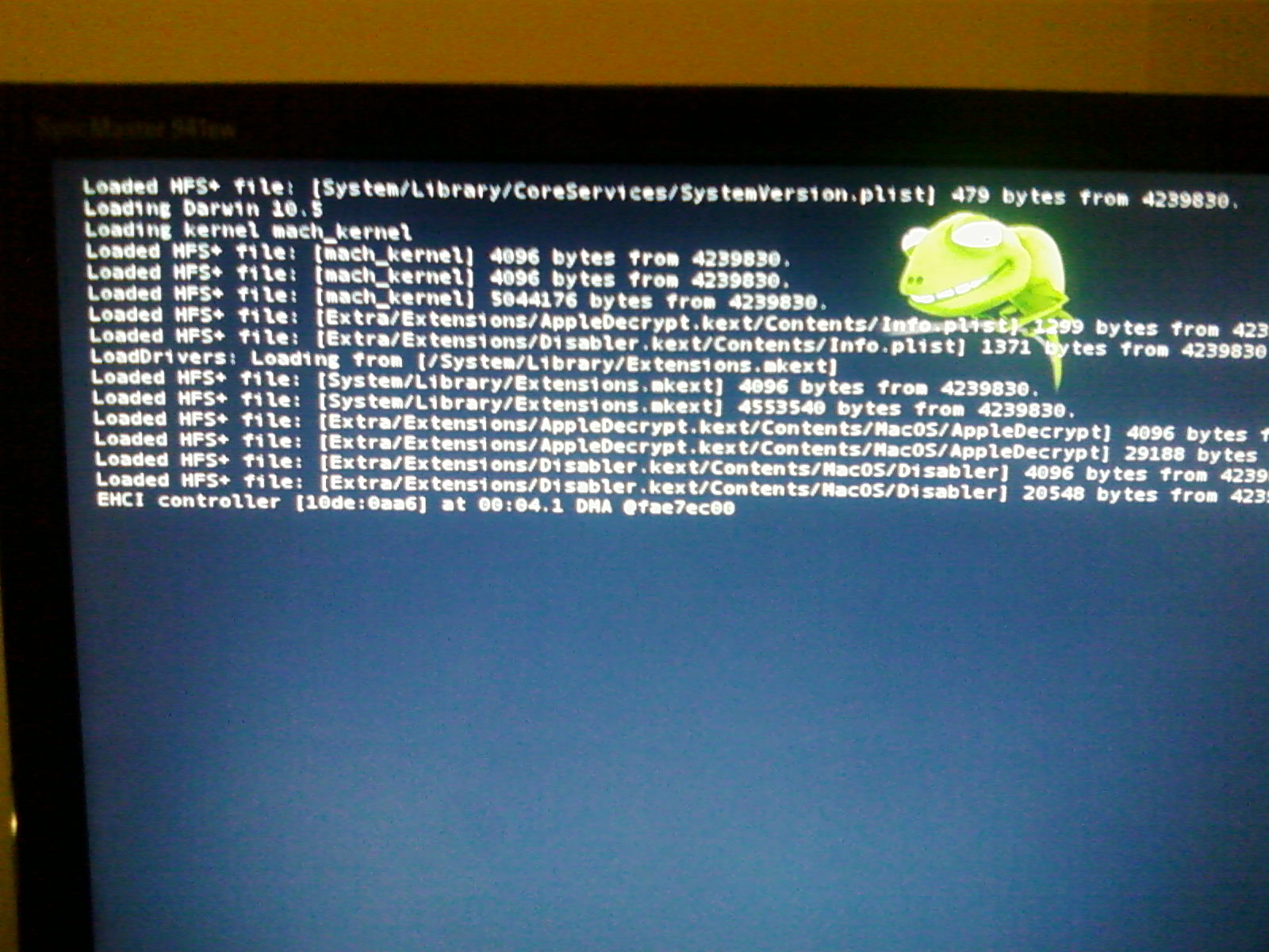

bramo Posted August 14, 2009 Share Posted August 14, 2009 Hi Shoarthing, I have a question: I followed all the steps to install and received as a result the image attached. Any ideas? I used: 10.5.6 vanilla BIOS v1.50 ION_330_install.zip Thanks, Bramo Link to comment https://www.insanelymac.com/forum/topic/178372-illustrated-pdf-vanilla-osx-105-on-the-asrock-ion-330-nettop-nb-not-for-pro-or-hd-versions/page/2/#findComment-1226301 Share on other sites More sharing options...
shoarthing Posted August 14, 2009 Author Share Posted August 14, 2009 What BIOS-settings do you have for USB? Any weird widgets plugged in to USB ports? . . . 'EHCI' = USB2 & Device ID 10de0aa6 is the ION chipset's USB2 controller, so that looks likely to be the focus of your hassle. Link to comment https://www.insanelymac.com/forum/topic/178372-illustrated-pdf-vanilla-osx-105-on-the-asrock-ion-330-nettop-nb-not-for-pro-or-hd-versions/page/2/#findComment-1226370 Share on other sites More sharing options...
