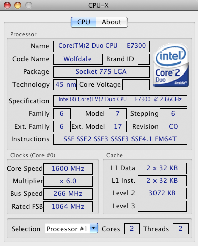

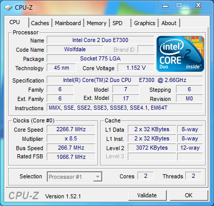

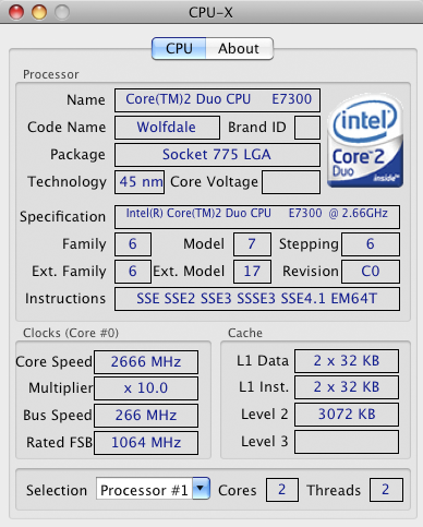

EDIT: I am just comparing Win 7 CPU-Z with OS X CPU-X speedstep to see what differences I can see. :blink:
Here's a screengrab from CPU-Z and CPU-X.
I have also added a screengrab from CPU-X without VoodooPowerMini running (the 111.13K image)
Windows 7 and OS X with VoodooPowerMini have both applied SpeedStep to dynamically change the clock speed of the processor. Whereas OS X without VoodooPowerMini, has not applied SpeedStep leaving the processor clock speed as default.

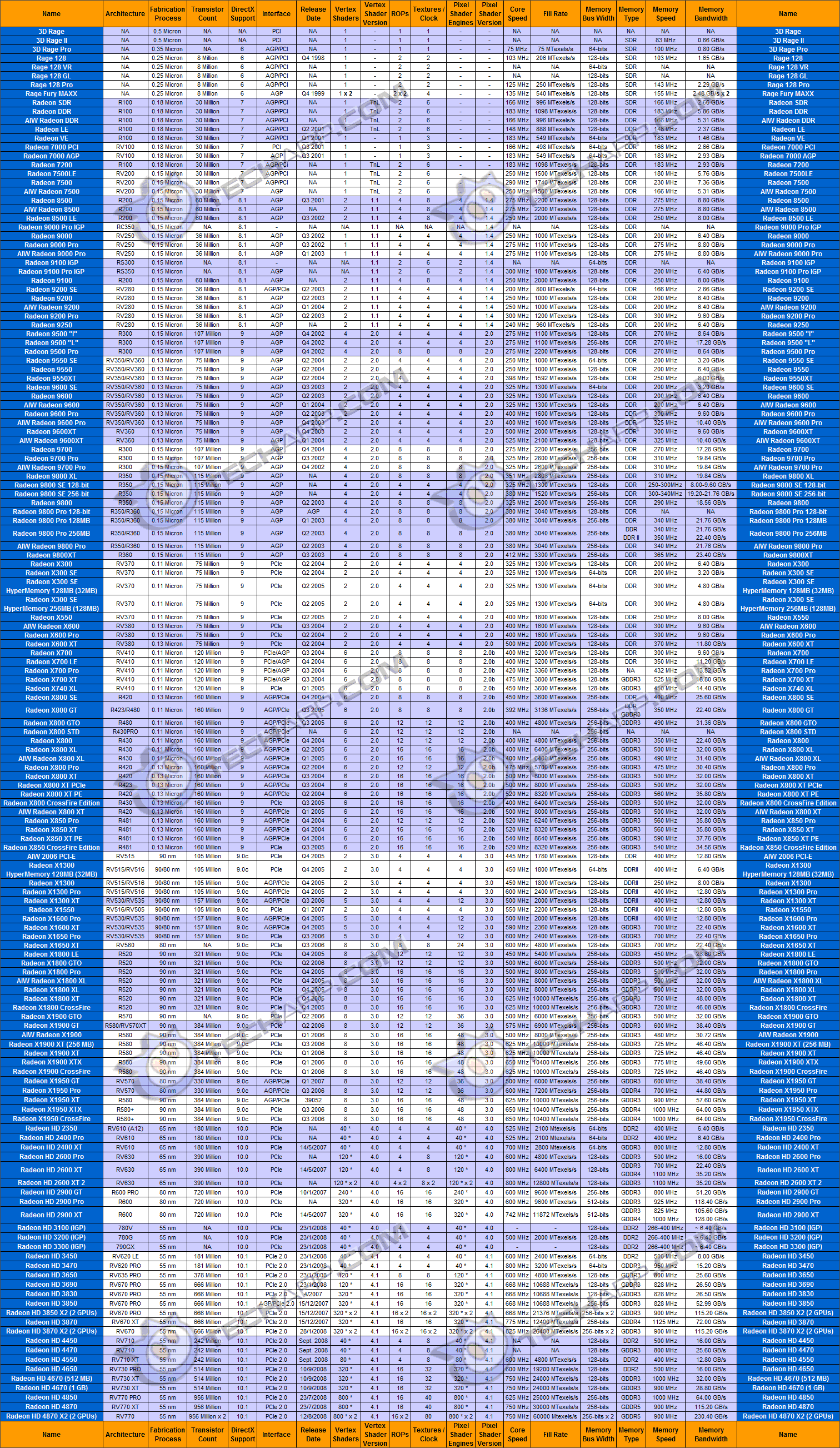

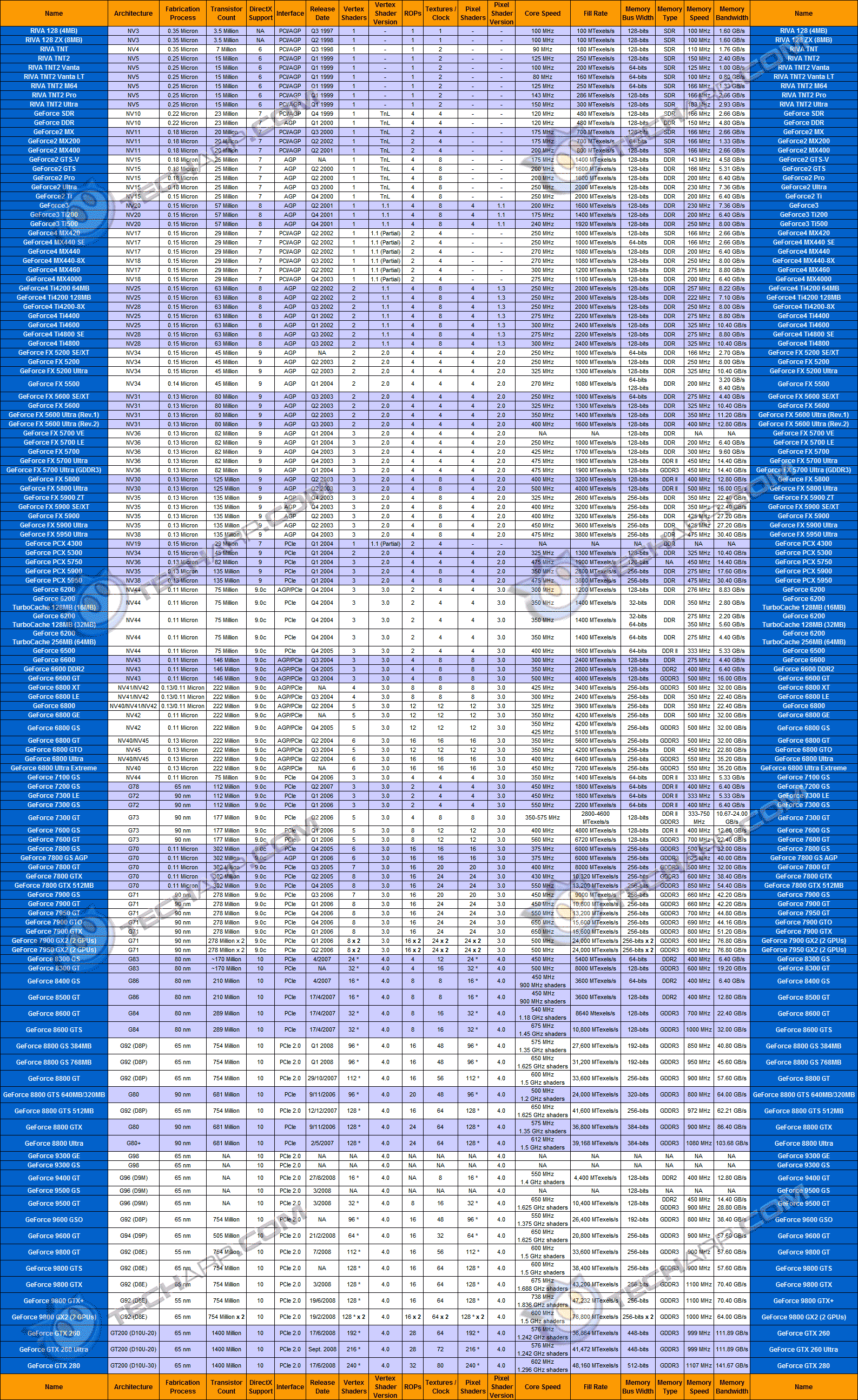

I have attached 2 x charts that I used to use to help me choose video cards. They're quite old now but they listed all the specs of each card. I bought my 8800GT second hand last december for £80 from ebay as I couldn't find one in the shops.
