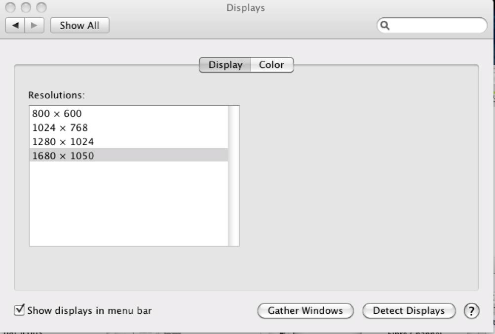

Gigabyte HD4350 512MB. Fully working (as far as I can tell) QE/CI, however it only outputs on the VGA connector correctly (I managed to get a heavily artifacted display with DVI and 10.6.0).
**EDIT: Mildy at a loss, applied this to another SL install (first partition on drive) and now the DVI works but the VGA doesn't. Still working though.
I used mcgrath's solution. My ATIRadeonX2000.kext didn't need any changes, just had to add the id ("0x954f1002") to ATI4500Controller.kext.
My system is a myHack 10.6.0 retail Snow Leopard USB install. If you installed from an existing Leopard install, you more than likely will have problems getting this to work.
DO NOT APPLY THE 10.6.3 UPDATE! It will create serious problems with the display. Netkas (netkas.org) mentions something about the update breaking the framebuffer and using the 10.6.2 framebuffer, but I've yet to try that.
** EDIT: See my post on 10.6.3 further down.
I have an AMD cpu, so I used the myHack chocolate kernel initially, but then switched to the 10.6.3 qoopz/nawcom legacy kernel after upgrading to 10.6.2.

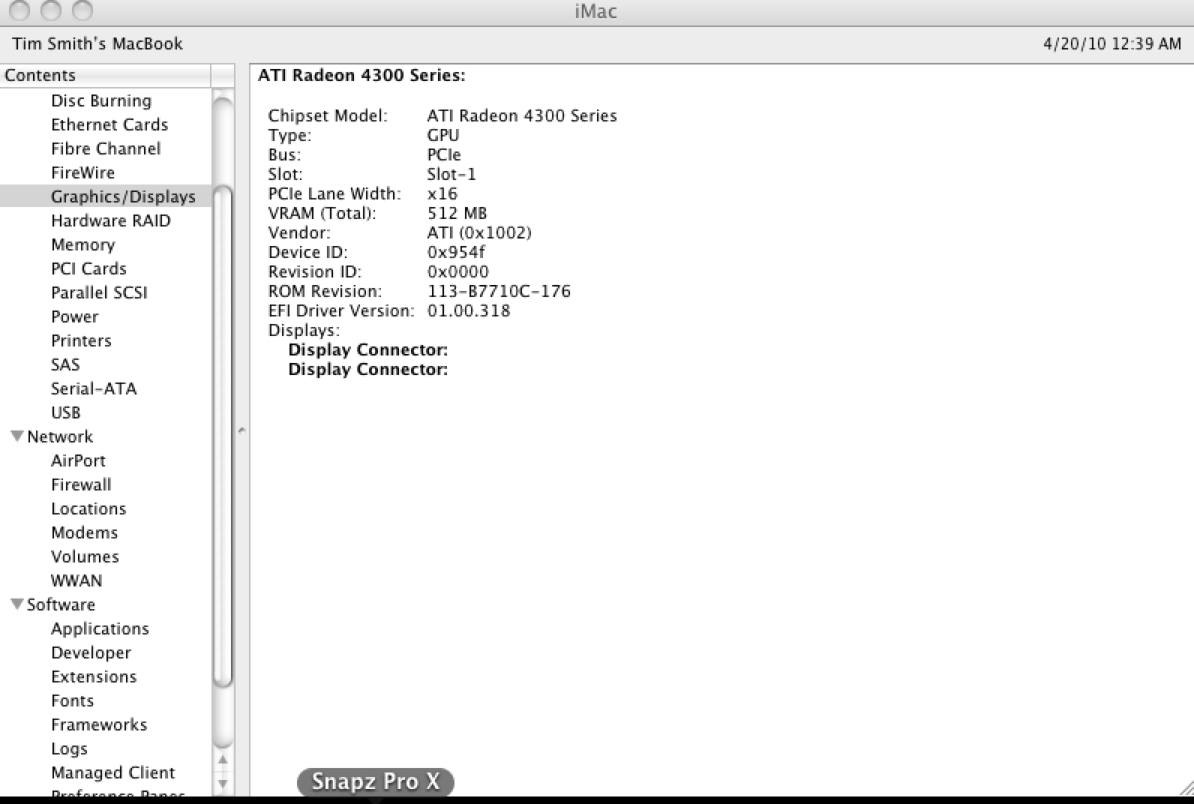

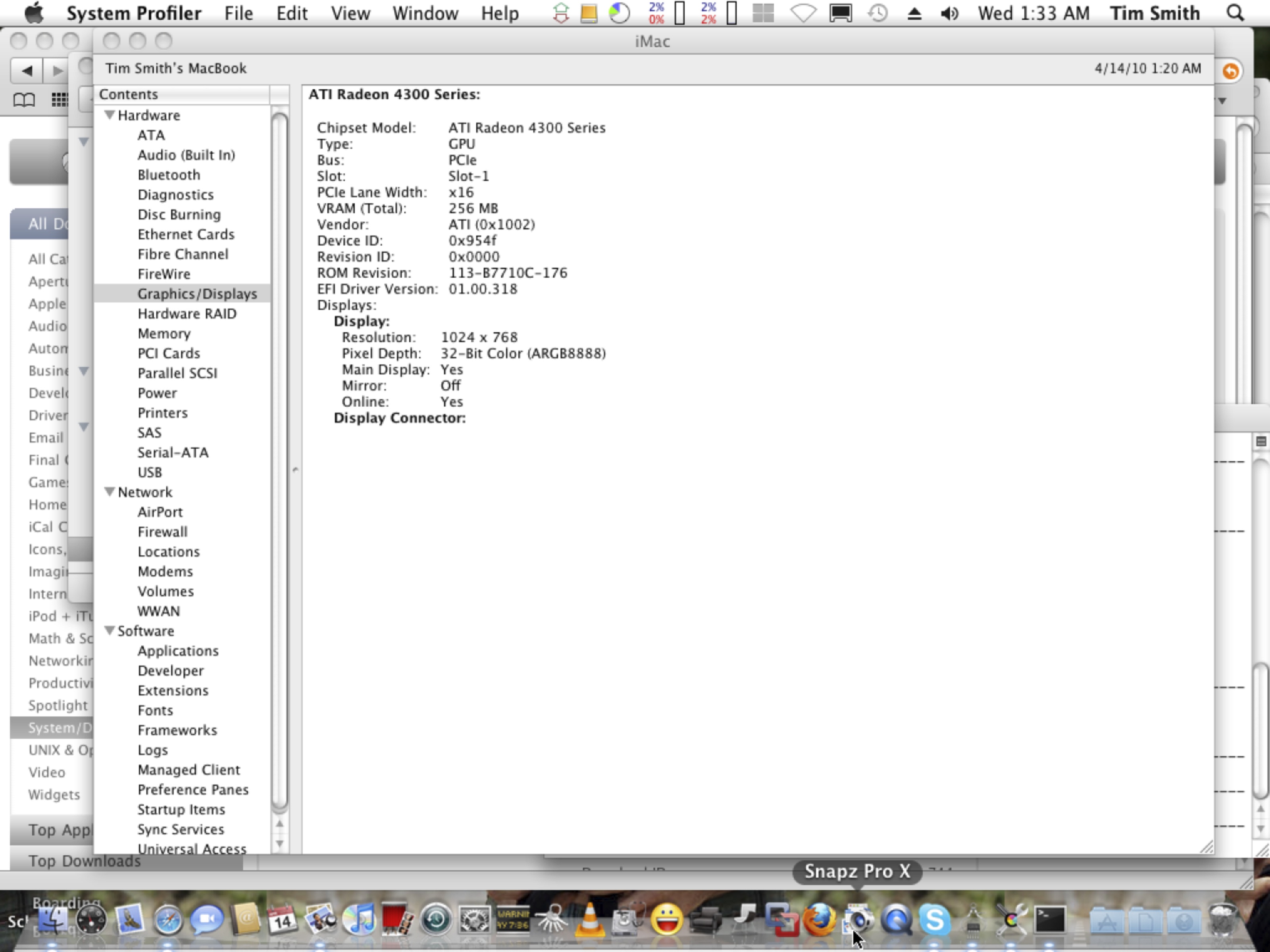

Updated to 10.6.3. Rebooted with "-x". Added the 4350 id ("0x954F1002") to /System/Library/Extensions/ATI4500Controller.kext, ran pfix (to rebuild kext caches), and rebooted.
DVI seems to work with one immediately noticeable issue, the apple logo on the top menu bar is green. It changes back to normal if you turn off transparency, but with transparency enabled it is bright green. This may be an indicator of a more serious issue, but my tests all seem to be working just fine. If anyone has any ideas or even a theory on why this is happening, please share.
So it looks like there is full driver support for the 4350 (starting in 10.6.2), you just need to add your id to the vanilla ATI4500Controller.kext and use GraphicsEnabler (see below) with Netkas PC EFI 10.6 booter. No additional kext needed.
Enable GraphicsEnabler by adding to /extra/com.apple.Boot.plist:
<key>GraphicsEnabler</key>
<String>y</string>
This should also work with 10.6.2, just make sure to also add the id to ATIRadeonX2000.kext. I don't think it appears in there until 10.6.3. Also, 10.6.2 doesn't have the green apple issue.
If you have any problems getting this to work, I would suggest trying the 10.6.3 legacy kernel from qoopz/nawcom. Modbin and the chocolate kernel from myHack did not fully work for me.

With 10.6.3 having come down finally, what about the most annoying ATIRadeonx2000.kext KP.....?
¡FØRWARD BRAVE ATi 4350s!
(step by step guide/summary post)
We have QE/CI etc, DVI or VGA but no dual monitors :D
Also no hdmi port, but apparently you can get hdmi if you use a DVI to HDMI adaptor.
Step 1:
(i will see about maybe making an injector kext, so as to get rid of this step)
If you are on 10.6.2
Add your device-ids to the both the ATi kexts, as described in this post.
The kexts are already in System/Library/Extensions so you dont need to download the kext pack.
If you are on 10.6.3
Only add your device-id to ATI4500Controller.kext as described in the post mentioned above.
Step 2:
For only DVI:
Get this easy Chameleon-RC3 with PC-EFI 10.6 Installer
or
For only VGA:
Get this easy Chameleon-RC4 Installer
Step 3:
Add an entry that looks like this to your com.apple.boot.plist
<string>Yes</string>
Step 4:
Get Kext Utility, run it to fix permissions and rebuild kextcaches
Reboot
#90

Is anyone else experiencing any "green" issues with 10.6.2+? I was staying at 10.6.2 because of the green apple in the top menubar on 10.6.3, but in Photoshop (CS4) I had to turn off "Use for drawing" under OpenGL Advanced, otherwise the image being edited has a neon green tint to it. I've tried quite a few benchmarking and graphics programs but only Photoshop gave me any trouble.
I'm going to try it on my 10.6.3 to see if the same thing occurs. I'll also see if the 10.6.3 v1.1 fix helps. I'm pretty sure I went straight to .3 after installing.

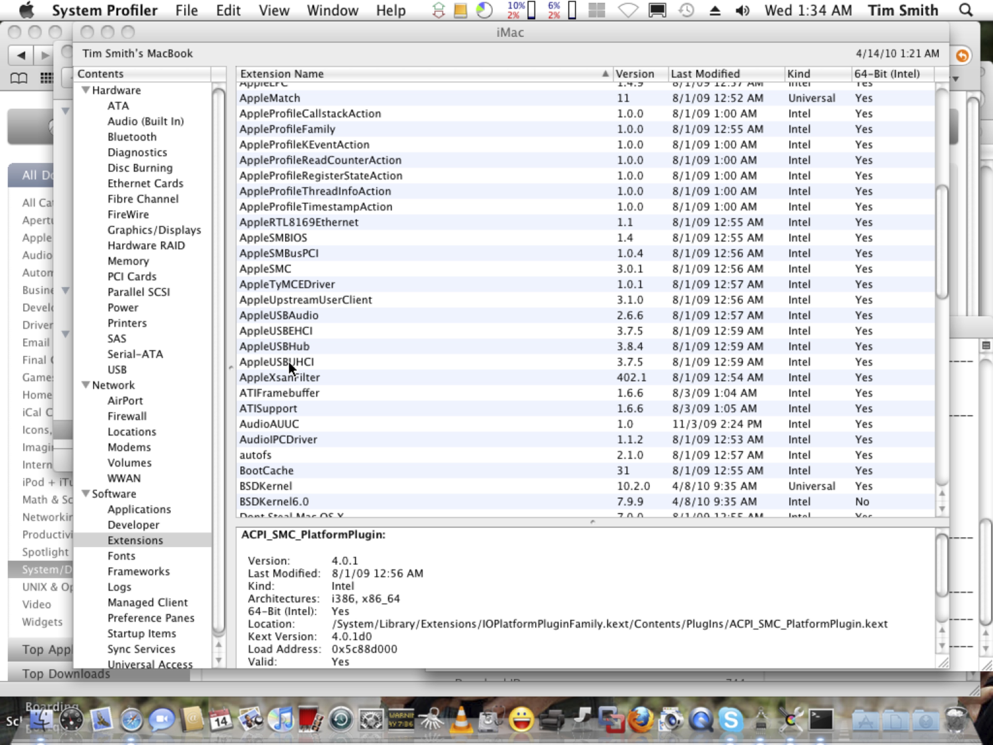

NOW NO NEED FOR PATCHING KEXTS WITH DEVICE-ID ON 10.6.3:
I present my ATI4350.Fix.kext for automatic device-id injection (good for when you have to use software update)
It works in /E/E and S/L/E
I also updated the !FORWARD! 4350 instructions

Thank you, but this is like adding the device ID in the ATI4500Controller.kext ? Do you still need a PC EFI or Chameleon boot file ? Does this solve the green apple issue ? :) thanks !
ah, i didnt make it clear. all it does currently is inject device-id, like adding it to ATI4500controller.kext.
Its just a handy thing to make your osx86 neater.
- now you wont need to re-add your device-id after updating
it doesnt solve green apple and you still need pcefi or chameleon graphics enabler or dsdt inject code
If someone could pin-point the code (its probably in one of the ati kexts info.plist)
that is causing the green apple error, then it would be possible to fix it from the ATI4350.Fix.kext
If anyone has the time they could find which kext is causing the problem by individually swapping out
10.6.3 ATI kexts for their 10.6.2 equivalents. let me know.....
but it may be something to do with GraphicsEnabler.....
