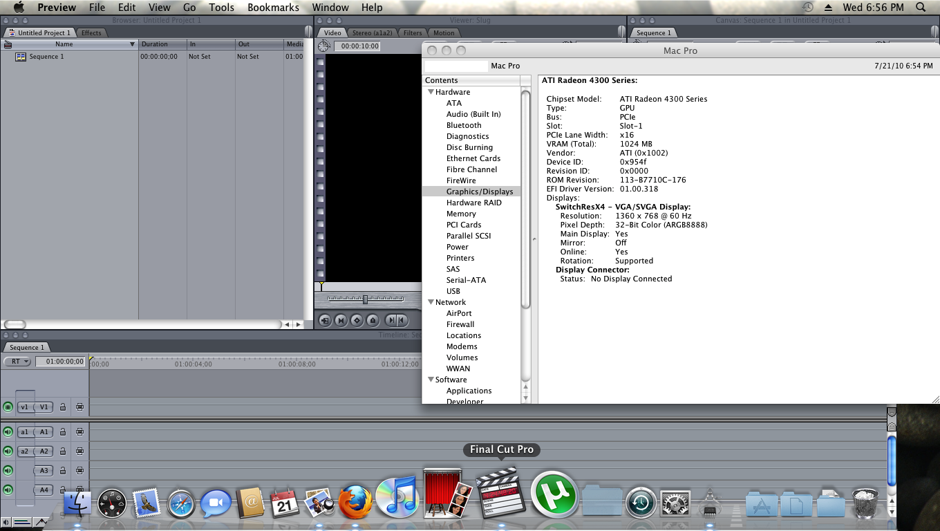

ertepechis Posted July 21, 2010 Share Posted July 21, 2010 To all those who have followed these forums i have come with a solution!!!!!!!!!! anarchintosh has come up with a way to successfully enable this card with qe/ci but i modified his explanation for more use with amd processors the technique is still the same but for some reason amd users seem to have minor difficulties with this note... this also works on intel processors this will work on both 10.6.2 or 10.6.3 pc's for proof that this method has worked for me, there is a photo attached below of my about this mac while running final cut pro in the background step 1[lets get started] If you are on 10.6.3 *Just install the ati4350.fix.kexthat is in the archive with kext utility(found at http://www.insanelymac.com/forum/index.php...t&id=69895) *kext utility can be found at http://www.insanelymac.com/forum/index.php...st&id=50182 If you are on 10.6.2 *follow instuctions for 10.6.3 but then navigate to /System/Library/Extensions using the finder. *Right click on ATIRadeonX2000.kext and select "show package contents" *Open up contents folder *Edit Info.plist using the default text editor or text wrangler(text wrangler is more recommended though and can be found at http://www.barebones.com/products/TextWrangler *Add 0x954f1002 directly after <string> which is underneath IOPCIMatch. Save file. *Move to trash /System/Library/Caches/com.apple.kext.caches (this file might not be there as it wasnt there for me but do not panic... just continue on) step 2[bOOTy butt butt] For only DVI monitors *install the Chameleon-RC3 with PC-EFI 10.6 Installer or you may use the netkas beta booter For only VGA monitors *install the Chameleon-RC4 Installer Install the bootloader to your OSX86 hdd( in my case external usb hdd) step 3[got you by the string] *navigate to and open the file /Library/Preferences/SystemConfiguration/com.apple.Boot.plist *Add an entry that looks like this to your com.apple.boot.plist(backup just in case) <key>GraphicsEnabler</key> <string>Yes</string> *anarchintosh has uploaded one AS AN EXAMPLE NOT FOR REAL USE http://www.insanelymac.com/forum/index.php...st&id=72105 *[++note++ you can use this file IF AND ONLY IF YOU ARE USING THE MACH KERNAL as i did but if not careful it may brick your machine] step 4[simple yet necessary] *navigate to /Extra/Extensions.mkext *only delete the extensions.mkext *empty trash for good measure *if it is not there as it was on my machine then do not bother with this step step 5[the finisher] *run kext utility for 5-15 minutes or until you are told by kext utility to have a good day/night *reboot you machine while praying to god *open up web browser to youtube and watch something in full screen *if and only if video seems to go at 2 fps then qe/ci has not been enabled... so move onto step 6 step 6[only if you got teabagged] *navigate back to your ATIRadeonX2000.kext(this is what enables qe/ci) wich can be found at /System/Library/Extensions *right click then show package contents *open up the folder then open up info.plist *check for imperfections(like the dev-id's not written right) *if you found imperfections then fix them *if you did not find imperfections then try installing an atiradeonx2000.kext using kext utility(but not recommended) the file can be found here(http://www.insanelymac.com/forum/index.php?act=attach&type=post&id=73831) but only install the x2000.kext and let kext utility repair permissions again *restart and pray to god once more step 7[what makes you think you're done?] *go ahead and change resolution(to test if ait4500.kext has been loaded properly) *watch a youtube video(to test if atiradeonx2000.kext was loaded proplerly) *if you cant access the internet then go to screensaver options and test the flurry screensaver *in 10.6.3 it has been reported that you get the green apple on the top left of your screen for dualscreen on this card you will need to look into the forums for efi string development(i have seen success but no url for you guys... sorry) anarchintosh has started a forum on this subject http://www.insanelymac.com/forum/index.php?showtopic=219362 Link to comment https://www.insanelymac.com/forum/topic/153495-ati-radeon-hd4350-pcie/page/7/#findComment-1516000 Share on other sites More sharing options...
