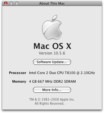

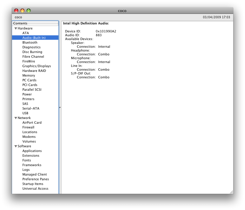

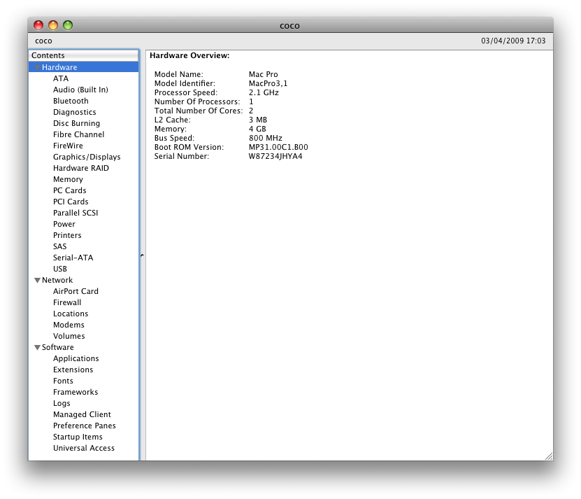

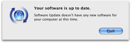

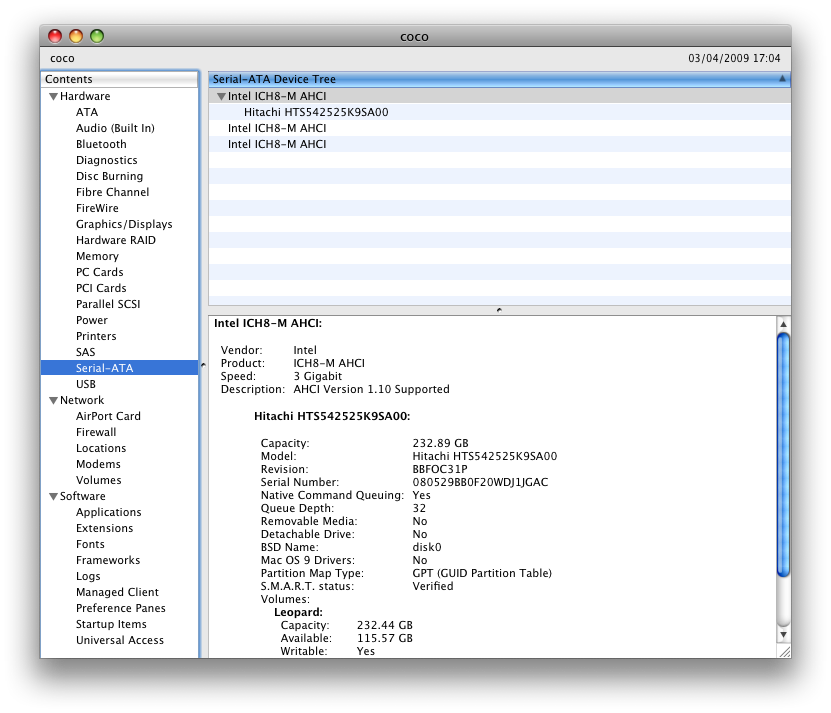

coconup Posted January 10, 2009 Share Posted January 10, 2009 Hi, I'd like to have a topic for laptops like mine that come from the same model but have a wide range of brands. What I know is that they are all produced by a warehouse called ECS and they are all called S20 or S20II in the bios. They are all 12.1" and so far these are the ones I found: - Hasee: WQ250, WQ251, WQ280, W230R, W230N and many others (all the 12.1" branded Hasee I guess) - Advent: 9212, 8112 - Haier S20 (the original layout) - maybe some Medion laptops (If you know other ones please post) pic: Apart from the fact that my WQ280 laptop, being white, looks like a MacBook, I think it has a quite good compatibility with OS X. specs: Processor Intel® Core™ 2 Duo T8100 (2.1GHz, 3MB L2 Cache, 800Mhz FSB) Chipset Intel® GM965 Memory 2GB DDR-II (I upgraded to 4) Hard Disk 250GB SATA Optical Drive DVDRW Drive Graphics Intel® GMA X3100 Screen 12.1" Glare WXGA (1280x800) Network Interface 10/100Mbps LAN Wireless Connection Intel® Pro/Wireless 3945ABG (802.11a/b/g) I/O Ports VGA out, IEEE 1394, 3 x USB2.0, Express Card 4 in 1 Card Reader Battery 4 Cells 2200mAH Dimensions (WxHxD) 296×227×26.3mm Weight 1.83KG (battery included) Others Fingerprint, Camera So far I've got everything working except fingerprint sensor and 4in1 card reader and maybe other little things I've never used. The system is stable and I can run without significant problems Adobe CS4, Logic Pro 8, Final Cut, Office and so on, I've never had problems with the software so far. The soundcard (ALC883 address 0) is working flawlessly with some Legacy kexts I made. I've got audio in and out from every port and even the digital out working with the SMBIOS values I'm using. This is what I have installed, I hope it will help somebody and that somebody could help to improve some things: - Leopard retail 10.5.6 retail with munky's efi partition method on GUID disk, Vanilla kernel and chameleon 2.0 - Extensions.zip, these are some extensions you may need: ApplePS2Controller and ACPIPS2Nub, dsmos, HDA, IOUSBMassStorageClass and IOUSBFamily by Slice, VoodooUSBEHCI. However, I now use only three kexts: HDA, dsmos and VoodooPS2Controller. I got rid of the USB kexts by deleting all the USB devices in my DSDT. In this way, all the USBs are shown as 'Expansion Slot' and not 'Built in' in system profiler and they don't break sleep. - Webcam working with Camtwist, but I hope to find a better solution... however, if you set camtwist as a startup item and you set it to automatically hide it won't be that annoying. - 2 finger scrolling with VoodooPS2Controller. - VoodooPower and VoodooBattery in /S/L/E. These have to be there since otherwise VoodooPower will use a wrong FSB. - For the wifi I replaced the built-in intel 4965 with a dell dw1490 and it works out of the box. - Sleep/Restart/Shutdown working. However, after sleep I can't restart the laptop (it stucks at S1), while shutdown works. I think this could be fixed through DSDT but I haven't succeeded yet. Strange thing: sometimes when the laptop wakes the '7' number is stuck and repeated, when this happens I can restart the laptop after sleep . - HDA enabled through DSDT. DSDT.zip What I can't get to work: - Webcam without camtwist: the webcam works also with the sonix webcam monitor, so maybe modifying sonix drivers could lead to something. look here and here - Fingerprint: I dunno why this doesn't work, since with the same product and vendor id many people don't have problems, look here - Card reader: I haven't tried much but here's a possible solution NEW 10 october: Snow Leopard So with this laptop you can upgrade to snow like you would on a macbook if you already have a retail Leopard installation on a GUID disk. All you need is HERE (boot and install CD) follow these steps to upgrade: 1) Boot in leopard and plug your snow leopard dvd in 2) double click on OS X Installation, then continue 3) the pc will reboot at some point, so plug your boot cd in and boot your install partition from it 4) the installation will go on and you'll be without trackpad at this point, but keyboard will work so there's no need to do anything except clicking the tab and space bar to go on 5) your pc will reboot again, boot your snow leopard install with the boot CD and run the /after install/install.sh (type in terminal 'cd [to the after install folder]' and then 'sudo ./install sh'). do this only if you are booting from the EFI partition, otherwise it could screw up your whole hard disk and you may lose your data. if you are booting in another way just copy the kexts from the resources/extensions folder to where they have to be. btw you may also try this other method: 1) boot in leopard 2) plug your boot cd in and run the install.sh script 3) plug the leopard DVD in and begin installation from leopard, booting without the need of the boot cd at restart this should prevent you to boot from the boot cd and you'll probably have trackpad during installation, let me know if it works Some other pics: If anybody with the same 'kind' of laptop would like to share his experience I'd appreciate, and I hope this topic will be useful, cheers NEW: Boot/Restore CD Edit 14/04: The installation script now installs VoodooPS2Controller as well and it autodetects your drive number. I also added a readme file Get it here: Boot Disk This allows you to boot the Retail DVD, install OS X and then set your EFI partition up with Chameleon 2.0 How it works: Boot the Retail DVD: Boot your laptop from the Boot CD press ENTER when it asks if you want to perform that rescan thing press f8 when you are at the boot screen swap the cd with the OS X retail DVD press ESC when the OS X retail DVD appears, just boot it After install or for restore (Boot your OS X partition): Boot your laptop from the Boot CD Press any key except from enter when it asks for the rescan thing Press any key when you are at the boot screen To set up your EFI partition after the retail installation: IMPORTANT: This script can be run only after a clean install of retail Mac OS X on a GUID partitioned disk. This means you must have re-partitioned your disk before the installation from the Mac OS X disk utility. It won't work if you are using a patched version on an MBR partitioned disk. Open terminal Type 'sudo -s' and then your password Go to the cd After Install folder (just type cd and drag the folder from finder to the terminal) Type './install.sh' Done This script will also create an Utilities folder in your home directory. Inside you'll find some useful apps and an EFI folder. When you want to change something in your EFI partition, just change the Extensions in ~Utilities/EFI/Extensions or everything else that's inside there and run ./update.sh as root (sudo -s). Please check what's inside the CD before burning it. For example, you may have to change the DSDT.aml in the cd Extra folder or the Extensions.mkext in the cd Extra/Preboot.dmg with the ones you are using. Also, you should put your DSDT.txt (decompiled) and all the kexts you are using in the After Install/EFI folder, if they are different than the ones I use (After Install/Resources/EFI/Extensions) These are the kexts that are in the CD: HDA.kext dsmos.kext VoodooPS2Controller.kext (ACPIPS2Nub and ApplePS2Controller are used for the booting from CD instead of VoodooPS2Controller) The install.sh and upload.sh script will basically build an Extensions.mkext file from what you have in your ~Utilities/EFI/Extensions folder, compile a DSDT.aml from your ~Utilities/EFI/DSDT.txt (it must be named DSDT.txt and nothing else) and put everything in your EFI partition including the ~Utilities/EFI/Themes folder and the other plists. I haven't tested the install script yet but I believe it works, still there may be some errors (just typos but I don't think there are) so try it at your own risk and please report if it works Link to comment Share on other sites More sharing options...
