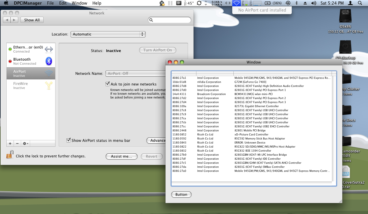

LRZRAGE Posted September 3, 2008 Share Posted September 3, 2008 All HP DV6000 users, the newest BIOS version has been patched. I had recently patched the F.58A version which is for the DV9000 series (My system) and it works flawless. Same technique used here to stop the whitelist. You can put any wireless card you would like into your system after you flash. Enjoy! For directions, please refer to my other thread .. http://forum.insanelymac.com/index.php?showtopic=120190 30BBF29.rar Link to comment Share on other sites More sharing options...

LRZRAGE Posted September 19, 2008 Author Share Posted September 19, 2008 I am working on the F.30. I have someone right now going to test a patched F.30 for an AMD system. Will post back whether it is successful or not i have a dv6810us and current bios version is F.30 i know you just posted F.29 but i'm not sure i wana take the chance of bricking my bios. i don't have a floppy drive nore can i get access to one. i would love to get wireless working with osx but i'd feel better knowing that someone has done this successfully before i make the attempt Thank you for testing grippa, greatly appreciated! I am glad it was successful! Would you like the Mac apple logo on a patched F.29 bios? Let me know, or if you have a image yourself, upload and I can add it into a patched F.29 for you. Most small jpegs will be accepted by phoenix bios edit. I am using an Atheros AR5BXB72 wifi card. In windows it is recognized as a AR5008X ... genuine apple wifi card i updated my hp compaq presario v6000 (v6182ea) with your bios, no problems (y) thanks! Link to comment Share on other sites More sharing options...

krrr Posted September 27, 2008 Share Posted September 27, 2008 when exactly to you patch? when do you get error on replacing card? i replaced my card with Dell 1490 (broadcom) and I can boot sucessfully but its not being recognized Link to comment Share on other sites More sharing options...
