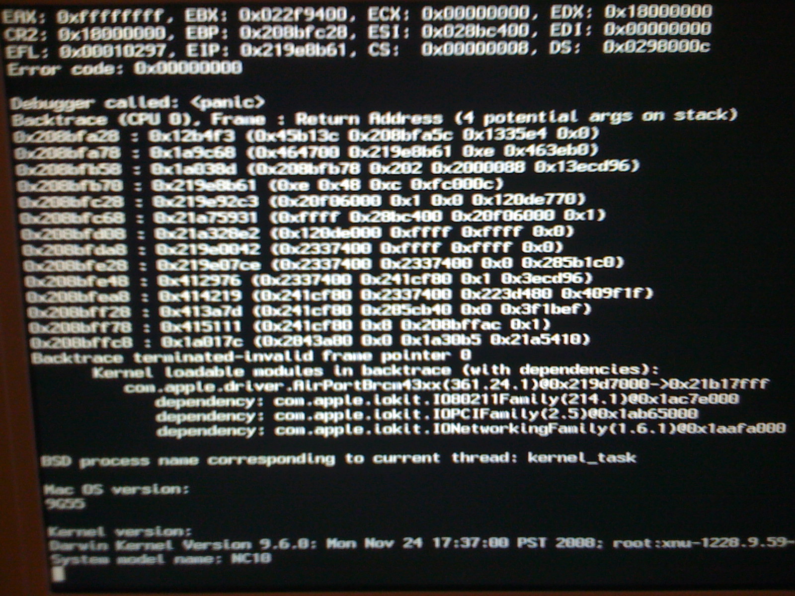

Ok, a make it rebranded, but still have error
"unable to attach hardware: HAL status 13
IO80211Controller : : stop called!
start [SourceCache/AirportDriverAtheros....loaded unsuccessfully" ( I try it on another Notebook, because of my Notebook BIOS :D ).
I do a rebrand of another Atheros WiFi card and got the same error.
After login in MAC OS X and type in terminal "lspci" it shows me that I have Network Controler Atheros ...blabla.... AR5006EG b/g [168c:001c], Apple ......blablabla.... [106b:004e] and other info.
I dont know what to do.

I did it following the guide from the first post, but whit already installed Linux-Ubuntu and working WiFi Card ( I skip the steps of installing drivers ).
After that got Error form the BIOS. Here was the beginning of the Game :unsure:, because I can't use the card with the HP notebook.
By following of another guide, I back it to the original ID's on the same notebook.
After that I try with other notebook ( MSI ) with Atheros card. Got the same same error after rebrand and loading MAC OS X.
I must say that with rebranded and no rebranded card I get the same error.
Today I make a update to 10.5.5 from SoftwareUpdate and after restart I got another error ( with no rebranded card on HP ).
There was something like:
"ath0: 0x2..."
"ath0: unable to attach the device"
and after that the other error like before.
That is for now.
Will try more this night.
See ya!!! :(

I try many things last night. No success anyway :lol:
Still the same f.....g ERROR.
I think that this is not from the driver, but from the kernel or something.
I did a research in Google and find something for FreeBSD with the same error.
The peoples there was talking about kernel extensions and HAL........ I didn't understand nothing.

I have followed the instructions for rebranding. Now lspci shows like the last step of your instructions.
Network controller
[0280]: Atheros Communications, Inc. AR5006EG ...................... [168c:001c] (rev 01)
Subsystem: Apple Computer Inc. Device [106b:004e]
I have rebooted, checked System Configuration, apple airport utility and my card still does not show up. I do get an error from console that shows:
ath_attach: devid 0x1c
unable to attach hardware; HAL status 13
I have also checked the AirportAtheros.kext and made sure that both the 168c:1c and the 106b:4e were in there. I have also tried it with only one of these. I have deleted the cache and the mkext and have repaired permissions in disk utility.
I am using an Acer Aspire One with Kalyway 10.5.2 (with updates to 10.5.5 vanilla kernel).
What is the next step?
