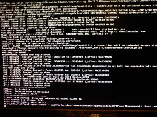

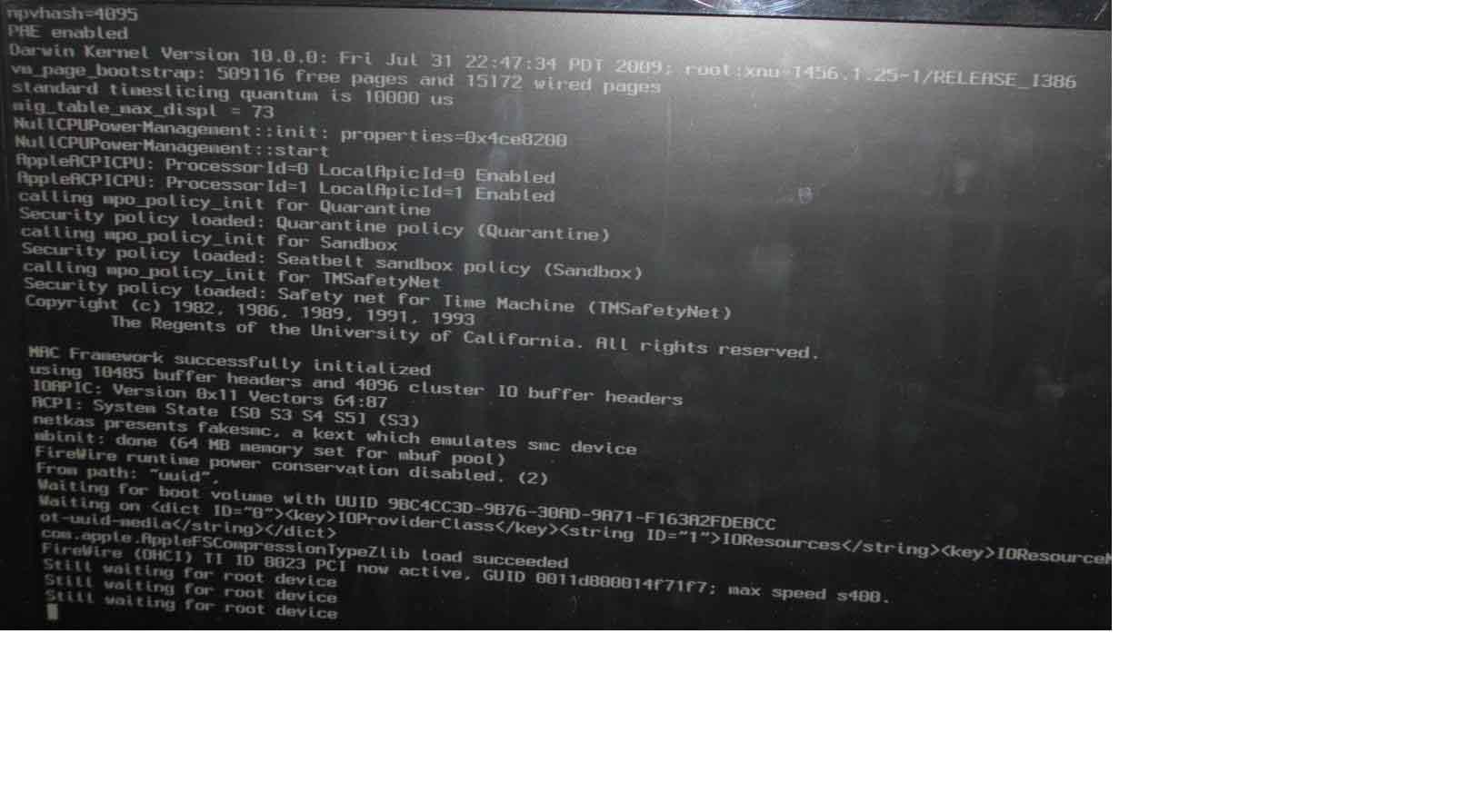

boltun Posted January 1, 2010 Share Posted January 1, 2010 getting waiting for root device, i have attached a screen shot also now i am not able to boot to my leopard drive from Chameleon window, get "cannot find mach_kernet.test" any clues ?? Link to comment https://www.insanelymac.com/forum/topic/201330-guide-how-to-install-snow-leopard-retail-on-amd-pc-osx86/#findComment-1373869 Share on other sites More sharing options...
n4p Posted January 2, 2010 Share Posted January 2, 2010 Hello! I followed your guide, but without success. Everytime i start SL i geht the message please press the reset button. Seems to be a Kernel panic. Here a screen from the problem. thanks for your help! best regards Link to comment https://www.insanelymac.com/forum/topic/201330-guide-how-to-install-snow-leopard-retail-on-amd-pc-osx86/#findComment-1374617 Share on other sites More sharing options...

hardknoxni69a Posted January 6, 2010 Author Share Posted January 6, 2010 ok if i dont respond within a day about questions plz contact me thru mail or Instant Message AIM,Google,MSN, YAhoo, whatever i may have down for contacts best way is thru my site tekmodz.webs.com would be glad to help u all -boltun if you are getting waiting for root device u are gooing to have to specify the location of ur Install so if ur Mac is on the first hard drive second partition you have to type in rd=disk0s2 just to specify where the files and what not are located i used to have to do that for my leo installation also the reason u are having difficulties reaching you leo installation is i assume that u installed thru a distro for leo and as in iatkos v7 the kernel is named custom so if u want to boot into leo chameleon by default loads mach_kernel unless otherwise specified thats why in the guide i said to go into com.apple.boot.plist to change mach_kernel to mach_kernel.test7 that way chameleon looks for the .test7 version of the kernel so.. if you would like to boot into leo just specify custom so you would type="custom rd=disk0s2" if u have any questions please message me easiest way is thru my site tekmodz.webs.com just join up thanks.. n4p- i am going to need a lil more information about your computer specs and all would help out greatly personally i have not encountered the error but if you let me know some information may be an easy fix AIM me for help or whatever ur style is check my profile i have multiple contact info be glad to help u dastan- sry bro i had a topic under my name to help u out with the video card they must have took it off for some reason but on tekmodz.webs.com my site i have the driver so that should definately help u out big time Link to comment https://www.insanelymac.com/forum/topic/201330-guide-how-to-install-snow-leopard-retail-on-amd-pc-osx86/#findComment-1377736 Share on other sites More sharing options...
