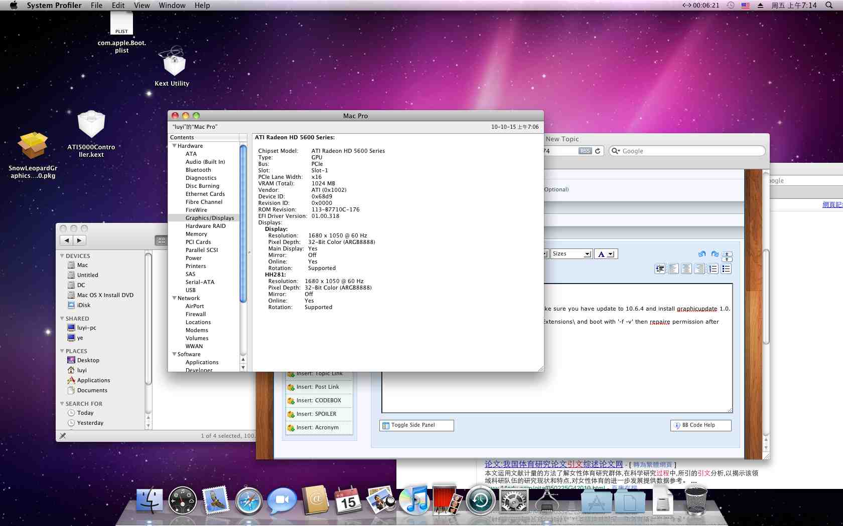

131 Posted October 15, 2010 Share Posted October 15, 2010 1. Some days ago, i got my asus hd5670 work. 2. Now, i get hd5570 work also. Boot with boothink, and snow leopard retail version, make sure you have update to 10.6.4 and install graphicupdate 1.0. place the ATY_int.kext to c:\darwin\system\Library SL\Extensions\ and boot with '-f -v' then repaire permission after you start up.(5570 hard id is 0x68d9) Also, you can install this kext by other tools. just need one kexts after install the graphicupdate1.0. Thanks to netkas and David. That's ok, have a good day! BTW: for my base system is AMD X3 435 +785G, SO I CAN NOT TEST FOR IF IT IS WORK UNDER 64 BIT. ATY_Init.kext.zip Link to comment https://www.insanelymac.com/forum/topic/234483-asus-hd5570-works-in-1064-with-qeci/ Share on other sites More sharing options...

pivy Posted October 16, 2010 Share Posted October 16, 2010 hi! sorry if i am OT but how did you get your 5670 work?? i'm trying hard but with no success... Link to comment https://www.insanelymac.com/forum/topic/234483-asus-hd5570-works-in-1064-with-qeci/#findComment-1565208 Share on other sites More sharing options...
131 Posted October 16, 2010 Author Share Posted October 16, 2010 hi! sorry if i am OT but how did you get your 5670 work?? i'm trying hard but with no success... you can search by hd5670, you need the driver from the post by netkas, it's name is hd5500/5600/5700... good luck! Link to comment https://www.insanelymac.com/forum/topic/234483-asus-hd5570-works-in-1064-with-qeci/#findComment-1565230 Share on other sites More sharing options...
FKA Posted October 16, 2010 Share Posted October 16, 2010 you can search by hd5670, you need the driver from the post by netkas, it's name is hd5500/5600/5700... good luck! or you could use Kablys boot file and GraphicsEnabler=Yes http://www.insanelymac.com/forum/index.php...=231768&hl= 64bit solution Link to comment https://www.insanelymac.com/forum/topic/234483-asus-hd5570-works-in-1064-with-qeci/#findComment-1565294 Share on other sites More sharing options...

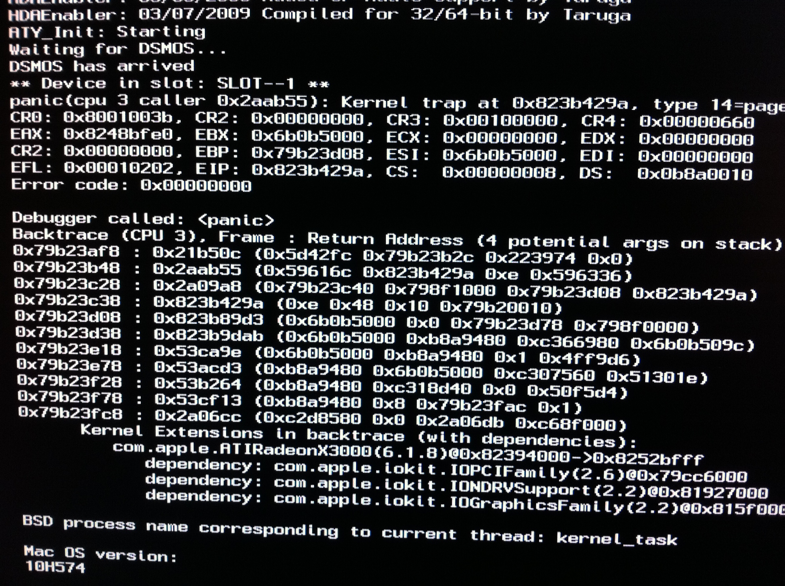

yassersh2001 Posted October 27, 2010 Share Posted October 27, 2010 plz can u help me with my xfx ati5570 1gb ddr3 i have pc with the following asus p7p55d-e lx core i3 530 2 gb ram DDr 3 1333 2 hd 500 sata 2 mac osx 10.6.3 itakos s3 ver2 and upgrade to 10.6.4 combo update installed graphics update 1.0 now i make all steps but no successes this massage appear when use -v ATY_Init: Card 0x68d9 was not posted i have add my id to ati5000 (0x68d9) and change the frame buffer to Vervet after a lot of try no panic no black screen 1 time successes to read the card as 5600 but no QE /CI or res and max memory was 256 mb Link to comment https://www.insanelymac.com/forum/topic/234483-asus-hd5570-works-in-1064-with-qeci/#findComment-1571086 Share on other sites More sharing options...
131 Posted December 3, 2010 Author Share Posted December 3, 2010 plz can u help me with my xfx ati5570 1gb ddr3 i have pc with the following asus p7p55d-e lx core i3 530 2 gb ram DDr 3 1333 2 hd 500 sata 2 mac osx 10.6.3 itakos s3 ver2 and upgrade to 10.6.4 combo update installed graphics update 1.0 now i make all steps but no successes this massage appear when use -v ATY_Init: Card 0x68d9 was not posted i have add my id to ati5000 (0x68d9) and change the frame buffer to Vervet after a lot of try no panic no black screen 1 time successes to read the card as 5600 but no QE /CI or res and max memory was 256 mb Sorry for late. I am busy for my new shop in suzhou. After you install the kext, you need boot with -s and input fsck -f -y for repair disk permission, i got the same problem as you before fix disk permission, after that, i got it work. Link to comment https://www.insanelymac.com/forum/topic/234483-asus-hd5570-works-in-1064-with-qeci/#findComment-1595722 Share on other sites More sharing options...

m600kf Posted January 3, 2011 Share Posted January 3, 2011 Sorry for late. I am busy for my new shop in suzhou. After you install the kext, you need boot with -s and input fsck -f -y for repair disk permission, i got the same problem as you before fix disk permission, after that, i got it work. thank u,i got it work。 snow leopard just recognized 5600series before i tried -s,and i input exit。Then,done(SAPPHIRE 5570) Link to comment https://www.insanelymac.com/forum/topic/234483-asus-hd5570-works-in-1064-with-qeci/#findComment-1613751 Share on other sites More sharing options...
m600kf Posted January 3, 2011 Share Posted January 3, 2011 thank u first,it works with qe/ci through hdmi。 x3 435 770c45 SAPPHIRE 5570 1G 5570g3.tiff Link to comment https://www.insanelymac.com/forum/topic/234483-asus-hd5570-works-in-1064-with-qeci/#findComment-1613782 Share on other sites More sharing options...
