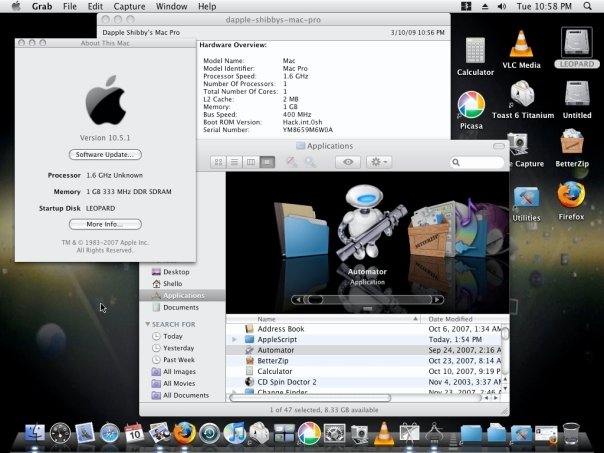

DappleBook Posted March 11, 2009 Share Posted March 11, 2009 Anybody? It would be really appreciated. Hi. Fwiw, I tried the same flavor of iDeneb and couldn't get it to work on my 700M. Got the Kalyway 10.5.1 and followed the instructions at the beginning of this thread and the lappy does a dual boot with XP perfectly. You may want to save yourself a headache and give it a shot. Oh, and I did the combo updates to 10.5.2 and 10.5.3 which broke the ethernet so I'd recommend sticking with the 10.5.1. Maybe not what you wanted to hear but hope that helps! Link to comment https://www.insanelymac.com/forum/topic/89638-leopard-on-dell-700m-for-dummies-dual-boot-with-xp-and-shared-partition/page/2/#findComment-1103934 Share on other sites More sharing options...

DappleBook Posted March 11, 2009 Share Posted March 11, 2009 Hi I tried about 5 of them before I found this thread. kalyway 10.5.1 was the only one I could get to work unfortunately. My 700M has almost identical specs to yours so I know it works. You must follow the instructions at the beginning of this thread exactly. I stopped searching when I found this thread so I can't say I've read about anyone getting a successful install on a 700M with any other version other than the kalyway 10.5.1. Give it a try and remember, follow instructions exact and you should be golden. I appreciate the reply DappleBook.I tried kalyway 10.5.2 and that still did not work. Have you read anyone getting that version to work? Because I would really like not having to download a burn a third DVD. I got some error saying bug! then a bunch of numbers with kalyway 10.5.2 as well. Link to comment https://www.insanelymac.com/forum/topic/89638-leopard-on-dell-700m-for-dummies-dual-boot-with-xp-and-shared-partition/page/2/#findComment-1103950 Share on other sites More sharing options...

DappleBook Posted March 11, 2009 Share Posted March 11, 2009 Thanks. Will give a try. Ill come back with hopefully good news.Are you still dual booting OSX? Any other problems besides SD reader, screen resolution, wireless? Yes. Dual booting with Windows XP Pro. Have had a couple other minor issues in addition to some of the ones you've mentioned - such as, sometimes when booting into OSX after having used XP, I have to get it to re-detect ethernet. It doesn't happen every time though. iCal starts briefly then quits - found a work around on the net, go to info and tick the box for rosetta. If the laptop goes into sleep mode it freezes and I have to push the power button and shut it off. I turned off the sleep function since I don't use it but it still seems to drop into a sleep if unactive for a period. Boot time is much slower on battery power. These are off the top of my head. If you read through this whole thread you may find other things mentioned. The OSX is very usable on this laptop and I'm pleased with it. Can live with the little annoying issues for now. WIRELESS! I got the wireless working this morning (3-12-09). Only problem with it is that it doesn't auto reconnect upon a reboot. (Mine has the intel bg 2200 wireless). Reselecting the power on in the network selector (which is a new control panel included with the drivers) brings it back up again but still requires having to type in the WEP key each time you log back in. Other than those minor issues, I'm thrilled with my newly configured "DappleBook" as I call it. :-) Wireless Drivers and installation info link here: http://code.google.com/p/iwidarwin/wiki/Installation Link to comment https://www.insanelymac.com/forum/topic/89638-leopard-on-dell-700m-for-dummies-dual-boot-with-xp-and-shared-partition/page/2/#findComment-1104704 Share on other sites More sharing options...

DappleBook Posted March 13, 2009 Share Posted March 13, 2009 Butterfingarz, please re-read my post # 27 in this thread. If you want this to work you must pay attention to the details... I'd suggest printing out the steps in the first post to make it easier. G'luck! Link to comment https://www.insanelymac.com/forum/topic/89638-leopard-on-dell-700m-for-dummies-dual-boot-with-xp-and-shared-partition/page/2/#findComment-1105747 Share on other sites More sharing options...

DappleBook Posted March 19, 2009 Share Posted March 19, 2009 Yeah I know my disk stopped spinning a few times too. I just wiggled the mouse or hit the enter key on the keyboard. Leave the disk in the drive and try that. It won't load correctly if it's not installed fully. It does take a long time from start to finish - I'd say at least an hour. Like the tutorial says, leave the disk in the drive after it reboots. Only thing we may different in the equation is the installation disk. I found that if I burned the disk with Nero I sometimes had problems with the install. Burned the iso's with Magic Iso and zero troubles. Thought that may be worth mentioning. If all else fails you might need to use some of the commands to boot which are discussed throughout this thread. I don't know anything about that stuff but I do know kalyway 10.5.1 works a treat with the 700M. Ok tried kalyway 10.5.1 tonight and got to install about 98% then the CD drive stopped spinning and stay there until I had to force turn off it. Follow all the instructions at the beginning of this forum and the wiki pages. Also the iso does not load darwin correctly sometimes and I got it to load to the installation screen only on the third time. Link to comment https://www.insanelymac.com/forum/topic/89638-leopard-on-dell-700m-for-dummies-dual-boot-with-xp-and-shared-partition/page/2/#findComment-1110751 Share on other sites More sharing options...

butterfingarz Posted March 22, 2009 Share Posted March 22, 2009 Im typing up the post on my newly installed hackintosh. Thanks for the help of this site and the OSX86 project and also dapplebook. Question how do I get into info to get iCal to work? I will try the wifi as well. Also I know I should not update to 10.5.6 but can I update programs such as iTunes, Quicktime, Airport utility. ect? I know HFS+ can read but not write to my NTFS XP partition but should I be able to share my iTunes music? I cannot play any of my music. Ok got music to play just need to change settings I'm sure inside itunes to share them. On playback the songs get distorted I'm guessing I need a better driver? Anyone know where I can get that? Link to comment https://www.insanelymac.com/forum/topic/89638-leopard-on-dell-700m-for-dummies-dual-boot-with-xp-and-shared-partition/page/2/#findComment-1112590 Share on other sites More sharing options...

DappleBook Posted March 23, 2009 Share Posted March 23, 2009 Awesome! Glad to hear you got it going. iCal - right click on the ical icon in the dock and choose open in finder. From there you can right click get info and tick rosetta. the wifi: download and install the iwidarwin drivers for the bg 2200. Tip: I always have to turn off then turn on the network selector before it sees any wifi network. Works great for me. Even printing to a wireless printer with it. I updated itunes, quicktime, and the airport utility via straight downloads from the apple website. I was too chicken to use the software update because I wasn't sure if it would break anything. Enjoy your new dual boot system! Im typing up the post on my newly installed hackintosh. Thanks for the help of this site and the OSX86 project and also dapplebook. Question how do I get into info to get iCal to work? I will try the wifi as well. Also I know I should not update to 10.5.6 but can I update programs such as iTunes, Quicktime, Airport utility. ect? I know HFS+ can read but not write to my NTFS XP partition but should I be able to share my iTunes music? I cannot play any of my music. Ok got music to play just need to change settings I'm sure inside itunes to share them. On playback the songs get distorted I'm guessing I need a better driver? Anyone know where I can get that? Link to comment https://www.insanelymac.com/forum/topic/89638-leopard-on-dell-700m-for-dummies-dual-boot-with-xp-and-shared-partition/page/2/#findComment-1113304 Share on other sites More sharing options...
