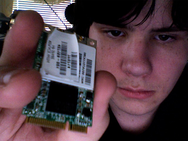

creepyteletuby Posted May 9, 2007 Share Posted May 9, 2007 Hi, i tried your instructions and followed them bit for bit untill the first reboot. Now i get stuck in a never ending boot screen (white with apple) and I cant boot into OSX. Any suggestions? p.s I might just want to buy a different wireless card. can anybody tell me where to get an Atheros wireless card that will fit in my socket? it should look like this one (see pic) Link to comment https://www.insanelymac.com/forum/topic/8522-howto-broadcom-wireless-cards-in-1043/page/2/#findComment-362447 Share on other sites More sharing options...
