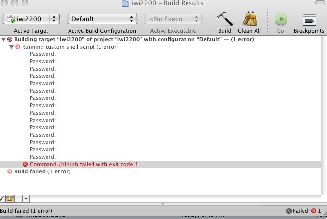

FurmanSK Posted April 17, 2008 Share Posted April 17, 2008 Alright did that Jalavoui and got this error in the pic i uploaded. Weird i know. Link to comment https://www.insanelymac.com/forum/topic/84072-intel-wireless-2100-2200bg-2915bg-3945abg-4965agn/page/42/#findComment-713386 Share on other sites More sharing options...

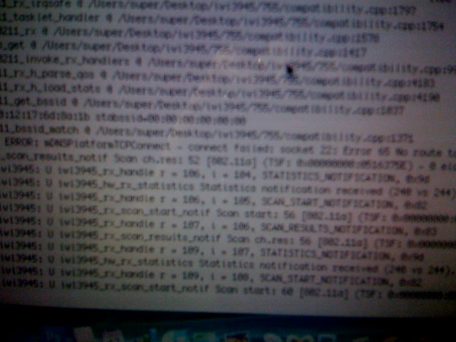

mlazy Posted April 18, 2008 Share Posted April 18, 2008 Hello all I fixed the code, (simple error, I am no developer) compiled and here's 755 for testing. iwi3945R755.kext.zip networkSelector.zip Here are my logs for it: 755syslog.txt and running netselector gave an immediate freeze, but got a screenshot of it scanning: night all... Link to comment https://www.insanelymac.com/forum/topic/84072-intel-wireless-2100-2200bg-2915bg-3945abg-4965agn/page/42/#findComment-713465 Share on other sites More sharing options...

FurmanSK Posted April 18, 2008 Share Posted April 18, 2008 Alright jalavoui i just left the old .dmg file in there and built it and it worked but idk if it updated anything so i tried to manually load the kext files but i dont know where they all go. And when i did this it didn't load the file. I got some logs and stuff but i think its from when it loaded. Did i load it wrong? Cause now its not wanting to load at all. Ah pisses me off dam apple. lol Link to comment https://www.insanelymac.com/forum/topic/84072-intel-wireless-2100-2200bg-2915bg-3945abg-4965agn/page/42/#findComment-713617 Share on other sites More sharing options...

jalavoui Posted April 18, 2008 Author Share Posted April 18, 2008 you should all thank mlazy for making a working version of iwi3945 - amazing iosleep make the driver load without errors! FurmanSK, if you build iwi2200.dmg right and it doesn't install what's the error? iwi3945 rel 756 station scan - leave networkselelctor alone is there any way to test this in -s or -v and make os x to auto load it? this will help cause it will allow to see the panic log Link to comment https://www.insanelymac.com/forum/topic/84072-intel-wireless-2100-2200bg-2915bg-3945abg-4965agn/page/42/#findComment-713943 Share on other sites More sharing options...

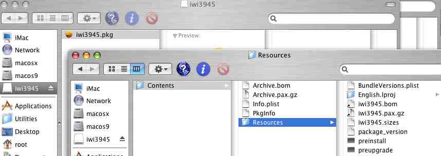

jalavoui Posted April 18, 2008 Author Share Posted April 18, 2008 iwi3945.dmg build check if you get this this is the new script unzip it in iwi3945 main folder open the terminal -> cd to iwi3945 folder (check my console_log) sudo sh dmg.sh to call it if the dmg build ok open it right click on iwi3945.pkg to see the contents you should get a picture like this one to instal the driver: double click on iwi3945.pkg - this will call the installer the iwi3945.dmg is about 592K it just like to say that you don't need this if: you delete iwi3945.dmg and press build in xcode it should do the same as in this script maybe the problem is somewhere else (check iwi3945.pmproj - might need to be saved to work in mac os x 10.5 format) anyway - try this script and copy paste what you get in console well - i'm doing this in a genuine macintosh computer dmg.sh.zip console_log.txt Link to comment https://www.insanelymac.com/forum/topic/84072-intel-wireless-2100-2200bg-2915bg-3945abg-4965agn/page/42/#findComment-713966 Share on other sites More sharing options...

mlazy Posted April 18, 2008 Share Posted April 18, 2008 Jalavoui,Here is the output of your script.. seems to be a problem with the dmg build at the end. It's the same problem I had with you pkg script which is why I made my own a while back. I think it's a 10.4 vs. 10.5 thing. SOMEONE send him a mac that can run 10.5! (where are you located anyway?) ERROR: Could not copy resources to "English.lproj".hdiutil: create failed - No such file or directory dmgshlog.txt build 756 for testing: iwi3945r756.kext.zip networkSelector.zip 756 logs: (Looking incredible; treid a scan, got "scan already in progress") 756syslog.txt Link to comment https://www.insanelymac.com/forum/topic/84072-intel-wireless-2100-2200bg-2915bg-3945abg-4965agn/page/42/#findComment-714006 Share on other sites More sharing options...
MikeMax Posted April 18, 2008 Share Posted April 18, 2008 Jalavoui, Here is the output of your script.. seems to be a problem with the dmg build at the end. It's the same problem I had with you pkg script which is why I made my own a while back. ERROR: Could not copy resources to "English.lproj". hdiutil: create failed - No such file or directory dmgshlog.txt i have the same issue with the dmg script. The xcode build doesn't provide me a DMG file although it builds perfectly without errors. Trying to move the built kext to extensions(but it seems xcode automatically put it during the build), reboot >>> KP just after logged XD i will try to get some logs wuith getlogs command Link to comment https://www.insanelymac.com/forum/topic/84072-intel-wireless-2100-2200bg-2915bg-3945abg-4965agn/page/42/#findComment-714011 Share on other sites More sharing options...

mlazy Posted April 18, 2008 Share Posted April 18, 2008 Jalavoui,Here is the output of your script.. seems to be a problem with the dmg build at the end. It's the same problem I had with you pkg script which is why I made my own a while back. I think it's a 10.4 vs. 10.5 thing. SOMEONE send him a mac that can run 10.5! (where are you located anyway?) ERROR: Could not copy resources to "English.lproj".hdiutil: create failed - No such file or directory dmgshlog.txt build 756 for testing: iwi3945r756.kext.zip networkSelector.zip 756 logs: (Looking incredible; treid a scan, got "scan already in progress") 756syslog.txt Jalavoui: IMPORTANT! I booted with -x to get these log results. The driver loads, has just a few lines, and then waits. When I do a full boot and kextload manually I get tons of logs. Is something interfering with the driver? Safe boot (-x) loads OS only (kinda like 10.4's -s with /sh command. Link to comment https://www.insanelymac.com/forum/topic/84072-intel-wireless-2100-2200bg-2915bg-3945abg-4965agn/page/42/#findComment-714119 Share on other sites More sharing options...
