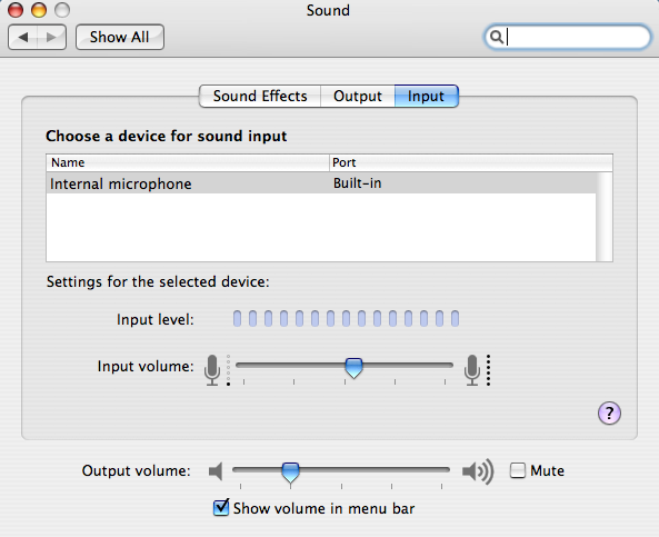

maverick_pranav Posted January 29, 2008 Share Posted January 29, 2008 hi!...remember to remove appleazalia.kext...it works with that removed!... works for me in iatkos and tiger...(only tested in those)... also.. mic did work but lots of noise that was suppressing the sound out!..so edited and remove the support for that!. subsystem id is :104d1500 if it still doesnt work then try to get a cedec dump your very own card as the problem would lie in the pinconfigution!.. just change that and it should luck!... Link to comment https://www.insanelymac.com/forum/topic/83633-ladies-and-lads-i-would-like-to-introduce-to-you-a-functioning-alc262-driver/page/2/#findComment-599334 Share on other sites More sharing options...

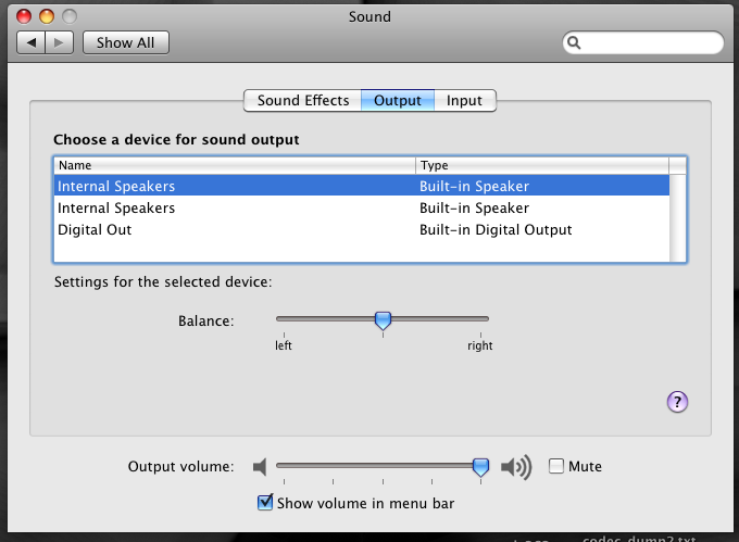

BossmanPL Posted January 30, 2008 Share Posted January 30, 2008 Here are the new kext drivers I promised you all. Try them out and let me know how things work out. thx mate i will try them bronxboyXXX but since my dump got DigitalOut working i wonder where could be a problem, why should we replace AppleHDA.kext and ALCinject.kext - isnt Torqua Patcher making theem? Link to comment https://www.insanelymac.com/forum/topic/83633-ladies-and-lads-i-would-like-to-introduce-to-you-a-functioning-alc262-driver/page/2/#findComment-600193 Share on other sites More sharing options...
bronxboyXXX Posted January 30, 2008 Author Share Posted January 30, 2008 thx mate i will try them bronxboyXXXbut since my dump got DigitalOut working i wonder where could be a problem, why should we replace AppleHDA.kext and ALCinject.kext - isnt Torqua Patcher making theem? i just gave them a shot and i have a driver ready for you. whats weird is that i have headphone & support for 2 internal speakers but I must choose the one i want manually in order for sound to work plus there was no Mic however my file may fix that 4 you. you don't need to replace the ALCinject.kext file in this case. just AppleHDA.kext because thats the file i modified 262_200.zip Link to comment https://www.insanelymac.com/forum/topic/83633-ladies-and-lads-i-would-like-to-introduce-to-you-a-functioning-alc262-driver/page/2/#findComment-600202 Share on other sites More sharing options...

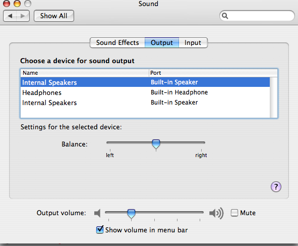

BossmanPL Posted January 30, 2008 Share Posted January 30, 2008 bronxboyXXX - Thanks, but it seems i got bad karma or some curse over me, No sound, No Mic working (3bars sometimes blink in input, but thats just not mic), swiching between 2speakers no one works. Headphone jack olso do not work. What else could be wrong? Link to comment https://www.insanelymac.com/forum/topic/83633-ladies-and-lads-i-would-like-to-introduce-to-you-a-functioning-alc262-driver/page/2/#findComment-600241 Share on other sites More sharing options...
bronxboyXXX Posted January 30, 2008 Author Share Posted January 30, 2008 bronxboyXXX - Thanks, but it seems i got bad karma or some curse over me, No sound, No Mic working (3bars sometimes blink in input, but thats just not mic), swiching between 2speakers no one works. Headphone jack olso do not work. What else could be wrong? just one sec.. I'm going to test something okay I just installed it and it worked. you probably messed up on the instillation. as for the audio are you hi-lighting the first instance of internal speakers? first delete your AppleHDA.kext file then open up the terminal window and type in sudo -s "enter" your password "enter" copy and paste this in the next 3 lines cd /System/Library/Extensions chown -R root:wheel AppleHDA.kext chmod -R 755 AppleHDA.kext "enter" now navigate to /System/Library/ and delete Extensions.kextcache & Extensions.mkext (if this is lepard you will only see one). now reboot if this is not leopard if it is go into disk utility and repair permissions and then reboot. Link to comment https://www.insanelymac.com/forum/topic/83633-ladies-and-lads-i-would-like-to-introduce-to-you-a-functioning-alc262-driver/page/2/#findComment-600247 Share on other sites More sharing options...
BossmanPL Posted January 30, 2008 Share Posted January 30, 2008 just one sec.. I'm going to test something okay I just installed it and it worked. you probably messed up on the instillation. as for the audio are you hi-lighting the first instance of internal speakers? Dong! As you can see in my signature i got two cards inside i did test something I turned off ALC262 in Vista and my mp3 was playing !!!!! I turned off SigmaTel card and there was no sound !!!! What the hell theen? I do need to use SigmaTel driver for sound theen? Why theen 2 Sound cards in Vaio?, Meaby ALC262 is only for Digital OUT? omg i am confused ! now how to try dump Sigmatel zzzz Link to comment https://www.insanelymac.com/forum/topic/83633-ladies-and-lads-i-would-like-to-introduce-to-you-a-functioning-alc262-driver/page/2/#findComment-600277 Share on other sites More sharing options...

BossmanPL Posted January 30, 2008 Share Posted January 30, 2008 could be. but its working for me so you should at the very least have the card being recognized with my driver installed. I did just dump sigmatel !!!!! And it has adress 0 - So it looks like i have 2 sound cards, Now got question, did you changed adress in 262_200dump to 0 ?, i mean kext you generated for me got adress 0 or same as my original dump file?, do you want me to post Sigmatell dump there meaby?. Can you tell me how do you make Kext, do you use Torqua patch or something else?, what mean Detected unsupported ***** Codec? Link to comment https://www.insanelymac.com/forum/topic/83633-ladies-and-lads-i-would-like-to-introduce-to-you-a-functioning-alc262-driver/page/2/#findComment-600316 Share on other sites More sharing options...
bronxboyXXX Posted January 30, 2008 Author Share Posted January 30, 2008 no all i did was add the mic gain parameters and activate its pins. In any case the one I sent you is working but its possible you will need a second driver installed as well because there is no way you can have the same driver for two different chips or chipsets. From what i can tell using this driver is the reason you seem to have two internal speakers is because one actually is an internal speaker and the other is the digital output which in my case is not working. (BTW) How do you get a screen shot off a Mac? i want to show you what my system looks like using this driver. wow I'm looking at this from every angle it's just driving me more & more nuts. PS.. its not a bad sounding driver!.... I'm rather impressed. Update: F00 still sounds better to me pss everything goes down in the AppleHDA.kext in a file called info.plist. there you can change the pins, mic gain and amp gain. Link to comment https://www.insanelymac.com/forum/topic/83633-ladies-and-lads-i-would-like-to-introduce-to-you-a-functioning-alc262-driver/page/2/#findComment-600332 Share on other sites More sharing options...

bronxboyXXX Posted February 1, 2008 Author Share Posted February 1, 2008 I need 262_510 dump...Try one of the other dumps.I'm very content with 262_f00 with my 262_600 sound card. Got an update on my track pad progress. fixed the stuttering problem. it has something to do with the way the ALPS Glidepad Driver.pkg was put together. basically. the problem is some of us need to remove the ApplePS2Trackpad.kext from within your ApplePS2Controller.kext because it causes our keyboards to display a memory leak. (delayed response, repeating keys). To the ones experiencing this you will notice an instant speed boost when you load this driver. This is still just a beta but it should give you a good. idea what I'm talking about. for me circular scrolling & tapping are working but i can't seem to find out how to lower the speed yet. I still have a long way to go & I want this baby to be perfect. 1'st back up ApplePS2Controller.kext and ApplePS2Trackpad.kext located in your System/Library/Extensions folder 2nd extract my files and place them into System/Library/Extensions 3rd open the terminal window and type in sudo -s "enter" *your password* "enter" cd /System/Library/Extensions "enter" chown -R root:wheel ApplePS2Controller.kext "enter" chmod -R 755 ApplePS2Controller.kext "enter" chown -R root:wheel ApplePS2Mouse.kext "enter" chmod -R 755 ApplePS2Mouse.kext "enter" chown -R root:wheel ApplePS2Trackpad.kext "enter" chmod -R 755 ApplePS2Trackpad.kext "enter" 4th go to system/Library and delete Extensions.kextcache & Extensions.mkext 5th (leopard users) go to disk utilities repair permissions. 6th reboot twice just to be sure its working. trackpad_beta.zip Link to comment https://www.insanelymac.com/forum/topic/83633-ladies-and-lads-i-would-like-to-introduce-to-you-a-functioning-alc262-driver/page/2/#findComment-603406 Share on other sites More sharing options...
starimage Posted February 1, 2008 Share Posted February 1, 2008 can not make dump from knoppix on my Samsung Q 45 262_510 Other 262*** dumps nice - but microphone did not work Link to comment https://www.insanelymac.com/forum/topic/83633-ladies-and-lads-i-would-like-to-introduce-to-you-a-functioning-alc262-driver/page/2/#findComment-603606 Share on other sites More sharing options...
bronxboyXXX Posted February 1, 2008 Author Share Posted February 1, 2008 can not make dump from knoppix on my Samsung Q 45262_510 Other 262*** dumps nice - but microphone did not work this is the code that makes everything work on my system the active pins are hi-lighted in red <?xml version="1.0" encoding="UTF-8"?> <!DOCTYPE plist PUBLIC "-//Apple Computer//DTD PLIST 1.0//EN" "http://www.apple.com/DTDs/PropertyList-1.0.dtd"> <plist version="1.0"> <!-- Patched by Taruga's AppleHDA Patcher v1.20 --> <dict> <key>CFBundleDevelopmentRegion</key> <string>English</string> <key>CFBundleExecutable</key> <string>AppleHDA</string> <key>CFBundleGetInfoString</key> <string>1.4.0a22, Copyright Apple Inc. 2005-2007</string> <key>CFBundleIdentifier</key> <string>com.apple.driver.AppleHDA</string> <key>CFBundleInfoDictionaryVersion</key> <string>6.0</string> <key>CFBundleName</key> <string>Apple HDA Driver</string> <key>CFBundlePackageType</key> <string>KEXT</string> <key>CFBundleShortVersionString</key> <string>1.4.0</string> <key>CFBundleSignature</key> <string>????</string> <key>CFBundleVersion</key> <string>1.4.0a23</string> <key>IOKitPersonalities</key> <dict> <key>HDA Driver</key> <dict> <key>CFBundleIdentifier</key> <string>com.apple.driver.AppleHDA</string> <key>CodecInfo</key> <array> <dict> <key>AnalogOut</key> <dict> <key>SignalProcessing</key> <dict> <key>Volume</key> <dict> <key>SoftwareVolume</key> <dict/> </dict> </dict> </dict> <key>CodecID</key> <integer>283902562</integer> <key>ForceWakeToIdle</key> <true/> </dict> </array> <key>IOClass</key> <string>AppleHDADriver</string> <key>IOProviderClass</key> <string>AppleHDACodec</string> <key>InputSampleLatency</key> <integer>30</integer> <!-- Realtek --> <key>Layouts</key> <array> <dict> <key>LayoutID</key> <integer>12</integer> <key>PathMapRef</key> <array> <dict> <key>CodecID</key> <array> <integer>283902562</integer> </array> <key>Headphone</key> <dict> <key>AmpPostDelay</key> <integer>150</integer> <key>AmpPreDelay</key> <integer>150</integer> </dict> <key>Inputs</key> <array> <string>LineIn</string> <string>Mic</string> <string>SPDIFIn</string> </array> <key>IntSpeaker</key> <dict> <key>AmpPostDelay</key> <integer>150</integer> <key>AmpPreDelay</key> <integer>150</integer> <key>MaximumBootBeepValue</key> <integer>64</integer> </dict> <key>LineIn</key> <dict/> <key>LineOut</key> <dict> <key>AmpPostDelay</key> <integer>150</integer> <key>AmpPreDelay</key> <integer>150</integer> </dict> <key>Mic</key> <dict> <key>SignalProcessing</key> <dict> <key>SoftwareDSP</key> <dict> <key>Equalization</key> <dict> <key>Filter0</key> <dict> <key>FilterType</key> <integer>1752195443</integer> <key>Frequency</key> <data> waTDQg== </data> <key>Gain</key> <data> AACAQA== </data> <key>Q</key> <data> 8wQ1Pw== </data> <key>index</key> <integer>0</integer> <key>runInSoftware</key> <true/> </dict> <key>Filter1</key> <dict> <key>FilterType</key> <integer>1752195443</integer> <key>Frequency</key> <data> A5OOQg== </data> <key>Gain</key> <data> AABkQQ== </data> <key>Q</key> <data> qzstPw== </data> <key>index</key> <integer>1</integer> <key>runInSoftware</key> <true/> </dict> <key>Filter2</key> <dict> <key>FilterType</key> <integer>1651664234</integer> <key>Frequency</key> <data> AADwQg== </data> <key>Gain</key> <data> AAAEwQ== </data> <key>Q</key> <data> AICXQQ== </data> <key>index</key> <integer>2</integer> <key>runInSoftware</key> <true/> </dict> <key>Filter3</key> <dict> <key>FilterType</key> <integer>1885434465</integer> <key>Frequency</key> <data> K8M3Qw== </data> <key>Gain</key> <data> AADQvw== </data> <key>Q</key> <data> WPsGQQ== </data> <key>index</key> <integer>3</integer> <key>runInSoftware</key> <true/> </dict> <key>Filter4</key> <dict> <key>FilterType</key> <integer>1885434465</integer> <key>Frequency</key> <data> CkyWQw== </data> <key>Gain</key> <data> AACQvw== </data> <key>Q</key> <data> MzPTQA== </data> <key>index</key> <integer>4</integer> <key>runInSoftware</key> <true/> </dict> <key>Filter5</key> <dict> <key>FilterType</key> <integer>1885434465</integer> <key>Frequency</key> <data> M3z7Qw== </data> <key>Gain</key> <data> AADQvw== </data> <key>Q</key> <data> izanQA== </data> <key>index</key> <integer>5</integer> <key>runInSoftware</key> <true/> </dict> <key>Filter6</key> <dict> <key>FilterType</key> <integer>1885434465</integer> <key>Frequency</key> <data> Gb5IRA== </data> <key>Gain</key> <data> AAAIwA== </data> <key>Q</key> <data> 6fbYQA== </data> <key>index</key> <integer>6</integer> <key>runInSoftware</key> <true/> </dict> <key>Filter7</key> <dict> <key>FilterType</key> <integer>1885434465</integer> <key>Frequency</key> <data> Xj96RA== </data> <key>Gain</key> <data> AADgvw== </data> <key>Q</key> <data> etMvQQ== </data> <key>index</key> <integer>7</integer> <key>runInSoftware</key> <true/> </dict> <key>Filter8</key> <dict> <key>FilterType</key> <integer>1885434465</integer> <key>Frequency</key> <data> rx+WRA== </data> <key>Gain</key> <data> AACQvw== </data> <key>Q</key> <data> +qRXQQ== </data> <key>index</key> <integer>8</integer> <key>runInSoftware</key> <true/> </dict> <key>Filter9</key> <dict> <key>FilterType</key> <integer>1819304307</integer> <key>Frequency</key> <data> RlSQRg== </data> <key>Gain</key> <data> AnaUvw== </data> <key>Q</key> <data> 8wQ1Pw== </data> <key>index</key> <integer>15</integer> <key>runInSoftware</key> <true/> </dict> </dict> <key>GainStage</key> <dict> <key>LeftGain</key> <data> wmJKQA== </data> <key>RightGain</key> <data> wmJKQA== </data> </dict> <key>NoiseCanceller</key> <dict> <key>NoiseProfile</key> <data> Lv9xwm3IWsLU s3bCqn2IwlYK jMIO847CznGP wvb1kcLc85fC /iGcwnobn8LA mqHC5S2kwoh+ p8IjBKnCpL2q wkCZrMKQoa7C JH2xwhMBtMIr PrbC+EW4wjqc usIWq7rCuA25 whaEuMKuP7rC VoO6wiPZucKv mrfC4Gq1wvqO tcI+u7bCYli2 wnHRtcIEq7TC 8l6zwuX7s8Ku y7TCRP6zwsOM s8K7QbPCoWi1 wouutcJkKrTC P3W0wvp8t8Ll xLnCqou6wgYj usIDOLnCjJm6 wo5+vMKx5rzC dpm9wvNnvsJ+ mbzCoHO8wsQC vMI6w7vCSM+7 wh9uvsJ2Ar7C DqO8wjASvsLO vL3CpAS9wlLg vsJkd77ClnG+ wvD/wMIYfL/C +O7AwjkKw8Jy osHCdXy9wuYX wMICPMHCmQ3A wtrWvcKXZbzC rxq8wuAavcKi crzCxPa7wp75 u8LUQLvCJje8 wlPxvcI+7L7C AEjAwmUDv8Kl EMLCytnBwm8J xsJ6CMnCEJbM wn5JzMKc4MzC es3OwtQKysJi 7MrC1g/PwoLh 0MJob9LCcuvR wsTX1MJjv9XC btfTwmRy18Kq TNvC9J7bwvkO 3cIW493C0mLe wpoK38KE4t7C 9DbdwsiK4cJ7 fOTC93HnwsJx 6sJKJOzC8E3t wpxF7sIpN+7C QfXuwknF8MI2 Cv7C </data> </dict> <key>SoftClip</key> <dict> <key>SoftClipDrive</key> <data> AACAPw== </data> </dict> </dict> </dict> </dict> <key>Outputs</key> <array> <string>Headphone</string> <string>IntSpeaker</string> <string>SPDIFOut</string> </array> <key>PathMapID</key> <integer>1</integer> <key>SPDIFIn</key> <dict/> <key>SPDIFOut</key> <dict/> </dict> </array> </dict> </array> <key>OutputSampleLatency</key> <integer>30</integer> <key>PathMaps</key> <array> <dict> <key>PathMap</key> <array> <!-- Mic Back --> <array> <array> <array> <dict> <key>Amp</key> <dict> <key>Channels</key> <array> <dict> <key>Bind</key> <integer>1</integer> <key>Channel</key> <integer>1</integer> </dict> <dict> <key>Bind</key> <integer>2</integer> <key>Channel</key> <integer>2</integer> </dict> </array> <key>MuteInputAmp</key> <true/> <key>PublishMute</key> <true/> <key>PublishVolume</key> <true/> <key>VolumeInputAmp</key> <true/> </dict> <key>NodeID</key> <integer>9</integer> <key>ProcessingState</key> <true/> </dict> <dict> <key>NodeID</key> <integer>34</integer> <key>Boost</key> <integer>1</integer> </dict> <dict> <key>NodeID</key> <integer>24</integer> <key>VREF</key> <integer>80</integer> </dict> </array> </array> </array> <!-- Line In <array> <array> <array> <dict> <key>Amp</key> <dict> <key>Channels</key> <array> <dict> <key>Bind</key> <integer>1</integer> <key>Channel</key> <integer>1</integer> </dict> <dict> <key>Bind</key> <integer>2</integer> <key>Channel</key> <integer>2</integer> </dict> </array> <key>MuteInputAmp</key> <true/> <key>PublishMute</key> <true/> <key>PublishVolume</key> <true/> <key>VolumeInputAmp</key> <true/> </dict> <key>NodeID</key> <integer>8</integer> </dict> <dict> <key>NodeID</key> <integer>35</integer> </dict> <dict> <key>NodeID</key> <integer>26</integer> </dict> </array> </array> </array> <!-- SPEAKER --> <array> <array> <array> <dict> <key>NodeID</key> <integer>20</integer> </dict> <dict> <key>Amp</key> <dict> <key>Channels</key> <array> <dict> <key>Bind</key> <integer>1</integer> <key>Channel</key> <integer>1</integer> </dict> <dict> <key>Bind</key> <integer>2</integer> <key>Channel</key> <integer>2</integer> </dict> </array> <key>MuteInputAmp</key> <true/> <key>PublishMute</key> <true/> <key>PublishVolume</key> <true/> <key>VolumeInputAmp</key> <false/> </dict> <key>NodeID</key> <integer>12</integer> </dict> <dict> <key>NodeID</key> <integer>2</integer> </dict> </array> </array> </array> <!-- HP --> <array> <array> <array> <dict> <key>NodeID</key> <integer>21</integer> </dict> <dict> <key>Amp</key> <dict> <key>Channels</key> <array> <dict> <key>Bind</key> <integer>1</integer> <key>Channel</key> <integer>1</integer> </dict> <dict> <key>Bind</key> <integer>2</integer> <key>Channel</key> <integer>2</integer> </dict> </array> <key>MuteInputAmp</key> <true/> <key>PublishMute</key> <true/> <key>PublishVolume</key> <true/> <key>VolumeInputAmp</key> <false/> </dict> <key>NodeID</key> <integer>12</integer> </dict> <dict> <key>NodeID</key> <integer>3</integer> </dict> </array> </array> </array> </array> <key>PathMapID</key> <integer>1</integer> </dict> </array> <key>SampleOffsetPad</key> <integer>260</integer> </dict> <key>HDA Generic Codec Driver</key> <dict> <key>CFBundleIdentifier</key> <string>com.apple.driver.AppleHDA</string> <key>IOClass</key> <string>AppleHDACodecGeneric</string> <key>IOHDACodecFunctionGroupType</key> <integer>1</integer> <key>IOProviderClass</key> <string>IOHDACodecFunction</string> </dict> </dict> <key>OSBundleLibraries</key> <dict> <!-- <key>com.apple.driver.DspFuncLib</key> <string>1.0.0a1</string> --> <key>com.apple.iokit.IOAudioFamily</key> <string>1.1fc9</string> <key>com.apple.iokit.IOHDAFamily</key> <string>1.0.0d1</string> <key>com.apple.kpi.bsd</key> <string>8.0.0b3</string> <key>com.apple.kpi.iokit</key> <string>8.0.0b3</string> <key>com.apple.kpi.libkern</key> <string>8.0.0b3</string> <key>com.apple.kpi.mach</key> <string>8.0.0b3</string> </dict> </dict> </plist> its hard for me to say how your pin should be but I'm throwing this up in the hopes that somebody else can figure it out. ALC262_DataSheet_1.7.pdf ALC260_Reference_Design.zip Link to comment https://www.insanelymac.com/forum/topic/83633-ladies-and-lads-i-would-like-to-introduce-to-you-a-functioning-alc262-driver/page/2/#findComment-604018 Share on other sites More sharing options...
