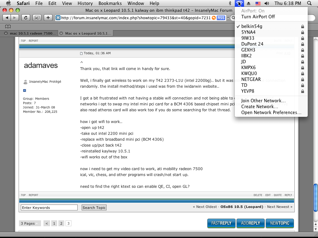

adamaves Posted April 25, 2008 Share Posted April 25, 2008 ^ Thank you, that link will come in handy for sure. Well, i finally got wireless to work on my T42 2373-L1U (intel 2200bg).. but it was slow and i'd lose connection randomly. the install method/steps i used was from the iwidarwin website.. I got a bit frustrated with not having a stable wifi connection and not being able to connect to encrypted networks i opt to swap my intel mini pci card for a BCM 4306 based chipset mini pci card. ebay broadband or i've also read atheros card will also work too if you do some searching for that thread. how i got wifi to work.. -open up t42 -take out intel 2200 mini pci -replace with broadband mini pci (BCM 4306) -close up/put back t42 -reinstalled kaylway 10.5.1 -wifi works out of the box now i need to get my video card to work, ati mobility radeon 7500 ical, vlc, chess, and other programs will crash/not start up. need to find the right ktext so can enable QE, CI, open GL? Link to comment Share on other sites More sharing options...

water_cooling_man Posted August 16, 2008 Share Posted August 16, 2008 ^Thank you, that link will come in handy for sure. Well, i finally got wireless to work on my T42 2373-L1U (intel 2200bg).. but it was slow and i'd lose connection randomly. the install method/steps i used was from the iwidarwin website.. I got a bit frustrated with not having a stable wifi connection and not being able to connect to encrypted networks i opt to swap my intel mini pci card for a BCM 4306 based chipset mini pci card. ebay broadband or i've also read atheros card will also work too if you do some searching for that thread. how i got wifi to work.. -open up t42 -take out intel 2200 mini pci -replace with broadband mini pci (BCM 4306) -close up/put back t42 -reinstalled kaylway 10.5.1 -wifi works out of the box now i need to get my video card to work, ati mobility radeon 7500 ical, vlc, chess, and other programs will crash/not start up. need to find the right ktext so can enable QE, CI, open GL? I did the same as adamaves and replaced my T42's wireless card with a mini-pci wireless card with the BCM 4306 chipset. Just like his results, when I reinstalled kalyway 10.5.1, wifi works out of the box. Great signal strength and WPA2 support. The only problem is that it seems to lose its connnection to the network after sitting idle a while even when it is near the access point and and has 100% signal strength. Simply clicking on the connection icon at the top of the screen reconnects it. Link to comment Share on other sites More sharing options...
