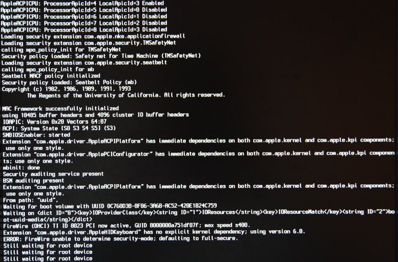

rgreenpc Posted June 20, 2008 Share Posted June 20, 2008 When I tried to apply the Kallyway 10.5.3 in reboot I had several errors on screen and waiting on root over and over. It also hosed my MBR for VISTA. I spent an hour rebuilfing that thing. Link to comment https://www.insanelymac.com/forum/topic/77371-dell-xps-420-help/page/3/#findComment-790636 Share on other sites More sharing options...
SticMAC™ Posted June 20, 2008 Share Posted June 20, 2008 Did you do Kalyway's update? If not you should have used Netkas' update procedure! It would have advised you which kexts to backup so that these errors don't occur! One of which would have been your AppleAHCIPort.kext is why the new one is giving you the "waiting for root device" error! The old one has you device ID in and you either have to put it back or edit the existing on somehow!? Then you also need the old ACPIP kext to get things going! Other you will need are your old injectors for audio video and anything else that was unique to your system! Good luck StiCMAN When I tried to apply the Kallyway 10.5.3 in reboot I had several errors on screen and waiting on root over and over. It also hosed my MBR for VISTA. I spent an hour rebuilfing that thing. Link to comment https://www.insanelymac.com/forum/topic/77371-dell-xps-420-help/page/3/#findComment-790651 Share on other sites More sharing options...

ennova Posted October 18, 2008 Share Posted October 18, 2008 Hi I'm hoping someone might be able to help me figure out what I'm missing. I have a XPS 420 as well and I've installed OSX 10.5.5 to a USB Hard Drive and it works fine, I've managed to get most everything working, but I noticed that I don't have any of my SATA drives(HDD, DVD/CD) when I boot with RAID Mode on. When I boot with Raid Mode set to Auto/ATA, I have my SATA drives and it works(but windows won't boot up.) From what I understand using the Auto/ATA mode is IDE whereas using the Raid Mode on is AHCI right? I'd really like a point in the right direction to get my AHCI working properly. I'll explain how I set everything up: 1. I booted iDeneb 10.5.5 from my DVD drive. 2. I formatted my USB HDD using a GUID partition. 3. I selected ICHx Fixed under the Chipset options. 4. I didn't select any Audio, Ethernet or Video options. 5. After the installation, I booted into safe mode with -v -x. 6. I installed the kext for my ATI 3870, as the ones that installed with iDeneb didn't work. 7. My wireless card worked with the Vanilla Kernel. 8. I patched my Audio using the AppleHDAPatcher(1.2 and 1.16... I have restart issue) Everything is working really well(minus the 9227 audio problem and my missing SATA drives). Does anyone have an ideas of why my drives aren't showing up? I checked and I have the following kexts: AppleAHCIPort.kext IOAHCIFamily.kext IOATAFamily.kext I know people have both modes working. Any help will be GREATLY appreciated. Thanks for your time. Ennova P.S. Here are my specs: Dell XPS 420 CPU: Q9450 (2.66ghz all cores working) Ram: 4x1GB (800mhz) GPU: ATI3870 HDD: 750GB(Vista) External USB 120GB(OSX). Link to comment https://www.insanelymac.com/forum/topic/77371-dell-xps-420-help/page/3/#findComment-935670 Share on other sites More sharing options...
ennova Posted October 18, 2008 Share Posted October 18, 2008 Nevermind I figured it out. I just had to add the hardware IDs to the AppleAHCIPort.kext... I figured they would've been there since iDeneb stated it supported up to ICH9, and I'm running ICH9. Oh well. Everything works now!!! well minus that annoying sound issue. Link to comment https://www.insanelymac.com/forum/topic/77371-dell-xps-420-help/page/3/#findComment-935722 Share on other sites More sharing options...
applebender Posted January 14, 2009 Share Posted January 14, 2009 Guys, I need your help. I am depressed with my bad luck. Before I tried Inspiron 530, 530s, no go, then I came across the XPS 420 OSX (iAtkos 4i) video on youTube and it seemed so easy, I even used Fred's settings there. My refurb 420 has q6600, 2 GB memory and ATI Radeon HD 3870 card. It came with HD on SATA 0 and SATA DVD on SATA 1 channel. Setting was Sata RAID. I tried iDeneb, Leo4all v3 and iAtkos 5i (my main target). With the latter I tried both EFI v9 and Chameleon setting, while alternating BIOS to either "SATA Raid" or "Autodetect-ATA". No go. My most frequent problem is "waiting for root device". Example of settings: iAtkos Main EFI v9 or Chameleon Apple Decrypter stock or sleep mod Kernel ACPI (yes or no) Disabler SMBIOS EFI-enabler Intel AHCI SATA (when BIOS on Raid) or the other non SATA when BIOS in Autodetect-ATA Somehow I feel that the problem is that the system is not seeing the boot drive and it is possibly something related to SATA setting I read here on forum that one guy had to put HD on first SATA chanel and DVD-ROM on second channel, but this formulation is not clear whether he meant SATA ) and SATA 1 or SATA 1 and SATA 2... I am close to give up on 10.5.5 and try Kalyway the people used for XPS 420. Verbose message attached. Link to comment https://www.insanelymac.com/forum/topic/77371-dell-xps-420-help/page/3/#findComment-1041015 Share on other sites More sharing options...
(((BENJI))) Posted January 18, 2009 Share Posted January 18, 2009 Hey Whats Up AppleBender I Had The Same Problem On The iATKOS 5i Install, The Solution Is To Reset The BIOS To Default And Turn Off RAID ON - Set It To Auto/ATA Let Me Know If It Works? Also For Those That Want To Multi-Boot Vista - Hackintosh - Windows 7 Here is Acronis Disk Director 10, Works Perfectly http://rapidshare.com/files/185262549/ADDS10.0.2160.zip Link to comment https://www.insanelymac.com/forum/topic/77371-dell-xps-420-help/page/3/#findComment-1045786 Share on other sites More sharing options...
applebender Posted January 18, 2009 Share Posted January 18, 2009 ..I Had The Same Problem On The iATKOS 5i Install, The Solution Is To Reset The BIOS To Default And Turn Off RAID ON - Set It To Auto/ATA Let Me Know If It Works? I have already tried the Autodetect/ATA setting in BIOS without success. I will try again later today. I need to find out what do you mean by "reset the BIOS". Is this an option in BIOS like going to "factory default" or is this some hardware button on the motherboard ? A list of all settings in install of iAtkos 5i or Kalyway 10.5.2. would be helpful. I have already tried the Kalyway 10.5.2. most people used on XPS 420 and again, failure. Could the position on SATA channels of the HD and DVD be of importance ? Dell manual speaks SATA 0 and SATA 1 to be for HDs and the higher number SATAs for optical drives. Also of interest is ChopperBoy's need to use EasyBCD to get it going: "I Installed Kalyway on my second drive using Vanilla kernel, NVInject, Timemachine fix, no Lan Drivers or Sound Drivers and assorted optional programs ont he disk. Rebooted and low and behold I could not get into OS X I had forgottent to get a boot loader so back to windows I go and installed EasyBCD and set my boot loader to recognize the HFS+ boot drive. Rebooted and went straight to the OSX Desktop with NO Sound." His blog. Link to comment https://www.insanelymac.com/forum/topic/77371-dell-xps-420-help/page/3/#findComment-1046379 Share on other sites More sharing options...
(((BENJI))) Posted January 18, 2009 Share Posted January 18, 2009 Go To The BIOS Under Maintenance Is The Load Defaults Option Under Drives Is The RAID AutoDetect/ATA Option HDD Set It To Sata 0 And The Optical Drive To Sata 1 On The iATKOS 5i > Costumize It To This Options Also Forgot To Mention To Disable NIC On The BIOS iATKOS v5i Main System PC EFI V9 AppleDecrypt 9.5.0 Kernel Voodoo Stock ACPI Modified Disabler.Kext ATI SATA/IDE > Intel SATA NTFS-3G Both Network & Audio Dont Work For Me, Maybe You Can Look Online And Find Out How To Make It Work Let Me Know If It Works! Link to comment https://www.insanelymac.com/forum/topic/77371-dell-xps-420-help/page/3/#findComment-1046844 Share on other sites More sharing options...
applebender Posted January 19, 2009 Share Posted January 19, 2009 It's fun - for the first time, I have "something". This is what happened. I reset the BIOS. I noted that that made all SATA channels ON. I switched off Audio and NIC. I started from iAtkos 5i, did not format the HD again but at least repaired the disk (was O.K.) and permissions (there were several..) Settings were like you suggested: iATKOS v5i Main System PC EFI V9 AppleDecrypt (added SMBIOS-EFI) 9.5.0 Kernel Voodoo Stock ACPI Modified Disabler.Kext ATI SATA/IDE > Intel SATA NTFS-3G I thought I have the setting on Autodetect/ATA but it is possible that during installation it was SATA (as I discovered the setting to be later on reboot). Before first boot in OSX, I went again to the DVD and from there repaired permissions (a long list of repairs or discoveries) Then I rebooted to the OSX HD in verbose mode. There was some yellow text of problems (didn't I see yellow only in iDeneb distro??) pertaining to com.orByte.driverPCGenUSBEHCI. I got the feeling that maybe I don't have the Autodetect/ATA ON, so went to BIOS and set it so. Reboot and I saw the SUCCESS. But, the desktop pic has iDeneb on it ?!? In Applications, I have folders KOOLSOFT and iDeneb App ???? So what I have - a hybrid between iAtkos and iDeneb ? Some effect of previous iDeneb install attempts ? Maybe became active by the repaired permissions ? Also, there is no iDVD - my main reason to try Hackintosh for HD video work. In the About, the processor (a Quad 2.4) is reported as 4.3 GHz. Lot of info is missing in Profile. I have add-on Rosewill Ethernet card with a Realtek chip. I am trying to understand why I am not getting Ethernet access to Internet. I put in Manual data in the connection panel but still no connection. In Profile, I am trying to distinct, whether I can see the on-board or add-on adapter's MAC address. So at least something, system is ZIPPY, but why I have the iAtkos/iDeneb chimera and I need the ethernet get going. Sleep and reboot not tested yet. Link to comment https://www.insanelymac.com/forum/topic/77371-dell-xps-420-help/page/3/#findComment-1046939 Share on other sites More sharing options...
(((BENJI))) Posted January 19, 2009 Share Posted January 19, 2009 Which Torrent Did You Download? Is It The 10.5.5 Leopard Version? I Also Go That In The "About This Mac" The First Time I Boot It, I Install Another Video Drivers And Restart And Everything is Back To Normal Link to comment https://www.insanelymac.com/forum/topic/77371-dell-xps-420-help/page/3/#findComment-1046943 Share on other sites More sharing options...
applebender Posted January 19, 2009 Share Posted January 19, 2009 Which Torrent Did You Download? Is It The 10.5.5 Leopard Version? I got the iAtkos 5i from "small nova". The size is smaller than other distros (2.6 GB). I checked the md5 checksum and it fits. I am 99.9% certain that I had the iAtkos DVD in the drive when I followed your instruction. In any case, I have a working OSX now but it has parts from iDeneb ? Is there a way I can interrogate the PC what distro I have actually working now ? I will get another HD and will try the iAtkos install on it again. I stepped out and the PC fell to sleep. I could not bring it back by clicking the keyboard or mouse. A short click on the Power button brought back just mini bricks pixelated display, so I rebooted and everything is fine. Even the NIC now works via the add-on card :-) Link to comment https://www.insanelymac.com/forum/topic/77371-dell-xps-420-help/page/3/#findComment-1047054 Share on other sites More sharing options...
