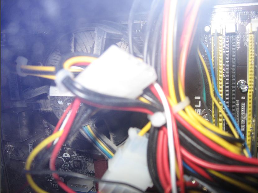

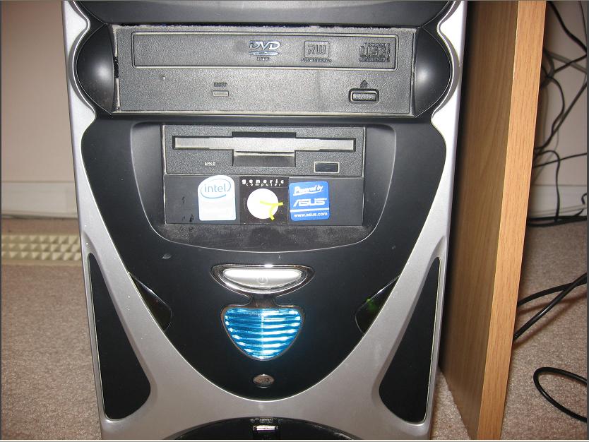

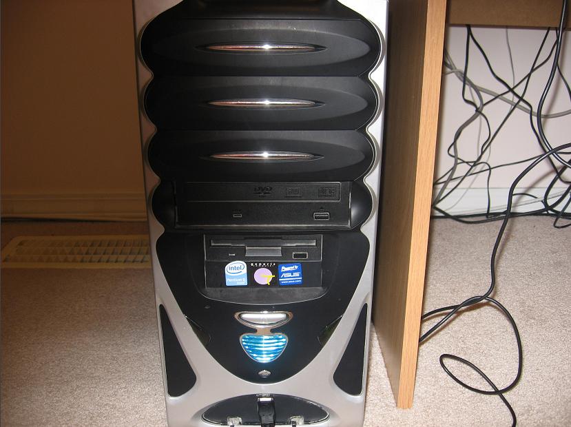

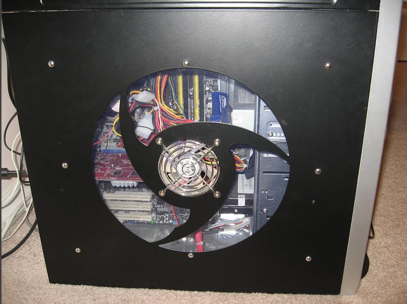

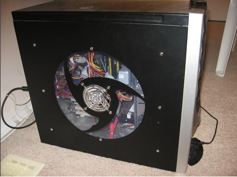

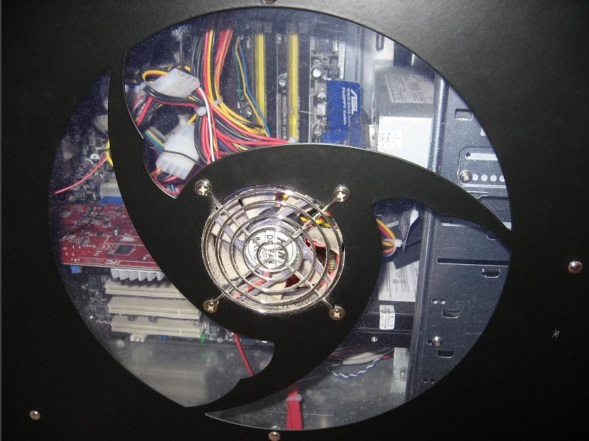

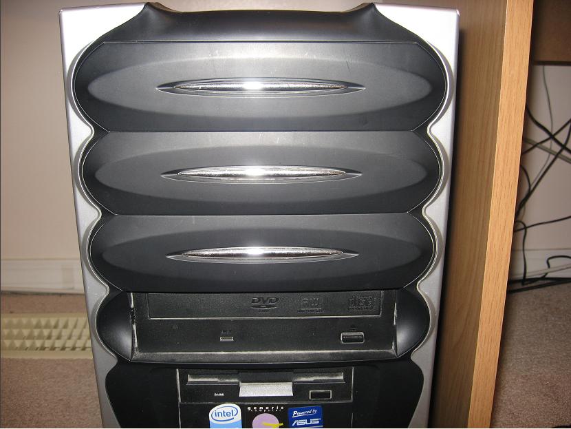

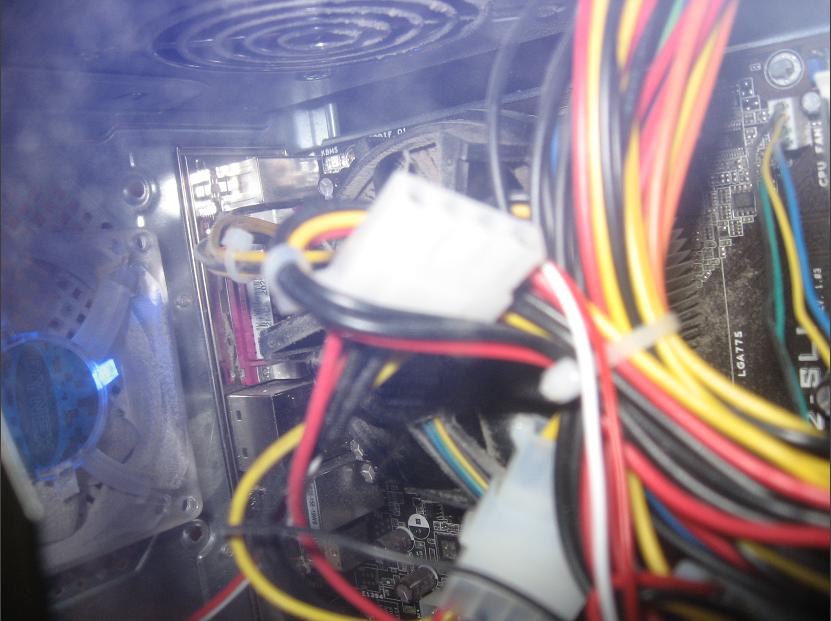

~pcwiz Posted December 3, 2007 Share Posted December 3, 2007 Hi, This question is not related to OSx86 hardware but seeing as this is the only hardware forum, this is the best place to post it. My computer has cooling issues. Specs: ASUS P5ND2-SLI Motherboard Intel Pentium D 830 3GHz Processor (stock cooler, not overclocked) 1GB A-Data DDR2 533 RAM ATI Radeon X1650 Pro 512MB Video Card 250GB Samsung Hard Drive Here are some pics of the computer case: Front of Case Case Front Top Case Front Bottom Side Side Zoomed Inside Inside 2 Angled (whole case) =-=-=-=-=-=-=-=-= I know that its clogged with dust but even after I clean it, its like 48-50 C idle and 55-60 C at 60 or 70 percent load. Right now, its about 60 C idle and 75 C at almost full load. Is this how everything is supposed to be? I don't think so. Could it be a bad airflow case? The case is cheap junk, can't even find a brand name on it. On the box it says "Sportek Case" The Case has the PSU fan, GPU fan, CPU fan, a 80mm side fan, and a new 80mm fan on the back all functional. Please help Link to comment https://www.insanelymac.com/forum/topic/74571-whats-wrong-with-my-computer/ Share on other sites More sharing options...

~pcwiz Posted December 3, 2007 Author Share Posted December 3, 2007 Yeah its always been that hot. Its OK for normal use, but when using Mac OS X or playing graphics intensive games the temps go way too high and the computer becomes unstable. The only thing I can think that is blocking airflow would be the bunch of power supply wires draped over the CPU. And yes I checked the airflow after installing the new fan. It didn't do much help to reduce the temps. Link to comment https://www.insanelymac.com/forum/topic/74571-whats-wrong-with-my-computer/#findComment-527145 Share on other sites More sharing options...
frizbot Posted December 4, 2007 Share Posted December 4, 2007 Your computer is set up badly for cooling. That case is {censored}. Replace it with something without a side window or side fans, but with a decent front air intake and 120mm fan exhausts. I'd suggest Antec. If you can't or don't want to, take out that side fan and tape the hole up; it shortcircuits air flow and lets noise out. Ensure that the front vent is open, which might take modding (removing metal/plastic obstructions). Cases are just there to hold the parts together, so as long as you can mod it to be less obstructive to airflow, and you don't mind sharp edges, the case doesn't matter much. A new case with a dust filter might help you. Replace the rear fan with a 120mm fan. There's lots to choose from. You're having heat issues, so a faster fan and a fan speed controller might help. Otherwise, an upgrade to 120mm will either halve the noise, double the airflow, or something in between. Nexus or the slow Yate Loon for quiet, panasonic and scythe for in between, and I know Sunon makes crazy high-flow fans. You're using the OEM Intel cooler. It's surprisingly good from a historical perspective, but obviously not enough for modern cooling. Replace with a Thermalright tower or Zalman cooler. Thermalright is more expensive and the fan is extra, but it can often run passive, and the fan is replaceable. Your PSU is likely {censored}. Replace it with something Enermax, Antec, Zalman, something like that. Best to have a single 120 to 140mm fan, not two 80mm or anything like that; two small fans in parallel, like your PSU setup, double the noise but not the airflow. I believe a PSU fan can act as a case exhaust, but don't rely on it. The more efficient the PSU is, the less energy wasted as heat, so the less noise and overheating problems. A brand name PSU should be far more reliable and efficient (look for >80%) than whatever came with the cheap case. Try a speedstep kernel and turn speedstep on dynamic CPU. It won't be any safer for the hardware, but it'll make you feel better to see even lower idle temperatures and lower energy bills. Link to comment https://www.insanelymac.com/forum/topic/74571-whats-wrong-with-my-computer/#findComment-527640 Share on other sites More sharing options...
