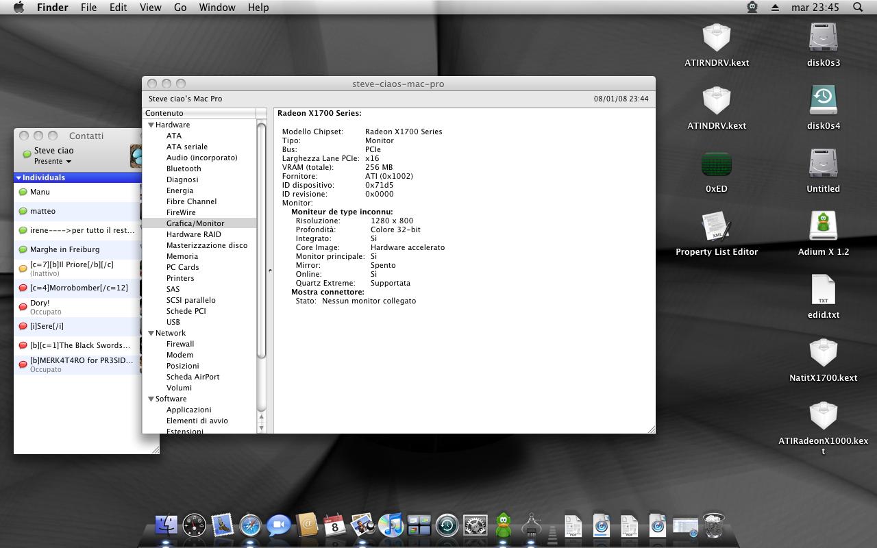

sliva Posted January 8, 2008 Share Posted January 8, 2008 Hi all. I tested a all methods of this branch, but never succeeded. I used to install KALYWAY_LEO_10.5.1intel_SSE2_SSE3 after installing the card correctly defined and there is support QE / CI, but there is no way to change the resolution and artifacts observed mouse. Using the Files of the links on this branch, I had the normal resolution, but that does not work backlight display. Everyone who has a desire to help can give all the details they need. Thank you Link to comment https://www.insanelymac.com/forum/topic/70843-ati-mobility-radeon-x1700/page/6/#findComment-570841 Share on other sites More sharing options...
Steve85 Posted January 9, 2008 Share Posted January 9, 2008 Okay , I will list the file you need .+ ATIRadeonX1000* + ATIRNDRV.kext + 10.4.5 ATINDRV.kext ( from my files in previous post ). Here is the step (details you can read on my previous post) First copy all file I list to Extensions & chmod , chown . 1) Edit RadeonX1000.kext with your device id (hext edit & plist edit) --> you should get QE/CI with 1024x768 & mouse tearing 2) Instead of using ATIinject , use my new edited Natit ( you only need to replace included EDID with your EDID ) --> you should get full resolution with QE/CI PS : If you don't know clearly about any steps , post here . Please read my guide carefully about hex edit , plist edit , replace kext . Only use my ATINDRV.kext & NatitX1700.kext , remaining files use org file included with your installation & edit your own . @all : I replace ATIinject with my edited NatitX1600 & get much more stable driver , no weird behaviour at boot time , ... . So if you encounter problems with ATIinject , use my new file . Only need to replace EDID , no need to edit device-id . I hex edit included natit file to get model name X1700 , so if you want different model name hex edit your own . Hi to all! First of all sorry for my English. I finally did it! 1280x1024 with CI/QE and no artifacts nor mouse tearing! I followed thehuan way: Kalyway Leopard 10.5.1 Asus F3JP AP029P Ati Radeon x1700 I modified the kext atiradeonX1000(in /System/Library/Extensions) as thehuan said: step 1: Edit your ATIRadeonX1000.kext + Use 0xED to hex edit ATIRadeonX1000 binary file in ATIRadeonX1000.kext/Contents/MacOS Replace all "DE71" with your id (in my case is D571) . It should be only 2 replacements + Use property editor or text edit to replace "71DE1002" with your id ( in my case is "71D51002" ) + Replace org kext with your edited kext . Reboot . With this you can get QE/CI but still 1024x768 resolution & mouse tearing (replace kext means using sudo etc,.. i did it with kexthelper modifying the script (i changed chown -R root:wheel in chown -R 0:0) Reboot Obtained 1024x768 with no mouse tearing Then I replaced atindrv with that in Leopard x1700.zip brought by thehuan. Reboot Nothing changed (fortunately!!) Then I tried with atiinject modified with my edid and device id........TRAGEDY......The system boots, blue screen, unusable I started in safeboot, i managed to erase atiinject Reboot and back to 1024x768 with ci/qe. Now I used natitx1700.kext brought by thehuan modifying not only the edid, but also the device in info.plist TA DA!! Resolved. I'm writing from leopard which I dual boot with win xp using darwin bootloader. I wanted to explain as accurately as possible my story because perhaps also the problem with atiinject brought me to te solution. I'm a noob and I tried to be as clear as possible for other noobs. I hope this message can be useful for you! greetings P.S. The first boot was perfect, the second garbage screen, now I'm at the 5th reboot and it seems to be stable. I hope this can last forever!! I don't want to send you a file with the kexts because I think it's unuseful. Try to modify your files in the way I wrote. Atindrv and natitx1700 are available in previous posts from the huan. For the newbies, don't think to be poor of knowledge about mac. Try to learn how to do modifications and why. It's better and it's more probable you can obtain good results. I never owned a mac, I started my experience with mac a week ago and today I also know some terminal commands that can be helpful. Search this forum for everything. I think there's almost everything in this forum!! Thanks to all who made this possible, kalyway, thehuan, koszlowski and the others! Link to comment https://www.insanelymac.com/forum/topic/70843-ati-mobility-radeon-x1700/page/6/#findComment-571833 Share on other sites More sharing options...

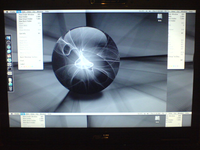

righteye Posted February 15, 2008 Author Share Posted February 15, 2008 I have a mobility x1700 device id 0x71d5 and i used the new files that you provided and I have QE/CI enabled. Teh resolution is set to 1440x900. My screen is 1680x1050 max, so i have the screen repeating in the bottom and right sides. how do i fix this?btw im using Kalyway 10.5.1 with vanilla kernel. Asus F3JP Mobility Radeon x1700 Intel Core 2 Duo T7200 2.0 GHz this files are for my system, an asus G2P ... so i believe is a problem from EDID Also you should try the ATiinject.kext that someone else provided previously or just try to edit the com.apple.boot.plist like this sudo nano /Library/Preferences/SystemConfiguration/com.apple.Boot.plist and write this inside <key>Graphics Mode</key> <string>1600x1050x32@85</string> also you can try this files http://www.mediafire.com/?f0ddjmhctvp that lemnisk8 posted earlier. and replace just ATiinject, ATiNRDV and the AtiRadeonx1000 files ... the rest should be the originals from your install DVD All the best Link to comment https://www.insanelymac.com/forum/topic/70843-ati-mobility-radeon-x1700/page/6/#findComment-625052 Share on other sites More sharing options...
torpie13 Posted February 15, 2008 Share Posted February 15, 2008 @righteye: Are your drivers stable, esessially after boot ? Link to comment https://www.insanelymac.com/forum/topic/70843-ati-mobility-radeon-x1700/page/6/#findComment-625237 Share on other sites More sharing options...
torpie13 Posted February 15, 2008 Share Posted February 15, 2008 Great !!! @righteye : your drivers working flawlessly on 10.5.2, no crash or instability till now. Thanx alot. @python1564 : Try to change the EDID, I got the same behaviour like you with the righteye drivers (I got a 1680x1050 resolution), then I changed the EDID with mine and all went perfectly OK. Makes my day :censored2: Link to comment https://www.insanelymac.com/forum/topic/70843-ati-mobility-radeon-x1700/page/6/#findComment-625272 Share on other sites More sharing options...
