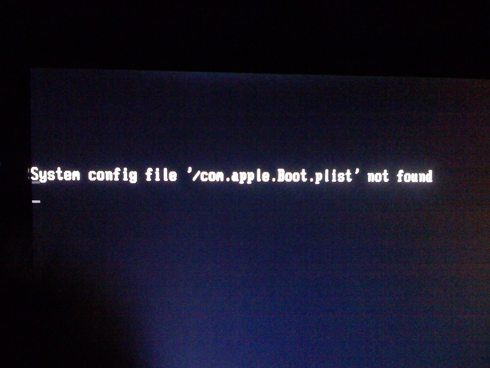

finebykris Posted October 31, 2007 Share Posted October 31, 2007 When I use a patched DVD i burnt (demonoid by mmcornick), i boot from it and i get the following message after the disc loading dashes: System config file '/com.apple.Boot.plist' not found _ Is this normal? Does it mean I need to install tiger first? if so, how do I ? Also, where can i find the latest USB drvie drivers to patch it during the installation once i get it working? thanks Kris Link to comment https://www.insanelymac.com/forum/topic/68718-help-me-installing-leopard-please/ Share on other sites More sharing options...

ErEr Posted November 2, 2007 Share Posted November 2, 2007 play with Bios sata setting f your motherboard , try AHCI in Bios, also sellect compatible mode if exist, also try other sata channel than Jmicron. that should solve your problem. Best regards, Link to comment https://www.insanelymac.com/forum/topic/68718-help-me-installing-leopard-please/#findComment-492075 Share on other sites More sharing options...
DuderDE Posted November 2, 2007 Share Posted November 2, 2007 Person above me is completely right. NO jMicron BUT AHCI-Mode Try switching your DVD-ROM to one set of ports (S-ATA) and the drive you want to install on another. Remove all other drives (you can plug them in after install and they just work fine, even the ones on the jMicron. ENABLE THE AHCI-MODE! After I really switched to AHCI and got Vista working again (hard work though) every both installs of MAC (Leopard, Tiger) worked really smoothly. So I can really recommend AHCI. Have fun with Leopard, after installing! Link to comment https://www.insanelymac.com/forum/topic/68718-help-me-installing-leopard-please/#findComment-492108 Share on other sites More sharing options...
finebykris Posted November 2, 2007 Author Share Posted November 2, 2007 mobo is asus p5b-deluxe ich8r is 6 sata ports... here is what i have set up: 1: Unformated (desired leo drive) 2: vista 3: n/a 4: n/a 5: Storage drive/backup 6:n/a My j-micron consists of 1 sata and 1 ide the sata is unplugged and my dvd drive is on the ide is that setup ok? what should be switched to ahci? (hard drive = compatibility or ahci?) and what setting should my j-micron be? raid, ide or ahci (for my dvd drive) Link to comment https://www.insanelymac.com/forum/topic/68718-help-me-installing-leopard-please/#findComment-492212 Share on other sites More sharing options...
ChickenFlu Posted November 3, 2007 Share Posted November 3, 2007 ANYONE? why does the brazilmac patched dvd show up as 482 kb in windows disc properties? why doesnt it boot up? if i remember right? that happened with my tiger dvd also. I think its because the disc is formatted in hfs. I installed macdrive and then i could see the entire contents of the cd. Why dont u download the macdrive demo and check? Link to comment https://www.insanelymac.com/forum/topic/68718-help-me-installing-leopard-please/#findComment-492559 Share on other sites More sharing options...
Thireus Posted November 3, 2007 Share Posted November 3, 2007 When I use a patched DVD i burnt (demonoid by mmcornick), i boot from it and i get the following message after the disc loading dashes: System config file '/com.apple.Boot.plist' not found _ Is this normal? Does it mean I need to install tiger first? if so, how do I ? Also, where can i find the latest USB drvie drivers to patch it during the installation once i get it working? thanks Kris You must install tiger first and then install Leopard Brazilian on the same partition, I had the same error message Also there's other methods to make it boot, but I advice you to use this one. Then don't forget to PostPatch your Leo Link to comment https://www.insanelymac.com/forum/topic/68718-help-me-installing-leopard-please/#findComment-492606 Share on other sites More sharing options...
