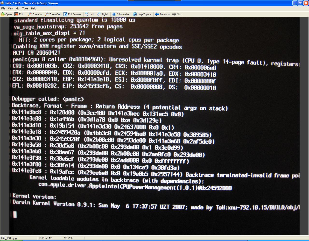

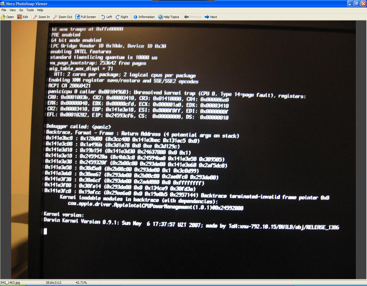

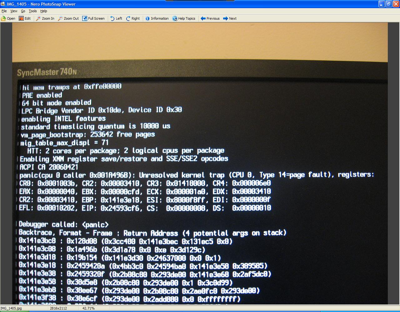

~pcwiz Posted September 9, 2007 Author Share Posted September 9, 2007 I got the mouse problem fixed by swapping the PS/2 mouse with a USB one but I encountered another problem. So I formatted the USB drive and selected the Master Boot Record and everything. Then I installed the 10.4.9 v.1.4iR3 with the neccessary drivers for my hardware and the installation completed successfully. When the computer rebooted after installation, I got the normal Loading Darwin/x86 thing but right after the Loading Darwin/x86 screen, a panic screen (You need to restart your computer in 4 languages) came up. So I reformatted the USB Drive and installed a copy of JaS 10.4.8 Intel AMD SSE2 SSE2 PPF1 + PPF2 with the on the drive. Again, the installation completed successfully but again I got the same panic screen after the Loading Darwin/x86 screen. Next, I tried reformatting the drive installing the 10.4.9 v1.4iR3 WITHOUT any drivers or patches, just the main system. I got the same panic screen again.Anyone know what to do? So, I started OS X up in safe mode with verbose (-x -v) Everything loaded and then it came to this screen and just stopped. Here are screenshots of the error screen: Picture 1 (Full Error Screen) Picture 2 (Error screen zoomed, first half) Picture 3 (Error screen zoomed, second half) Link to comment https://www.insanelymac.com/forum/topic/62682-installing-osx86-on-a-external-usb-drive/#findComment-444734 Share on other sites More sharing options...
blacknight Posted September 9, 2007 Share Posted September 9, 2007 use one core put cpus=1 -v and hopefully it shuld work for you. if it didnot work remove appleintelcpupowermanagement.kext using the install dvd. Link to comment https://www.insanelymac.com/forum/topic/62682-installing-osx86-on-a-external-usb-drive/#findComment-444750 Share on other sites More sharing options...
~pcwiz Posted September 9, 2007 Author Share Posted September 9, 2007 The cpus=1 -v thing didn't work. It froze at exactly the same scree. So, How do I remove appleintelcpupowermanagment.kext using the install DVD? Can you give me exact instructions? Thanks in advance Link to comment https://www.insanelymac.com/forum/topic/62682-installing-osx86-on-a-external-usb-drive/#findComment-444936 Share on other sites More sharing options...
chevy2410 Posted September 9, 2007 Share Posted September 9, 2007 Boot the install dvd again and in.... I think the system tab there will something called "remove intel cpu power management" or something very similar to that. Check it and don't check anything else. Then continue with the install. DON"T check off anything else! You just want the power management checked. Once done reboot as normal. If all goes well it will boot into OS X. Chevy Link to comment https://www.insanelymac.com/forum/topic/62682-installing-osx86-on-a-external-usb-drive/#findComment-444968 Share on other sites More sharing options...
~pcwiz Posted September 9, 2007 Author Share Posted September 9, 2007 I formatted and reinstalled, choosing the Remove CPUPowerManagement option and just the base system. The Power Management error went away but now I get this new error screen. Here are screenshots: [pics deleted] It seems to be some sort of kernel panic debug error. Anyone have a solution? Link to comment https://www.insanelymac.com/forum/topic/62682-installing-osx86-on-a-external-usb-drive/#findComment-445008 Share on other sites More sharing options...
chevy2410 Posted September 9, 2007 Share Posted September 9, 2007 Ok you didn't get what i was saying. I didn't want you to reinstall the base system, just the "remove power management kext". Go back and boot the install dvd again and check off the patches that apply to you system. Meaning video, ethernet, remove power mangaement, login window, and depending on what sata chipset you have you might have to check off sata drivers. Check your mobo user manual for what have. Also read the instuctions right before you choose your install options. I didn't know you have an nForce4 chipset and creates some problems as well. If there are some patches in the sytem or somewhere else for nForce4 you will need to check them as well. Chevy. Link to comment https://www.insanelymac.com/forum/topic/62682-installing-osx86-on-a-external-usb-drive/#findComment-445089 Share on other sites More sharing options...
blacknight Posted September 9, 2007 Share Posted September 9, 2007 try sata support just check it. Link to comment https://www.insanelymac.com/forum/topic/62682-installing-osx86-on-a-external-usb-drive/#findComment-445131 Share on other sites More sharing options...
~pcwiz Posted September 10, 2007 Author Share Posted September 10, 2007 Failure again. This time I tried 3 configurations. All of them failed, but got a little farther than the first time. Here are the configurations and screenshots of the errors: Configuration #1 Selected the following to install: v1.4i Main System logonwindow 10.4.4 Remove CPUPowerManagement kext ATI X1x00 (VGA Driver for ATI Radeon X1650 PRO PCIe card) nForce 4 SATA PS/2 (Driver for my Logitech PS/2 mouse) Azalia Audio Driver (For Realtek Audio) USB Driver Intel Pro 100 VE (Driver for Intel Pro 10/100/1000 82540EM Gigabit LAN) With this config, I got this error screen: I formatted and reinstalled, choosing the Remove CPUPowerManagement option and just the base system. The Power Management error went away but now I get this new error screen. Here are screenshots: [pics deleted] It seems to be some sort of kernel panic debug error. Anyone have a solution? Configuration #2 Selected the same options as Config #1 except with these modifications: Did NOT install the USB Driver Installed the Natit X1600 VGA Driver instead of the ATI X1x00 Driver I got this error screen (different from Config 1 error screen): I formatted and reinstalled, choosing the Remove CPUPowerManagement option and just the base system. The Power Management error went away but now I get this new error screen. Here are screenshots: [pics deleted] It seems to be some sort of kernel panic debug error. Anyone have a solution? Configuration #3 [/b][/u]Same as Configuration 2 (with Natit X1600 driver) except I did install the USB Driver this time I got the same error screen as Configuration 1 ******************************************************************************** ************ Well, thats how it went. I'm close to giving up because I've tried everything I could. If anyone sees anything I could do to fix this or something that I am doing wrong, please post back. blacknight, Sorry I read your message after trying all these configs. Do think that checking the SATA Support with the nForce4 SATA will make a difference after these errors? Thanks in advance Link to comment https://www.insanelymac.com/forum/topic/62682-installing-osx86-on-a-external-usb-drive/#findComment-445155 Share on other sites More sharing options...
