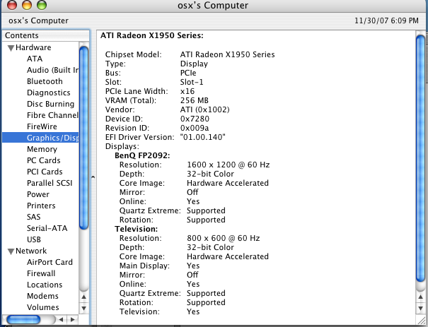

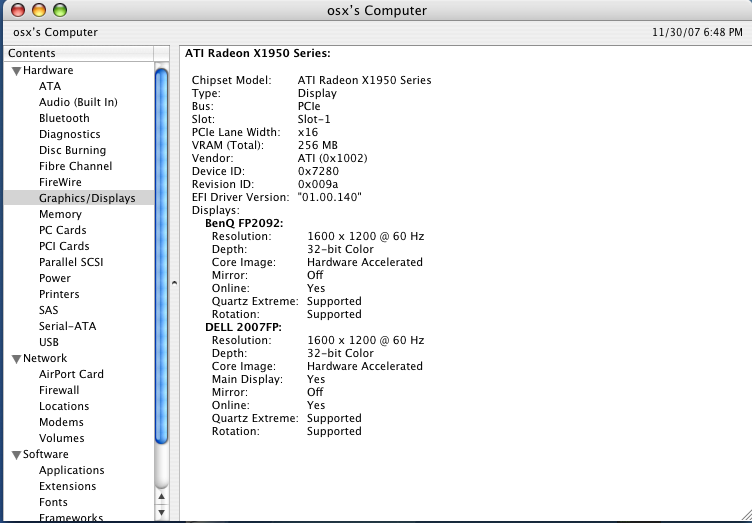

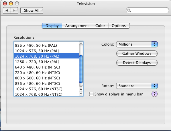

Bronya Posted November 30, 2007 Author Share Posted November 30, 2007 Hi ALL !!! I Fix Driver and How WORK FULL DRIVER FOR x1950 ! Work dual two monitors and TV !!! Wait !!! SOON ! Link to comment https://www.insanelymac.com/forum/topic/58988-work-x1950gt-pro-dev_id-0x72801002-and-0x72881002/page/25/#findComment-523926 Share on other sites More sharing options...
Gbone Posted November 30, 2007 Share Posted November 30, 2007 Bronya You are a GOD! TV-out support, I've been waiting for this for a long time. I love my ATI card (ASUS X1950Pro - Working like a charm with your driver.) Thank You very much. I am looking forward to trying it on my Leo. Link to comment https://www.insanelymac.com/forum/topic/58988-work-x1950gt-pro-dev_id-0x72801002-and-0x72881002/page/25/#findComment-524164 Share on other sites More sharing options...
Bronya Posted November 30, 2007 Author Share Posted November 30, 2007 The driver tomorrow ! Link to comment https://www.insanelymac.com/forum/topic/58988-work-x1950gt-pro-dev_id-0x72801002-and-0x72881002/page/25/#findComment-524288 Share on other sites More sharing options...
