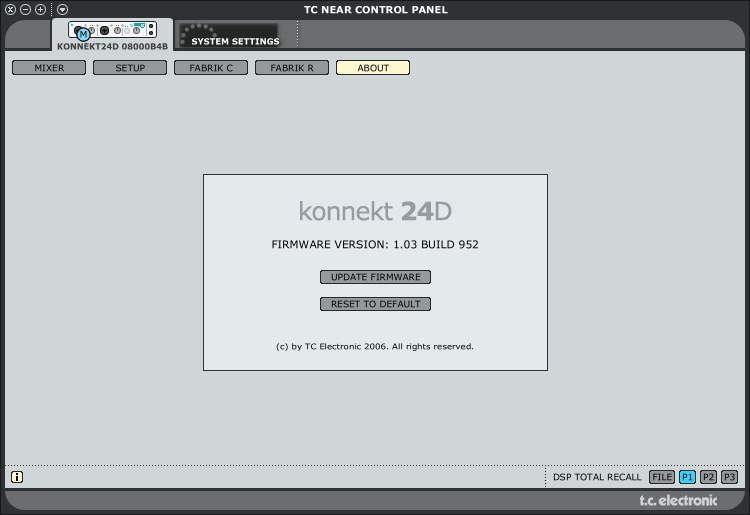

tomHack Posted July 14, 2007 Share Posted July 14, 2007 Thanks for the advice, I'll try this out... for anyone who need it, here is the file. It's from \System\Library\Extensions.10.4.9 Regards, Rakete I was so glad I found this thread since it gave me an idea to try out.. I too have the problem of havind the Konnekt not being recognized by its own control panel. Alas, after swapping my firewire kext, and disk repair, the error during the boot process did go away but the Konnekt is still not seen by its panel ! Anybody could venture a guess ? Link to comment https://www.insanelymac.com/forum/topic/56072-firewire-security-mode/#findComment-408061 Share on other sites More sharing options...
Rakete Posted July 14, 2007 Share Posted July 14, 2007 Alas, after swapping my firewire kext, and disk repair, the error during the boot process did go away but the Konnekt is still not seen by its panel ! Yes, same happend to me Link to comment https://www.insanelymac.com/forum/topic/56072-firewire-security-mode/#findComment-408105 Share on other sites More sharing options...

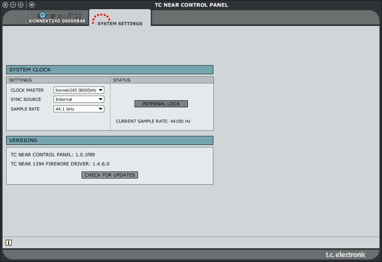

tomHack Posted July 15, 2007 Share Posted July 15, 2007 Last night, somehow I ve been able to get the darn thing to work with 10.4.10. Here's what I did: After fixing the FW security mode error, I did a search on 'konnekt' 'TC electronics' 'assimilator' etc.. In other words, don't trust the uninstall script ! It leaves remnants of the installation everywhere. Also don't forget the Konnekt Package receipt. So I trashed everything related to the installation. After that I unplug the Konnekt. Then I reinstalled the CD version of the driver. Then before restarting I plugged the Konnekt in bus powered mode. Then I restarted in verbose mode, et voilà ! The panel is back. It can also work with the Konnekt powered externally after that first restart. I tried to install the 1.22 update, but then I was in trouble again. So for the time being it is going to be the 1.03 version, until they update it to a compatible version with hackintosh 10.4.10 ? But still, if anybody has a suggestion I would be very glad to hear it, cause it seems like there is a some kind of bug with the audio firewire in the hack 10.4.10 Link to comment https://www.insanelymac.com/forum/topic/56072-firewire-security-mode/#findComment-408453 Share on other sites More sharing options...
Rakete Posted July 15, 2007 Share Posted July 15, 2007 thank you for this information, I'll try this out. But please tell me which firmware is running on your Konnekt? the 1.03 or the one wihich is contained in the 1.22 Package (it's the konnekt_8_24d_1184.tca) I can't believe that Driver and Panel from 1.03 work with the firmware from 1.22. So I have to downgrade the firmware? Second question: how do you remove the whole installation with all files and al residues? I'm a little bit a Mac-Noob and don't know what to do^^ Overall the v1.22 seems to be verry buggy, as it won't work fine under XP too. the changelog says: Known issues with this versionPC: We have seen some systems with audio drop outs. Disabling, for instance, the Ethernet network card or the CD-Rom drive solves the drop out problem. We are currently working on a driver version this will fix this. They should work fast and hard. Either sound or internet connection is a dumb decision... Link to comment https://www.insanelymac.com/forum/topic/56072-firewire-security-mode/#findComment-408457 Share on other sites More sharing options...
tomHack Posted July 15, 2007 Share Posted July 15, 2007 thank you for this information, I'll try this out. But please tell me which firmware is running on your Konnekt? the 1.03 or the one wihich is contained in the 1.22 Package (it's the konnekt_8_24d_1184.tca) I can't believe that Driver and Panel from 1.03 work with the firmware from 1.22. So I have to downgrade the firmware? Second question: how do you remove the whole installation with all files and al residues? I'm a little bit a Mac-Noob and don't know what to do^^ Overall the v1.22 seems to be verry buggy, as it won't work fine under XP too. the changelog says: They should work fast and hard. Either sound or internet connection is a dumb decision... search with spotlight, then trash everything that looks like it's been coming from Konnekt or TC Electronics. Be merciless ! Here's a view of my Konnect Settings: Link to comment https://www.insanelymac.com/forum/topic/56072-firewire-security-mode/#findComment-408492 Share on other sites More sharing options...
