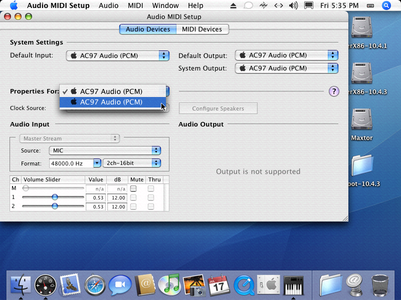

UncleP Posted November 30, 2005 Share Posted November 30, 2005 I have seen many people post that they loaded everything right and still don't have sound. Here is a possible fix for most of you out there that are having problems. Go to your Applications/Utilities/ folder and open your Audio Midi Setup program. You will get a window that shows your audio devices and settings. There is a dropdown selector called Properties For: (in this box you will see your sound card). There should be 2 to select in this option and one will be for input and the the other for output. Select the one that brings the output properties on the window because that is the one we want to configure. Now that the Audio Output options are up, go ahead and select 6ch-16bit to the right of the dropdown box called Format: .You can mess with the sample frequency rate later, we just want to get sound working right now. Once you have the channel set to 6 channels at 16bit, now click the button called Configure Speakers. In there you will have 2 buttons called Left Speaker and Right Speaker and below them the drop down selector to choose a channel 1 through 6. So now what you need to do is select the left dropdown and choose a channel. Most of the time channel 3 is the proper channel for the left speaker so try that first and then hit the left front button to test. You should hear white noise comming from the left speaker. If not then keep choosing a different channel and test. Do the same thing for the right speaker. I have found that 3 for left and 6 for right work most of the time. This has allot to do with the way audio channels are setup on your card for surround sound etc and therefore most cards now have more than just a 2 channel configuration. Hope this helps someone out. Link to comment https://www.insanelymac.com/forum/topic/5150-audio-problems-fix-by-setting-the-proper-sound-channels/ Share on other sites More sharing options...

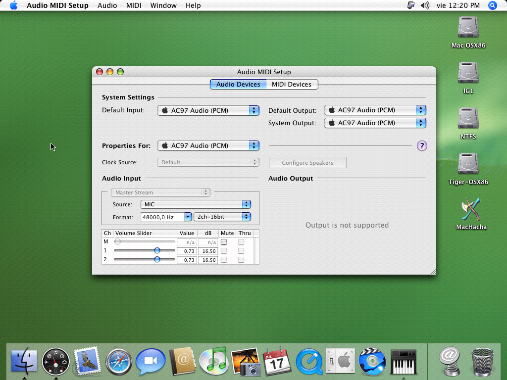

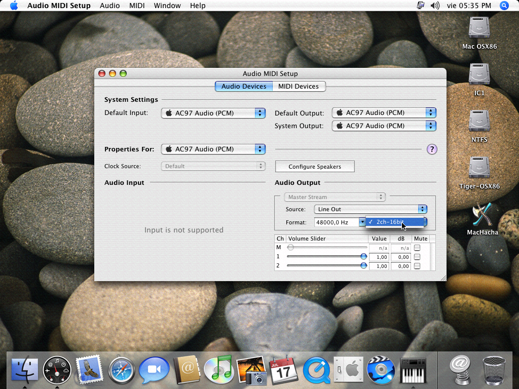

pc_guru Posted December 2, 2005 Share Posted December 2, 2005 Hi UncleP, My audio works fine, except that i only get sound from left speaker (right speaker is mute), i tried to fix it following your suggestion, but when i did enter into Audio MIDI Setup app, i didn't get output panel (look at this image posted below). Do you have any clue about ?. Thanks you in advance. Link to comment https://www.insanelymac.com/forum/topic/5150-audio-problems-fix-by-setting-the-proper-sound-channels/#findComment-33481 Share on other sites More sharing options...

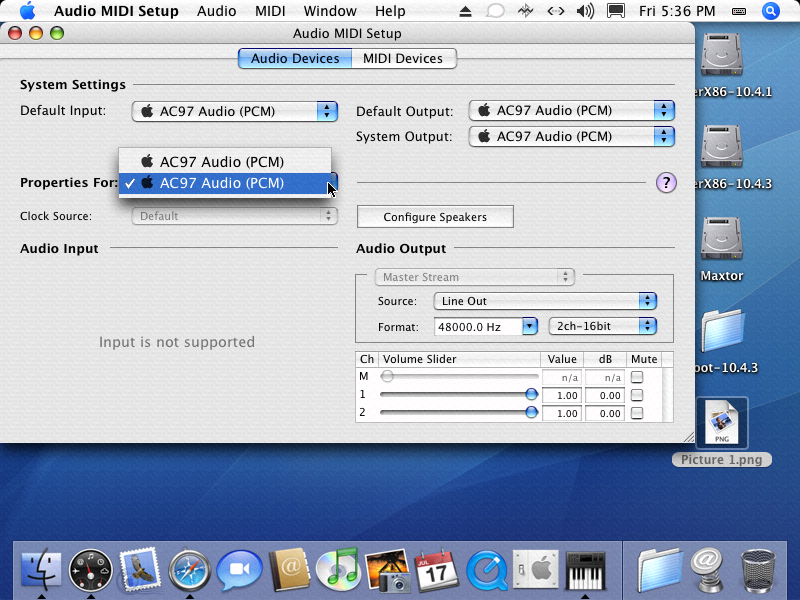

macgirl Posted December 2, 2005 Share Posted December 2, 2005 Hit the button on the "Properties For:" and select the other Ac97 Audio (PCM) an the output properties appear and input disappear Link to comment https://www.insanelymac.com/forum/topic/5150-audio-problems-fix-by-setting-the-proper-sound-channels/#findComment-33555 Share on other sites More sharing options...
pc_guru Posted December 2, 2005 Share Posted December 2, 2005 Hi macgirl, I did try it too, but when i get output properties, there i tried to set up my speakers hitting "Configure Speakers" button, then there i got only 2 options of channels in each speaker (channel 1 or 2), then if select channel 2 (to left or right speaker), the speaker don't play any sound (noise) and can't to set up the channel 1 for both speakers, beacuse OS doesn't allow me. Could to be this fixed ?, or is too much for to aks it ?. Thanks you for your support . Link to comment https://www.insanelymac.com/forum/topic/5150-audio-problems-fix-by-setting-the-proper-sound-channels/#findComment-33568 Share on other sites More sharing options...
macgirl Posted December 3, 2005 Share Posted December 3, 2005 Coud you change the amount of speakers? I have up to 6ch-16bit. Maybe the VIA audio is broke somehow. Link to comment https://www.insanelymac.com/forum/topic/5150-audio-problems-fix-by-setting-the-proper-sound-channels/#findComment-33575 Share on other sites More sharing options...
pc_guru Posted December 3, 2005 Share Posted December 3, 2005 I don't know, this works perfectly in Windows. How i change the amount of speakers ?. Link to comment https://www.insanelymac.com/forum/topic/5150-audio-problems-fix-by-setting-the-proper-sound-channels/#findComment-33590 Share on other sites More sharing options...

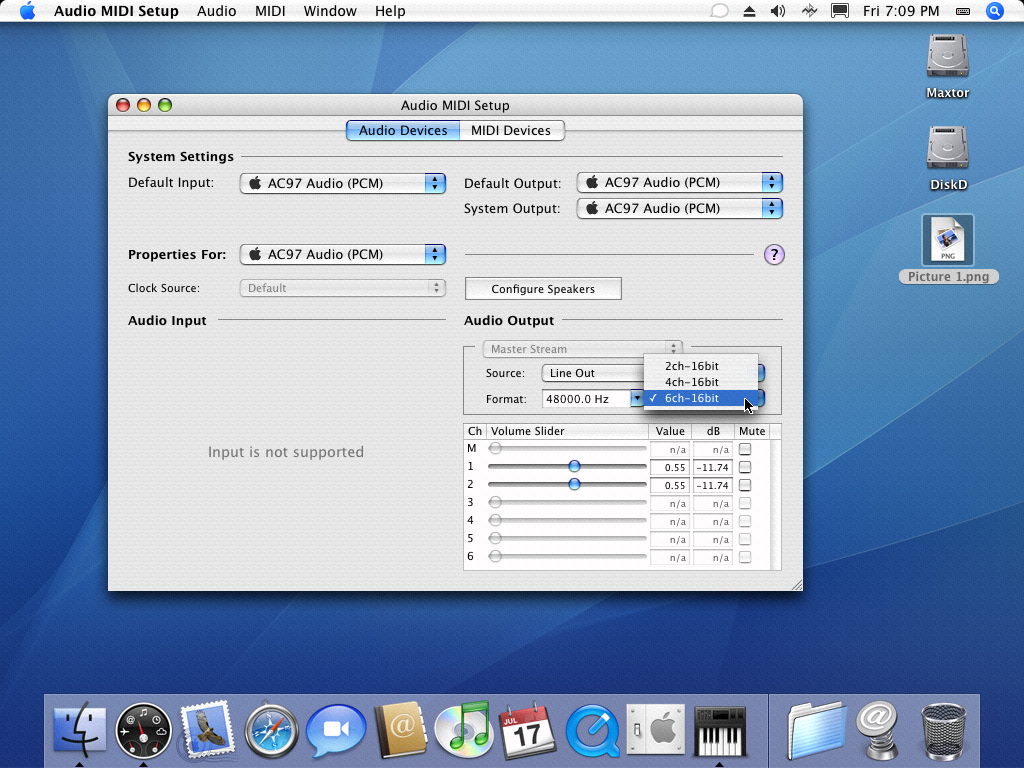

macgirl Posted December 3, 2005 Share Posted December 3, 2005 See the picture: Link to comment https://www.insanelymac.com/forum/topic/5150-audio-problems-fix-by-setting-the-proper-sound-channels/#findComment-33595 Share on other sites More sharing options...

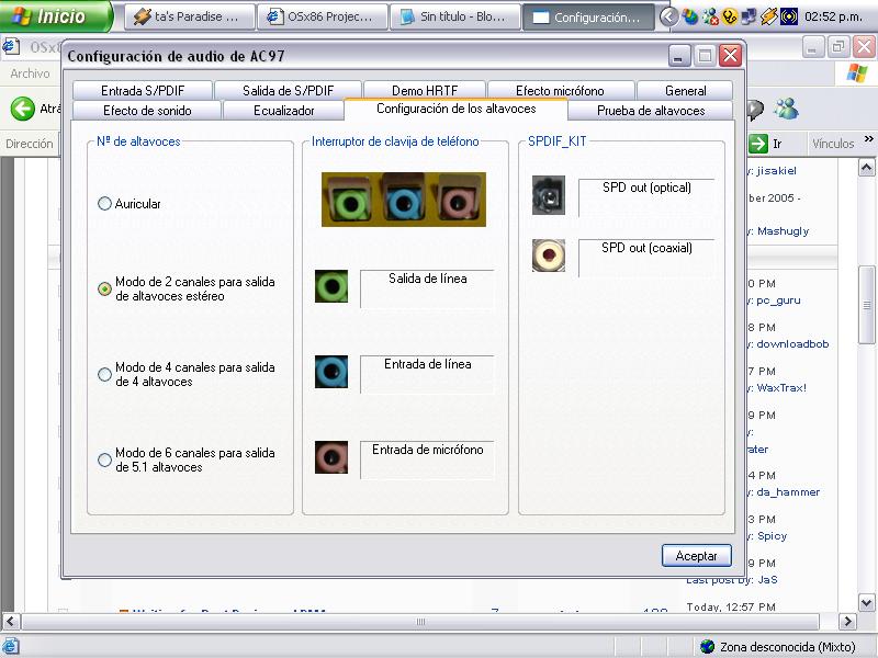

pc_guru Posted December 3, 2005 Share Posted December 3, 2005 I only have 2 channels availables, i did check in BIOS Setup, but i couldn't see any option about of Audio Channels, only enable/disable VIA Audio AC97. I think that it's a trouble with driver (kext), maybe this kext only works correctly in some AC97 models, but not in all them. Look at this screen cap. Anyway, thanks you for your efforts, are very appreciated. Link to comment https://www.insanelymac.com/forum/topic/5150-audio-problems-fix-by-setting-the-proper-sound-channels/#findComment-33601 Share on other sites More sharing options...

UncleP Posted December 5, 2005 Author Share Posted December 5, 2005 Sorry about the belated reply. Did you make sure that your card information is in that kext file. Most if not all AC97 cards have the six channels. So you should be able to select 6 channels on that drop down menu. Also check you bios settings for that card and if this is a dual boot with windows on it, make sure your speaker settings in windows is set for a 5.1 surround/multispeaker layout. This may be why you only see 2 channels. Try making those changes in windows if it is a dual boot machine and then boot back into OS X and see if you can select the proper channels. I worked on this problem with mine for a few hours before I figured this out. Good luck. OS X machine Dell Precision Workstation 370 audio AC97-working video-nvidia FX 5200 vesa ------> hoping for a good patch to get QE running Network card builtin- not working had to install a Intel Pro 100 card- working SATA-not working ATA-working DVD burner OEM from Dell working. Maxtor ATA 133 30gb Link to comment https://www.insanelymac.com/forum/topic/5150-audio-problems-fix-by-setting-the-proper-sound-channels/#findComment-34397 Share on other sites More sharing options...
pc_guru Posted December 5, 2005 Share Posted December 5, 2005 If you read my post, then you'll know that i did check my BIOS and there, there isn't nothing about of channels, only enable or disable the sound card. My audio driver in windows hasn't that surround/multispeaker option. Link to comment https://www.insanelymac.com/forum/topic/5150-audio-problems-fix-by-setting-the-proper-sound-channels/#findComment-34401 Share on other sites More sharing options...
UncleP Posted December 7, 2005 Author Share Posted December 7, 2005 Yeah I did read your post, I was just making a generic statement for others that do have audio channel settings in their BIOS. That is really strange that you do not have speaker layout settings for your card in the advanced audio properties. Most AC97 drivers have this. I am willing to bet that this is your problem, that the driver you are using is set to 2 channel and you cannot change it to 5.1 surround etc. I had to do this to mine to get it to work in OSX. There may be another driver/software package that will allow you to make these changes in windows. Perhaps seeing if there is a driver update from your board manufacturer. Because you can get one channel to work that tells me that the problem is the channel settings. Anyway good luck with it hopefully you can look further into the settings on the card in windows and discover where you can make these changes on the card/chipset. Oh I forgot to ask which exact Biostar board you are using. I could lookup the driver you are using and see if that feature is on your sound chip. Most of the Biostar P4 board specs are showing 6 channel AC 97 sound cards. Link to comment https://www.insanelymac.com/forum/topic/5150-audio-problems-fix-by-setting-the-proper-sound-channels/#findComment-34815 Share on other sites More sharing options...
pc_guru Posted December 7, 2005 Share Posted December 7, 2005 (edited) ...Oh I forgot to ask which exact Biostar board you are using. I could lookup the driver you are using and see if that feature is on your sound chip. Most of the Biostar P4 board specs are showing 6 channel AC 97 sound cards... I did search in others audio properties and found that option for 4/6 channels, but i only can to set in Win XP, because in osx86 don't exist this option. I think that the kext for AC97 isn't fixed for to work in all AC97 models, so this only will work fine in some models, but not in all. Here's attached an image of my audio card driver program (just look at post's bottom). Thanks you anyway, for your efforts. Edited December 7, 2005 by pc_guru Link to comment https://www.insanelymac.com/forum/topic/5150-audio-problems-fix-by-setting-the-proper-sound-channels/#findComment-34934 Share on other sites More sharing options...

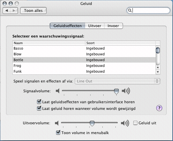

RoRoo Posted December 14, 2005 Share Posted December 14, 2005 I've got a strange problem OSX natively installed on a HP DX2000MT without problems. AC97 Soundcard is detected and installed. I can modify my volume settings.. But I can't hear any sound.. When I go to sound settings in the system settings i'm unable to playback a test sound..... I'm currently booted in windows so screenshots will come later on. All seems fine.. But I can't select the play audio through part :S This looks alright to me. Link to comment https://www.insanelymac.com/forum/topic/5150-audio-problems-fix-by-setting-the-proper-sound-channels/#findComment-36526 Share on other sites More sharing options...

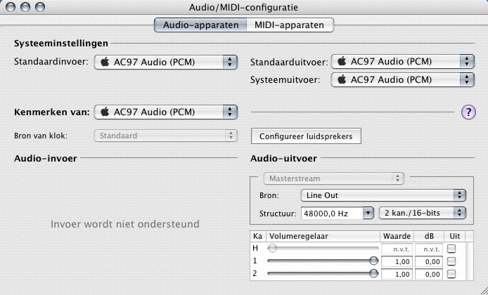

XanthraX Posted March 30, 2006 Share Posted March 30, 2006 I followed the instructions of UncleP and macgirl (God bless you forewer!). All good, but I lost all the system sound allerts (apllications sounds works - iTunes, etc.). Solution (for all of you can happened this): Open Disc Utility, select your MacHdd and repair permissions. Then restart and all will be OK. Thanks again for your hard work and for the patience in explanations. Link to comment https://www.insanelymac.com/forum/topic/5150-audio-problems-fix-by-setting-the-proper-sound-channels/#findComment-85572 Share on other sites More sharing options...
BebopBlues Posted April 1, 2006 Share Posted April 1, 2006 I lost all audio when I have my speakers plugged into Speaker Out of the sound card. But when I plugged it in the Line Out, I get audio, but of course I cant adjust the volume. I did the audo midi speaker thing from this the info on this thread and now I have system sounds though Speaker Out again. Except I get no audio from quicktime. Audio works in iTunes though, which is bizarre beacuser I tthought iTunes use QT to playback media. Audio works in VLC also. Audio does not work in Garage Band. Any clues anyone? Link to comment https://www.insanelymac.com/forum/topic/5150-audio-problems-fix-by-setting-the-proper-sound-channels/#findComment-86837 Share on other sites More sharing options...
