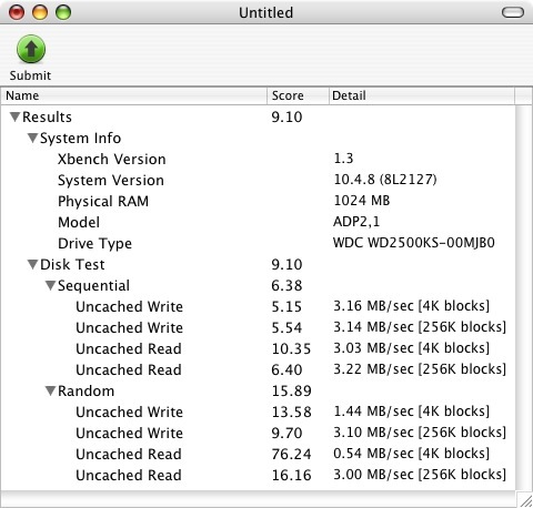

thy1225 Posted February 22, 2007 Share Posted February 22, 2007 How can it be so slow ???? only 1~3 MB/sec ??? My setup is Core 2 Duo 6300 MSI 965P motherboard WD sata 250G Seaget IDE 20G and here is my xbench score I tried the way in here "[HowTo] Speed up hard disk access " but nothing happen, if I replace "IOATAFamily.kext", then my system won't boot.... it's the last thing I need @@ anyone can help? any advice? thanks~ Link to comment https://www.insanelymac.com/forum/topic/43193-super-slow-disk-readwrite-speed/ Share on other sites More sharing options...

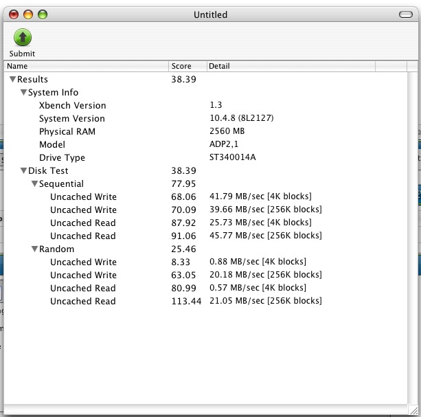

zu1u Posted February 23, 2007 Share Posted February 23, 2007 (edited) Seagate drives and OSX don't like each other. Drop in some other brand and you will instantly get better results. And you've reached that conclusion how? I've attached a screen shot of the xbench results i get with a seagate and osx And I do believe that the test thy ran was performed on a Western Digital disk as reported in the disk type field of xbench Edited February 23, 2007 by zu1u Link to comment https://www.insanelymac.com/forum/topic/43193-super-slow-disk-readwrite-speed/#findComment-309481 Share on other sites More sharing options...
