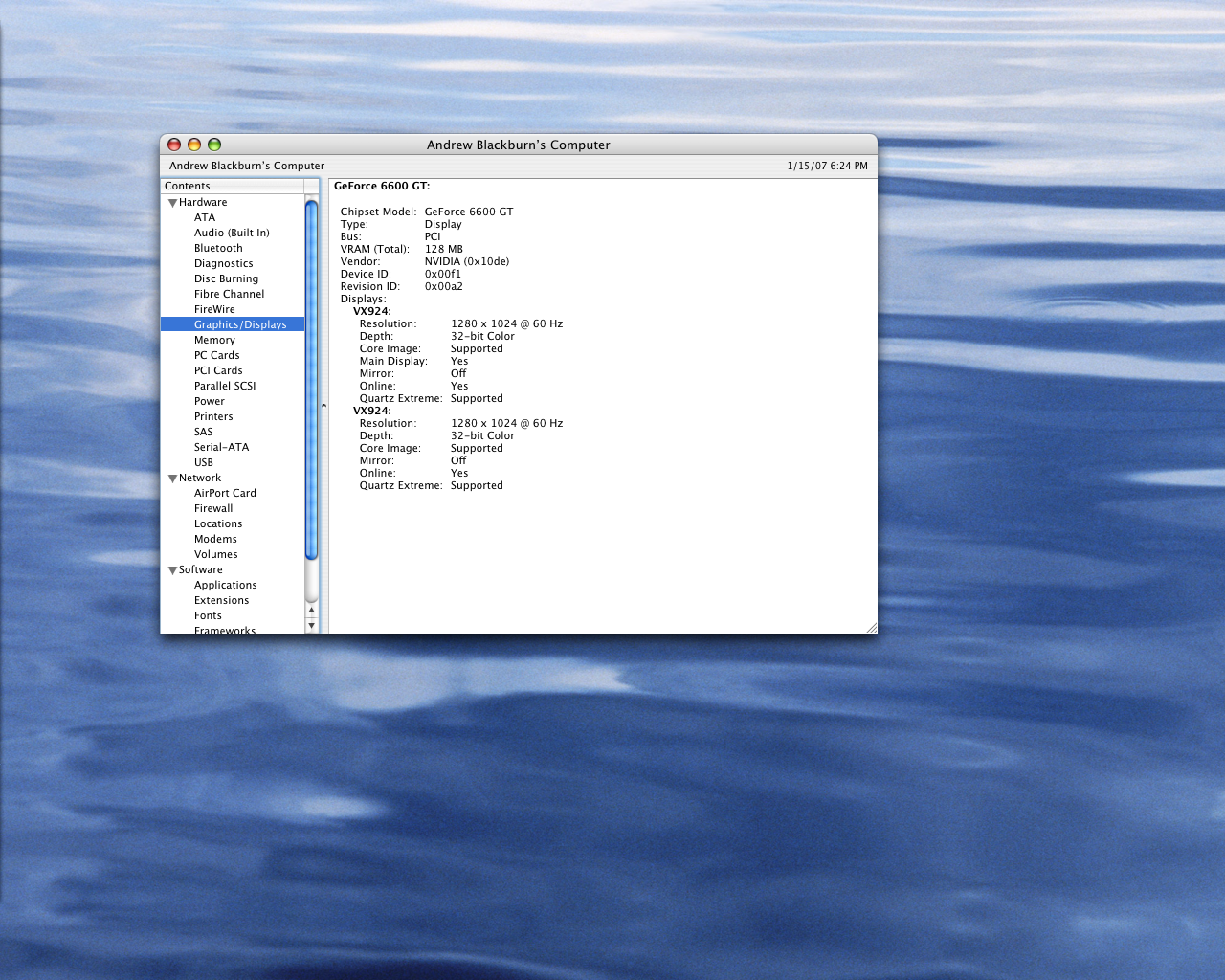

Blurn Posted January 15, 2007 Author Share Posted January 15, 2007 (edited) Just for the record, it seems like more people are having problems with AGP cards. I do not know if this is just because the cards happen to be older or if it is actually do the AGP interface, but looking over some np_'s posts (and he is a real expert) it seems that some AGP kext may be implicated here. @bofors and cbreaker, I have tried with a clean install. Bofors, I was able to get your v0.02 release working with one monitor with a DVI->VGA adapter. I have not tried it with AGPGART yet. I was correct with my theory on the DVI issue. Unfourtunately, I do not have another adapter to try the second monitor. Once I get my hands on another one I'll make sure that both monitors work and continue on with this endeavor to get Dual DVI working.. EDIT: I got both screens working. This is the layout of how I have everything hooked up. VIDEO ---> ||| DVI PRIMARY ----> ADPATER (DVI to VGA) ----> VX924 D-Sub CARD ---> ||| DVI SECONDARY ----> DVI CABLE ----> VX924 DVI-In Now I am going to try to get the primary interface working on DVI. I have yet to try the Bofor's Natit kext along side AGPGART. I'll post my findings and hopefully have a tutorial up on how to do it soon. Thanks to everyone who has gotten me this far! Check out my screen shots... Edited January 15, 2007 by blurn Link to comment https://www.insanelymac.com/forum/topic/38416-nvidia-6600gt-agp-dual-dvi-working-anyone/#findComment-276657 Share on other sites More sharing options...
