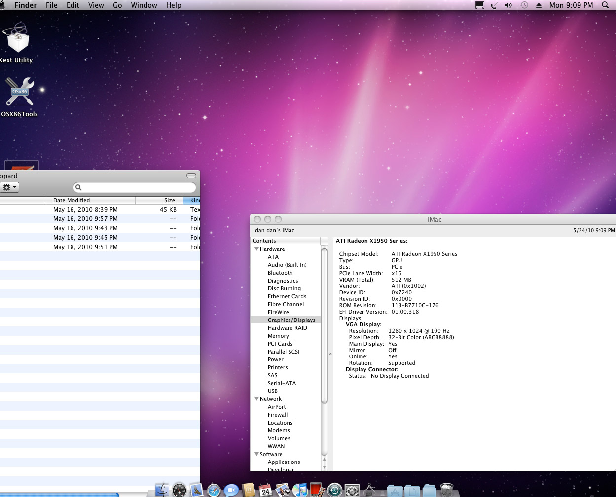

danzakk Posted May 25, 2010 Share Posted May 25, 2010 The videocard worked (Thanks for All), but the fan runs at high speeds Link to comment https://www.insanelymac.com/forum/topic/37175-how-to-get-the-sapphire-x1950xtid7244-and-x1900xt-id7249-to-work-not-the-pro-jccool-method/page/32/#findComment-1475262 Share on other sites More sharing options...
jaminmc Posted June 4, 2010 Share Posted June 4, 2010 The videocard worked (Thanks for All), but the fan runs at high speeds Should keep it nice and cool Link to comment https://www.insanelymac.com/forum/topic/37175-how-to-get-the-sapphire-x1950xtid7244-and-x1900xt-id7249-to-work-not-the-pro-jccool-method/page/32/#findComment-1482296 Share on other sites More sharing options...
